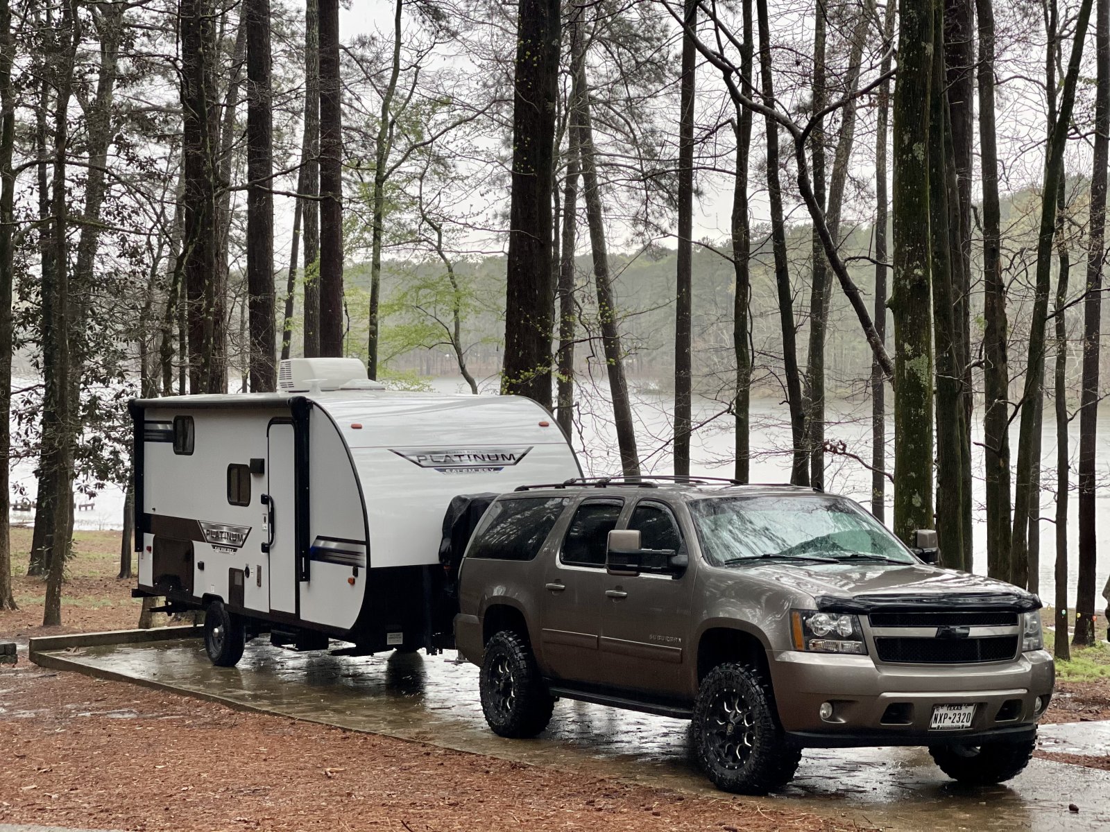

All the same, I’ll just add one more option for a WDH setup. I have the Camco Recurve R3 and love it for towing our 6500 lb camper. It was inexpensive, easy to install, has the sway control integrated into the ball mount so I can make tight turns and back it up without removing the sway control, and it does a great job of both distributing weight and controlling sway. Most of all, I like that the weight bars don’t hang down, but rather run alongside the a-frame arms, making for more ground clearance and a cleaner profile.
I installed it when we bought our latest camper. Did the ball mount and initial assembly at home, and then installed the bar mounts and bars at the dealer when I picked up the camper. Took me a weekend of making adjustments to get it set up just right, but now it’s perfect.
