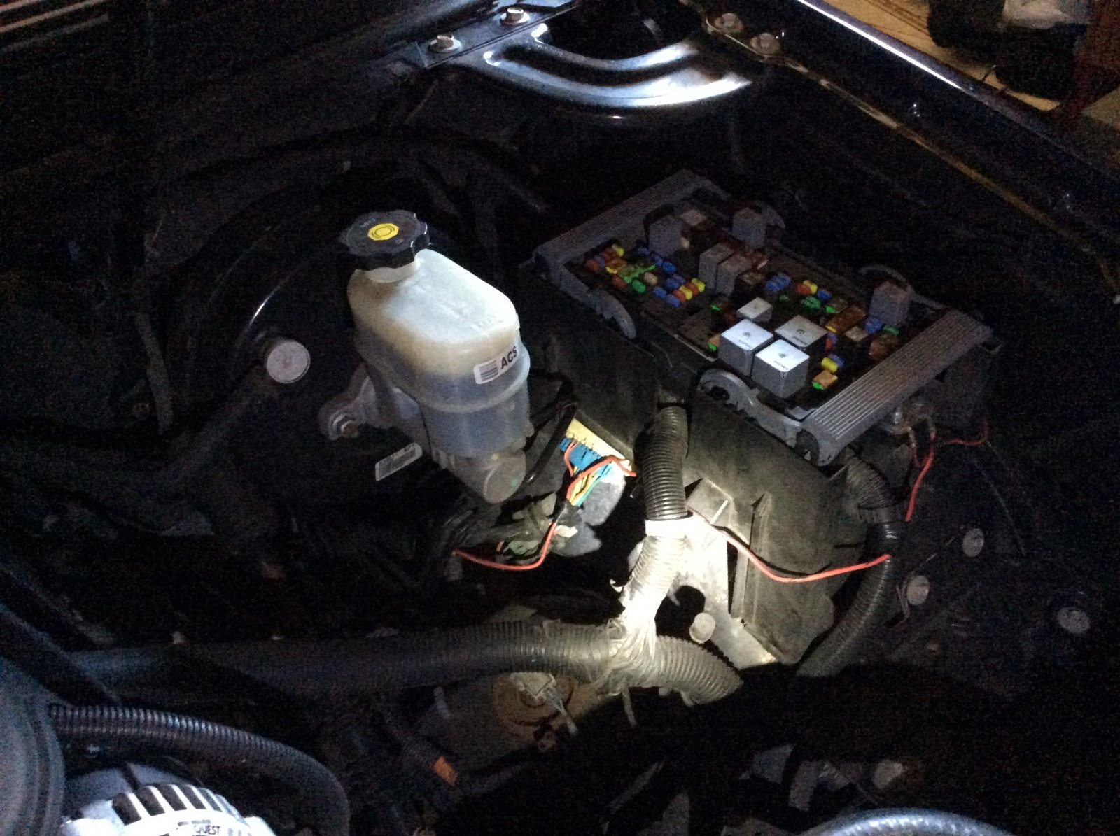

So you’re clear on connecting the hot wire under the hood to get power to the inside of your trailer? This connection is not to power the trailer running lights, but to power things inside your trailer and charge your auxiliary battery while you’re traveling. The wire is coiled up near all the wires by the brake cylinder, mine is red with a black stripe. It needs to be attached to the right side of two hot terminals at the front of the fuse box. The other terminal is for a brake controller connection. Just FYI

View attachment 276144 So you’re clear on connecting the hot wire under the hood to get power to the inside of your trailer? This connection is not to power the trailer running lights, but to power things inside your trailer and charge your auxiliary battery while you’re traveling. The wire is coiled up near all the wires by the brake cylinder, mine is red with a black stripe. It needs to be attached to the right side of two hot terminals at the front of the fuse box. The other terminal is for a brake controller connection. Just FYI
Thanks! Very Helpful. I may need a pro to help as I have a 2nd battery running a Dometic Refrigerator/Freezer in the back of the Yukon and I'd want to make sure I'm not messing with that at the same time. I appreciate the photo. Someone mentioned the trailer brake controller not being hooked up from the factory. I'm assuming that's what goes to the other terminal you mention.
The factory trailer brake controller is hooked up and ready to go. If the vehicle does not have JL1, there's a bundle of wires under the dash and the one between the fender and fuse box are all for an aftermarket controller.
