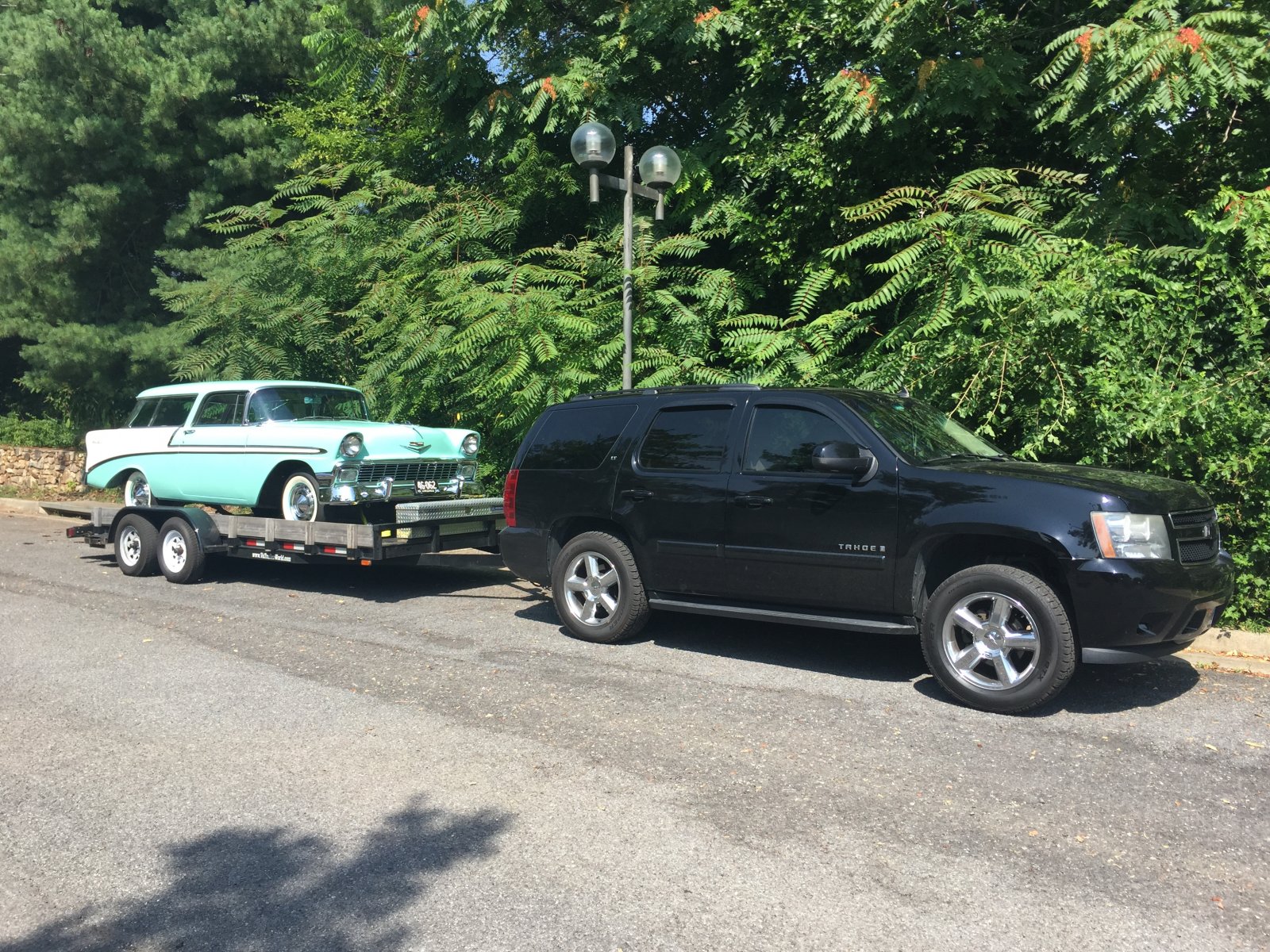

heres a pic of my 08 with 2" level and 33's (tow pakagage, 3.42s etc) and rear MOOG HD springs. no bags. only extra was a brake controller. flat gound was no issue. I hit some hills going through western VA and it did OK, a bit sketchy going uphill through the mountains. if you are running 35s i would think 3.73s are a must to keep the power to the ground.
