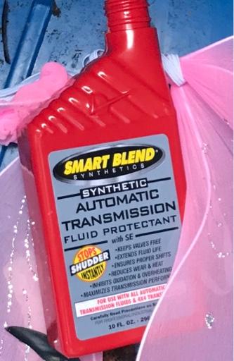

Lol, same here! Not an expert on transmissions either. I just know coasting up and into my driveway in neutral still resulted in a stall numerous times, then after pouring in that snake oil on the recommendation from my trans shop it magically stopped it from stalling. My rig would stall like clockwork after so many minutes of driving everyday and since that trip to the trans shop it has staled once.

I put that stuff in and mine hasn't stalled one time since I put it in. My fluid is not dark and is normal pinkish color and I know the filter hasn't been changed since I bought the truck. Possibly time for a new trans filter. But at 199k I am weary of a trans flush as I have heard that creates more problems. But so far that additive has helped. I was switching to tow haul mode as I slowed to a stop which kept me from stalling as well.

3) Add ATF modification, like vettes980 did, or use Lube Guard ATF Protectant

Torque converter stays locked up, either from a failing TC or the solenoids or the valve body controlling it. Try a bottle of this before you do anything. This is the cheapest thing you can do. And search this formum for my issue. I’ve documented my issues pretty extensively and I had the same symptoms. Including the crappy feeling you have right now with someone telling you have a failing trans.
