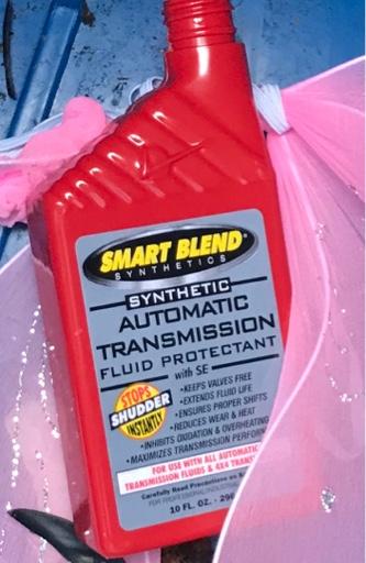

Torque converter stays locked up, either from a failing TC or the solenoids or the valve body controlling it. Try a bottle of this before you do anything. This is the cheapest thing you can do. And search this formum for my issue. I’ve documented my issues pretty extensively and I had the same symptoms. Including the crappy feeling you have right now with someone telling you have a failing trans.

lol thanks I will definitely look this up. is this stuff available in box stores like advance auto or online order

Agreed... I am really struggt with this because I still owe money on this thing and throwing more and more into it. I might do throttle position sensor and go from there. I ordered the transmission protectant mentioned earlier so I will put that in as well.
