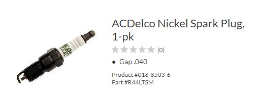

Others being Iridium or Platinum.
AC Delco R44LTSM is the old school stuff. Almost exactly what I run in my hot rod small block Chevy.
That said, while this plug IS available and spec'd for the 2003 Tahoe 5.3L (LM7) so too are the NGKs, ( It seems all of the relevant part numbers are now superceded by 41-110). There are also offerings from Bosch, Denso, et al.
The question here is, other than the longevity that the platinum or iridium provide, what's the difference? I fully expect that this particular engine won't see another 50 thousand miles. I'm chasing a random misfire and I suspect the current plugs have been in there twice as long as they should have been. The far less expensive nickle plug (at about a 70% discount) seems a fair choice if that longevity isn't taken into account.
Thoughts?

I think this supplier is using the word nickle even though it is a conventional copper plug (which would be nickle plated copper). Funny, back in the day we never distinguished plugs other than brand (and spec).
And the longevity thing is the deal breaker here. 20k might be beyond the lifespan of this heap. At least in my hands anyway.
