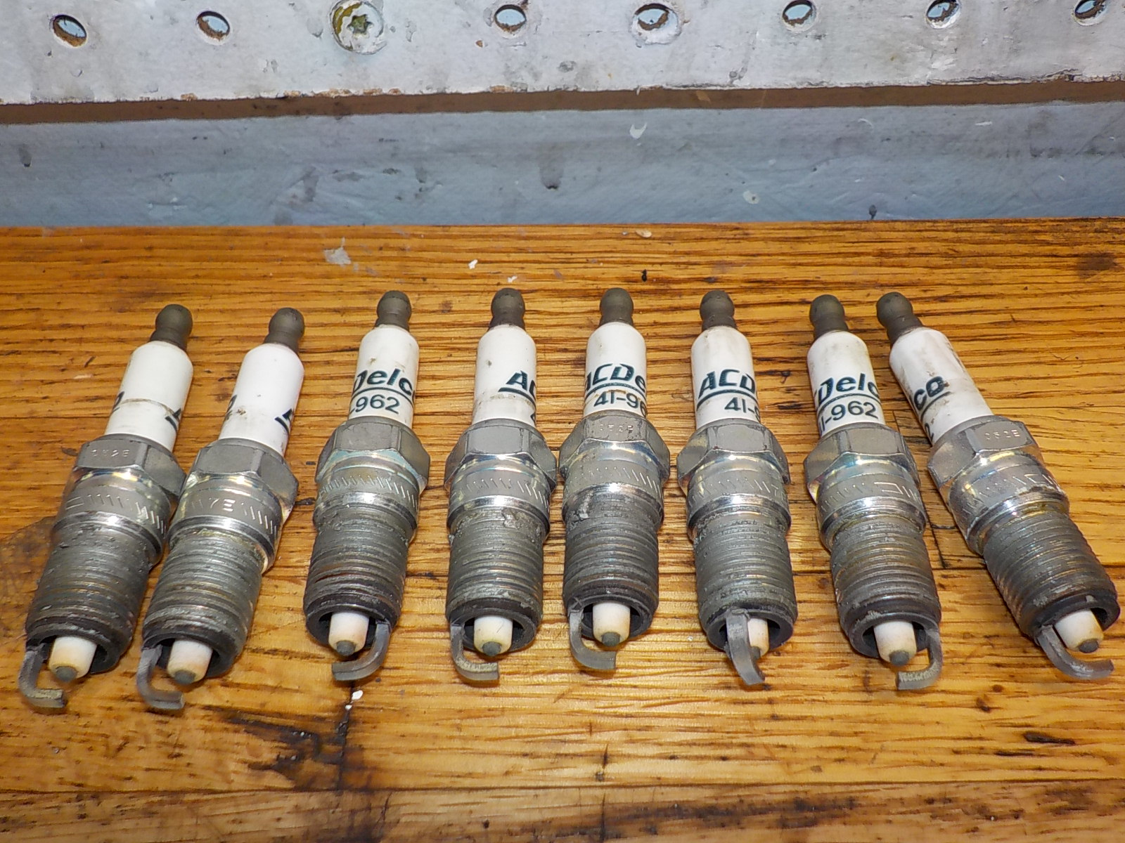

5+ years ago I bought a set of AC Delco #41-962 spark plugs from amazon. 2.5 yrs and 22k miles ago I installed them gapped at .040".
Recently, I've been getting a P0300 code and the engine has had a misfire at idle. It runs great otherwise.
It doesn't set a CEL. I go look for codes with my scanner because of the rough idle. and a 2k+ mile trip we are doing in it soon.
I pulled a plug and its gap was .065". I pulled the rest of the plugs and they were all .065". All the electrodes had worn badly. These plugs have only 22K miles on them. Must be counterfeits.
I went to NAPA and bought 8 new NGK Iridium IX # 7397 ($70), and new wires ($65), installed everything and its purring like a kitten again.

Sucks. If Amazon doesn't fix their supply chain for auto parts authenticity, people will stop taking the risk. I have 45K on the Iridium plugs I installed in our '07, purchased at Rock Auto. They're still doing great. I wouldn't buy a hubcap from Amazon.

yeah those spark plugs are fake even the printing on them doesn't look right look at the D then look at the D here

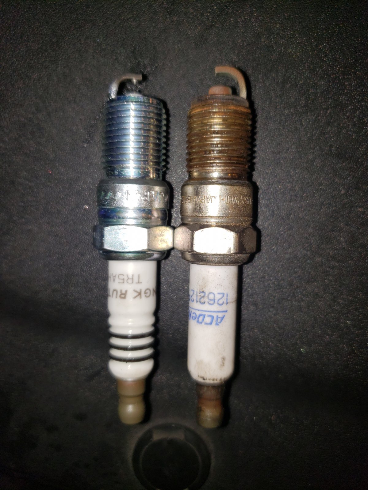

Had the same issue....
I think mine were from Ebay but can't remember for sure.
I replaced them with Ruthenium plugs from Rockauto.
For the record, no my Burb isn't some special edition concept engine that takes 12 plugs (although that would be pretty cool) the other plugs are for my Honda.
Not sure how long the Ruthenium plugs will last but they are supposed to be even better than the Iridiums so only time will tell.
