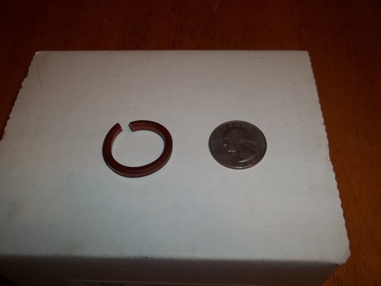

I convinced the fixit guy to check/change the oil pump pickup tube O-Ring, based on many posts here that said "Changing O-Ring fixed my low oil pressure)...if it looked ok, then we'd go with a Jasper 3 yr/100K mi - warranted rebuilt ($7700).
The O-Ring (picture included) did indeed have a split in it.
Now, instead of warm idle being around 5 or on the low red mark, it's around 12-15. Should be higher, but that'll keep the engine from quitting, and that fix, with ~$100 labor investigating, plus $600 for changing O-Ring, beats $7700.

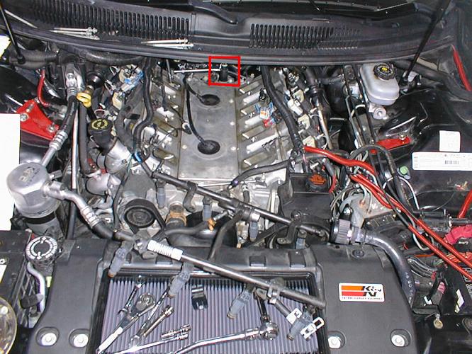

Where is this sensor located ?
Top of the engine, at the back, behind the intake manifold. It's a pain (literally) to reach, but can be done without removing the IM. If you've never cleaned and sealed the knock sensors (assuming that's your rig in your avatar), you may wanna remove your manifold to do this and check and/or replace the oil pressure sensor and/or screen while you're at it.
Here's a pic of an LS engine in an F-body, but that's irrelevant. The intake manifold is removed and you can see the oil pressure sensor in the red square. The knock sensors are just in front of that in the valley cover under the two black circles with the wires going to them.
