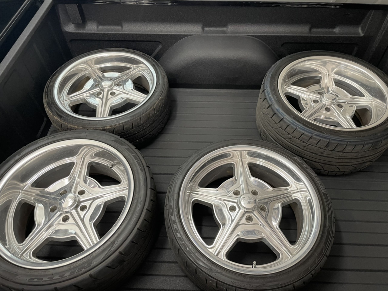

22x10 with 285/30r22 and 20x8.5 with 245/35r20
A buddy of mine has a 93 Silverado with a 4/6 drop and is fixing to order wheels. Do you remember what backspacing you went with cause I know that is very important on these trucks?
I can check, but it wasn’t the standard backspace used. I had these wheels designed around the brakes for clearance and the ability to keep the wheel as flush to the fender and maintain clearance.

Looks like 6” BS in front wheel and 6.25” in rear. Not sure if they shaved the back pad down to where it would clear the caliper by a fraction or not. I just know I asked for the biggest rear lip I could fit given the suspension setup and brake caliper size.
