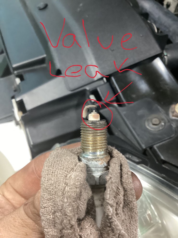

Here's an update. I took the truck to a shop to evacuate and refill the AC system with UV dye since I have a slight leak. I had the mechanic check for a shudder and he found some intermittent engine misfires reading live data but no codes. My plugs are Delco Iridium with 75k miles which in the past hasn't been an issue. I change them every 100k. He pulled the cylinder 3 plug and noted signs of a potential valve seat leak. Here's a pic from the diagnostic report.
I'll swap all the plugs tomorrow and inspect them since it's an easy first step. Has anyone familiar with valve seat leaks seen similar signs on the plugs?

Is that gap huge, or just an iridium thing?
I've never seen the justification for iridium plugs, except for longer change intervals. Fresh OEM standard plugs are the best, IMO.
