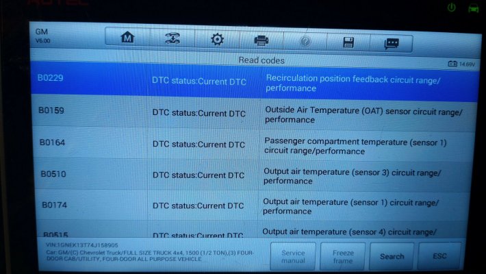

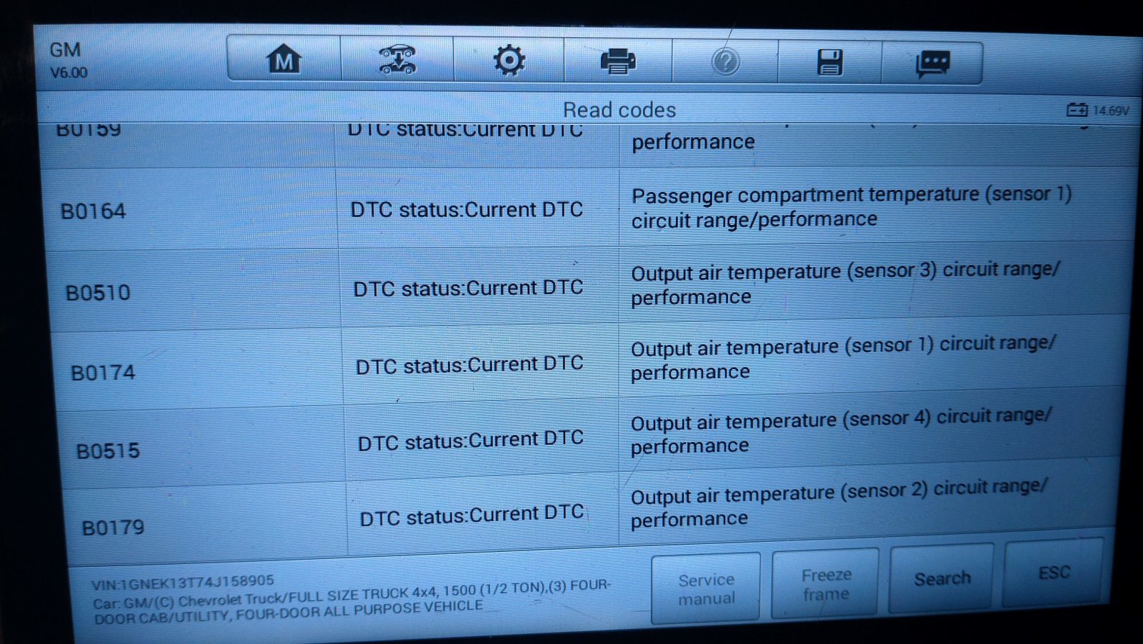

I replaced the climate control module because some of the lights were gone. Now I can`t get the blower motor to work. I have programmed the new module. (Putting it in auto, ignition off, pulling fuse, starting car, turning off and on ignition in all the right steps). i tried installing the old control module. I have checked the blower motor and it starts when I give it power. I Replaced the blower motor resistor as I thought it was broken since it gets power and the blower motor does not. Still doesn`t work. Noticed today it had all these fault codes listed in the pictures. Any idea what it could be? I bought this car one year ago and haven't driven it since i bought it, so not 100% certain that the blower motor was blowing air before replacing the control module.

Is the HVAC head intentionally set to Celsius? Are the HVAC fuses good? If you have rear heat there will be two in the underhood electrical center. There is also one in the instrument panel fuse block (in the cab).

I found the problem... There was an extra socket behind the new module covered by tape.... Somehow I did not see it. I noticed the old module had it. But somehow I put the connector into the harness for the double din radio, so I thougt there was not supposed to be a connector to it....
