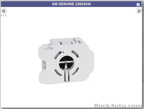

If you have that tweeter-looking thing on the headliner driver's side, check that out. I replaced that on my 06 because the temperature range didn't really work. That thing is like an ambient temperature sensor and has a little blower wheel: my wheel was seized. I posted the part number once upon a time on a different thread.
@Fless do you remember what that's called? If anything, you can remove, inspect and add a drop of oil to the part maybe?
Cabin air temp sensor:
