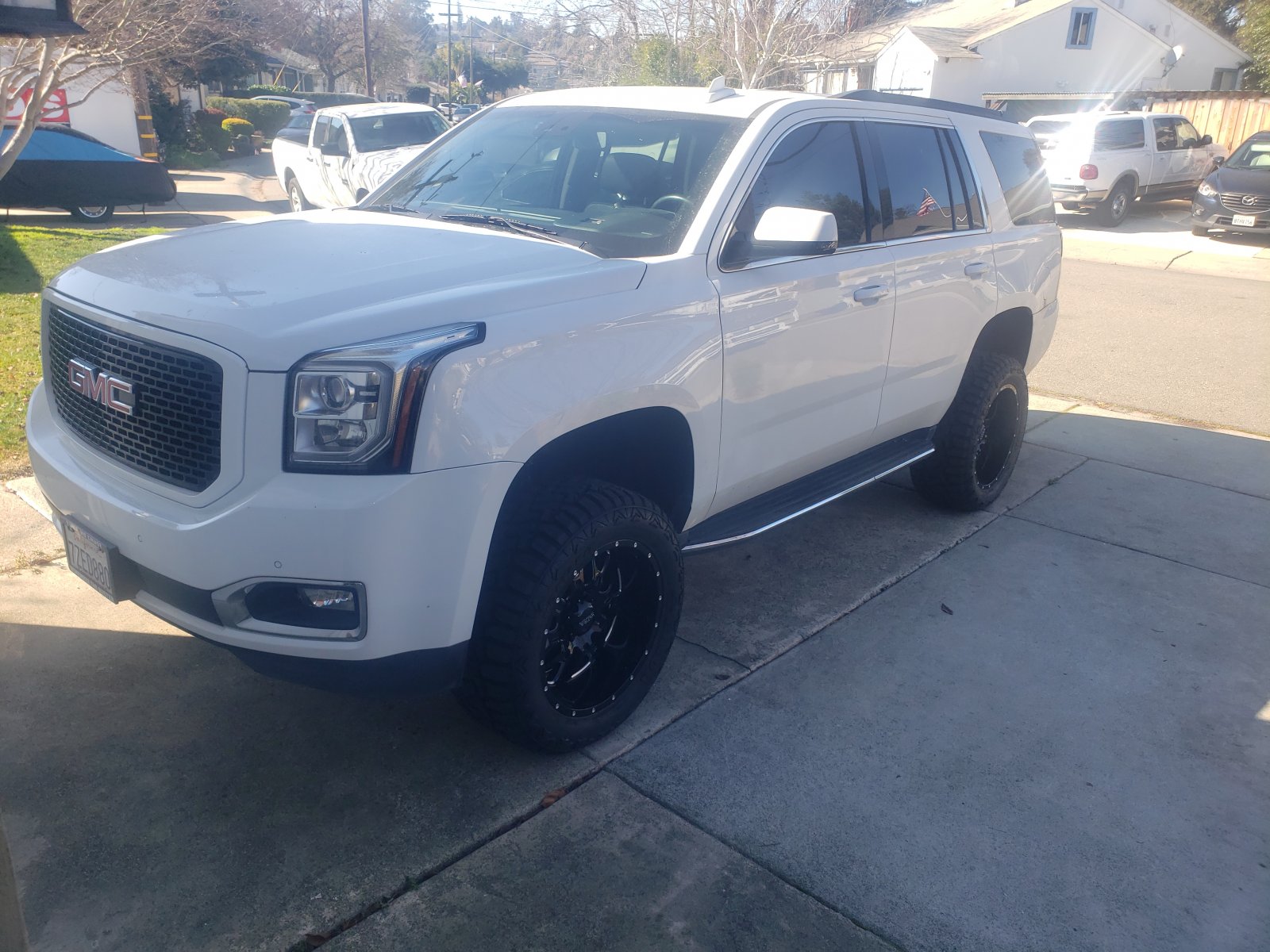

Just finished this weekend.
3.5" front spacer with cognito upper control arms/kryptonite tie rods/Movotech lower TTX with Blistien 4600 shocks/struts F + R and +3" rear spacer/extended sway bar links (sits actually pretty level) and angle are good (no CVS)
Rims are 20x10 ultra hunter with 4.5 backspacing and 33x12.50r20 tires.
Slight rub on full lock/driveway (bump) but normal driving no rubbing. Drives really nice and solid feeling.

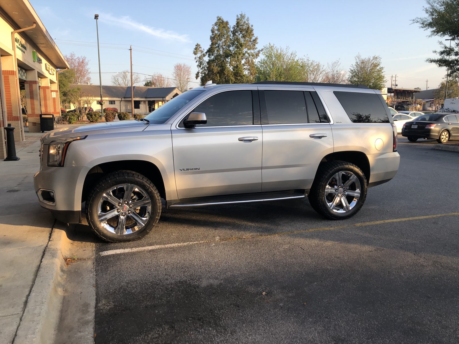

Took the 20’s off and threw on 22’s with 285/50/22 Nitto G2’s.

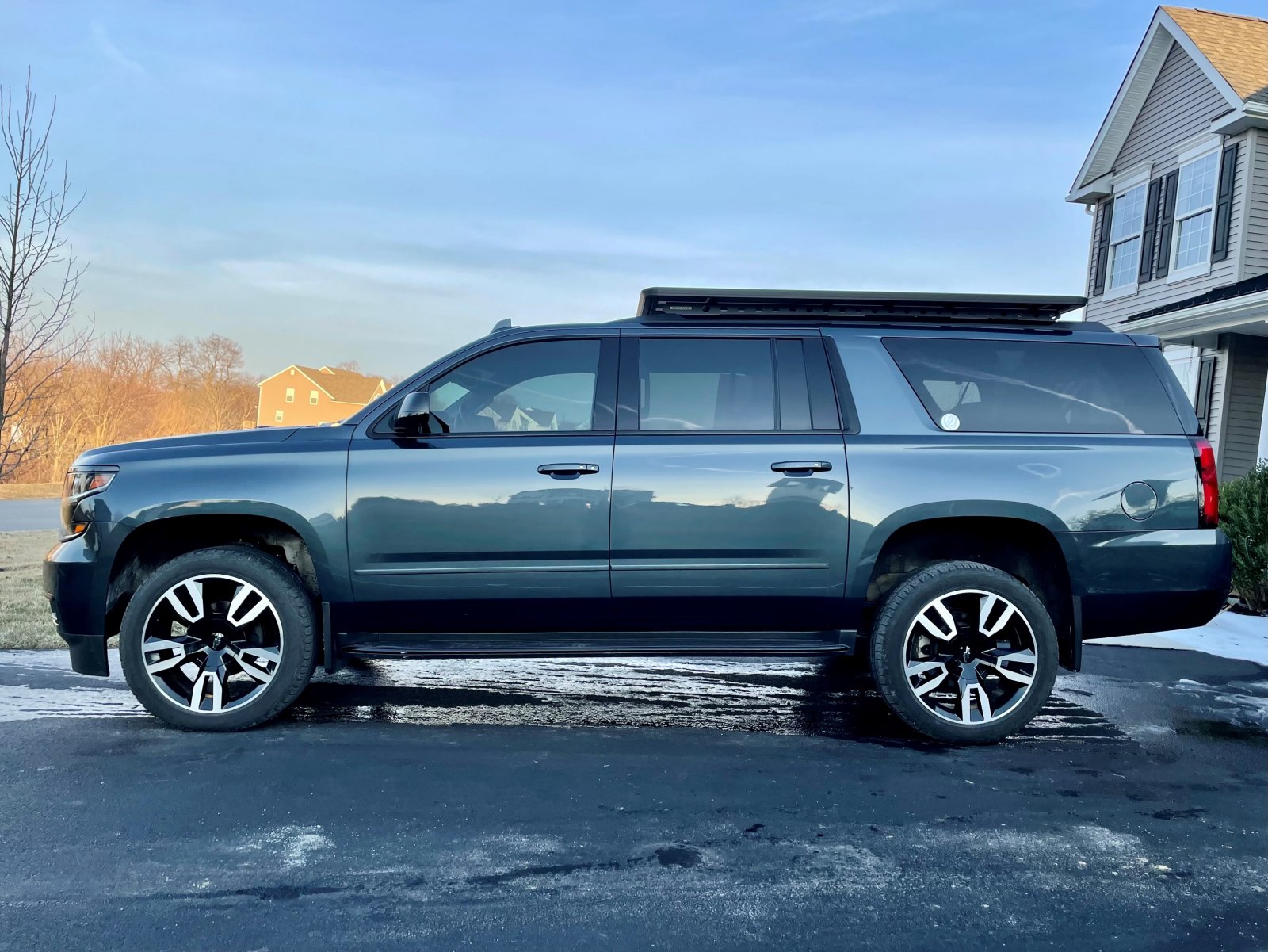

Nov 25, 2021
After several months of looking at pictures and going back and forth on what level kit to install on my Wife's 2020 Suburban Premier RST, I've decided to go with the Suspension Maxx 2.5/1.5" level with the rear 1.5" shock extensions. I'm quite pleased with the results!
olyelr
Mar 19, 2011
1,896
973
Elk Rapids, MI
Nice rig!
Vego99
Nov 25, 2021
Beautiful color. Did you go all 2.5 up front? In the photo, the rear looks a bit higher. Mag suspension?
Thanks! Yes went up a full 2.5" and it has magride. The ground is not completely flat so its kind of hard to see. With the 1.5" in the rear its slightly higher but with the long wheel base looks better than just using the 1"
I've seen pictures of the 1" combo on the LWB and it looks the opposite. I even spoke to Suspension Maxx about which one to do and they also just did a 2020 RST with a 1" rear spacer and the customer went back and had it swapped for the 1.5"
