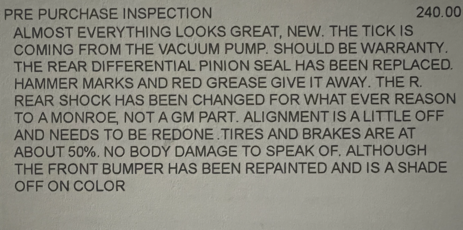

I purchased a used 2020 Yukon SLT with 24k mi. at Carmax for $54k. We flew across the country to pick it up and drove it back home where I could take it to a trusted mechanic to do an inspection. The B2B warranty expired in July but there's almost 2 years and 34k mi left on the powertrain. I declined the extended warranty. These are the results, and I have until tomorrow to return the truck for a full refund as part of a 7-day money-back guarantee... it would've been 30 days if I purchased it at a local Carmax.
These are the results of the inspection:
"Almost everything looks great/new. The tick is coming from the vacuum pump. Should be warranty. (they assumed it was still under the 3/36). The rear differential pinion seal has been replaced. Hammer marks and red grease give it away. The R rear shock has been changed for whatever reason to a Monroe, not a GM part. Alignment is a little off and needs to be redone. Tires and brakes are at bout 50%. No body damage to speak of. Although the front bumper has been repainted and is a shade off on color."
I paid for a CarFax report after getting this report back to see if the service records indicated the diff pinion seal was done at a dealer under warranty. It wasn't listed. I know for sure no dealer would slap a single Monroe strut on the rear. As far as I can tell the vacuum pump isn't covered under the 5/60 powertrain. I guess my question is to get opinions on WWYD? Deal breaker or no?
I already feel like we overpaid for the truck, but the market has been brutal. I know used cars won't be perfect and that I can pick up a vacuum pump for around $150 and a matching set of struts for a few hundred but my wife is screaming no, you shouldn't have to work on a truck we just bought that supposedly passed a 125-point inspection lol. She wants to return it. I'm also kinda curious as to why the pinion seal would've needed to be replaced with such low mileage other than crap luck, and assuming it wasn't done as a warranty repair, why?
I'd appreciate any thoughts.

I’d investigate the bumper paint issue. Have a body shop confirm it’s been painted. Like the rear shock there’s no reason to repaint a fairly new rig and rock chip repair wouldn’t need that much paint.

I'd probably be on the road taking it back too. Too much money invested to wind up with such a questionable vehicle. Also I'd just hate to think about buying any used vehicle that's clear across the country.

Think about it this way, I don't know how far you had to drive across country to get it but the vacuum pump cost 150 bucks a factory shock probably another 50 bucks by the time you spend money in gas and a plane ticket home it will cost you way more money to return it then to just fix whats wrong.

You got the 125 point FREE inspection.. If you want the 150 point inspection; for the low low price of $29.99, they open their normally closed eyes and check the shocks and tire pressure. lol
Seriously though. None of what you describe would be a show stopper to me. Those pumps make noise.

yep a little vacuuum pump tick is 100% normal, if it is bothersome replace it, it will still tick...... ,more or less

If the inspection was done a dealer, they can’t upsell warranty work on a free inspection, it’s against GM policy. But they can if a customer pays for an inspection. You can go in right before your warranty expires and pay for an inspection and anything they find is fair game.

I mean, if your wife doesn't approve that's one thing; and I get it, now might be the time to return it before it's too late. But returning it because of a mismatched shock? I'd just say you don't like it.
Did you do more than 1500 miles??? Across the country is more like 2400 miles.. And you have to bring it back to the place you bought it.. so I think you're stuck with it. (I had no idea they did 30 day returns)

100% return it. $54k is WAY too much for a 4 year old vehicle in my book. The mechanical inspection sounds like the guy is a good, thorough person. The report tells me that maintenance wasn't an objective of the original owner, and bandaid's as a reaction (cheapest option) were their solution on a new $70k vehicle.
Prices are coming down, so I'd find something local that was better cared for.
