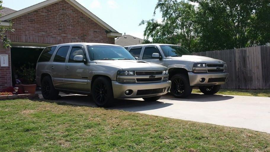

Z-56 Hoe
What do I do????
Jan 18, 2010
2,573
164
Houston
View attachment 26678 wife's 2002 with pro comps 2" keys and shock extenders. Next to my 2001 with a 2/3" spindle drop. Both have 275X55R20's image.jpg
