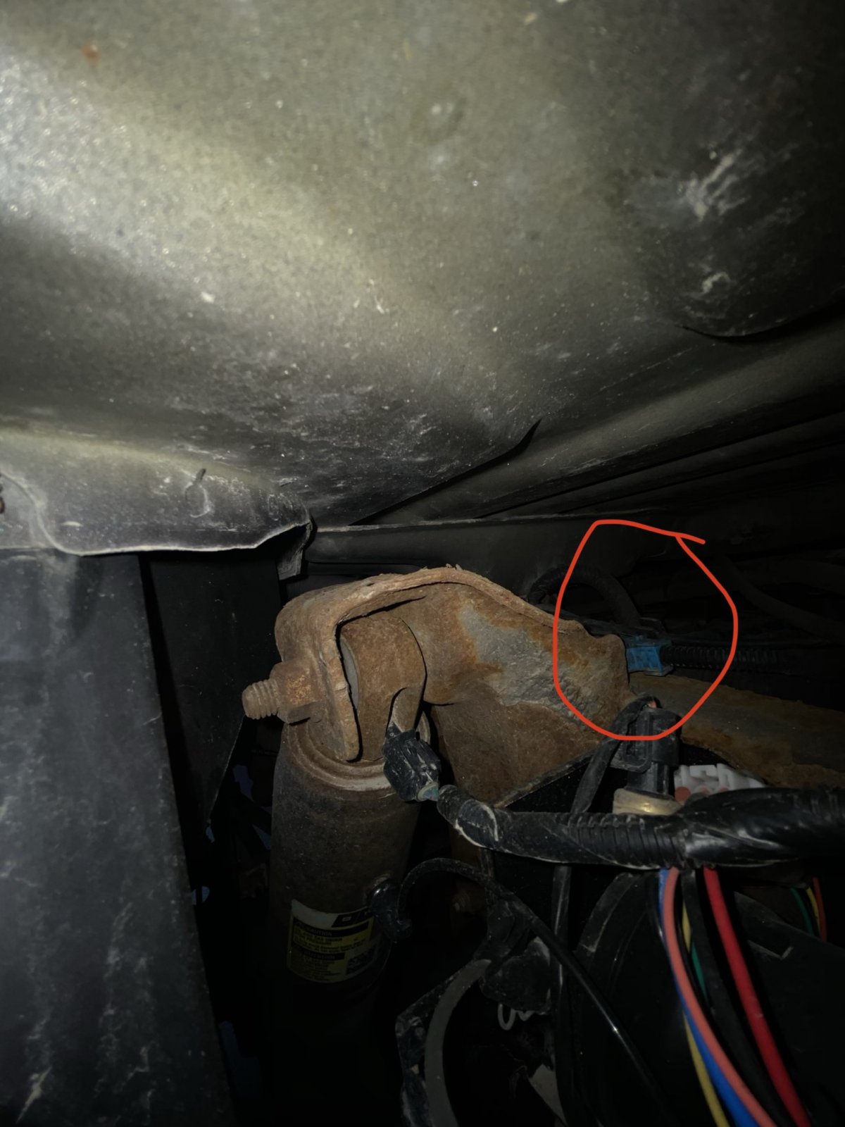

There is a harness connection on top of the frame rail almost directly in line with the upper bolt for the driver side. I circled it in red.

I’m under the truck now...can’t seem to get to it.

You guys were spot on. I had to take the fender liner off but I can see it was clearly disconnected.
Glad to help. This is so common that Arnott puts a note in with their shocks for these trucks telling you to check this when you are done installing.
