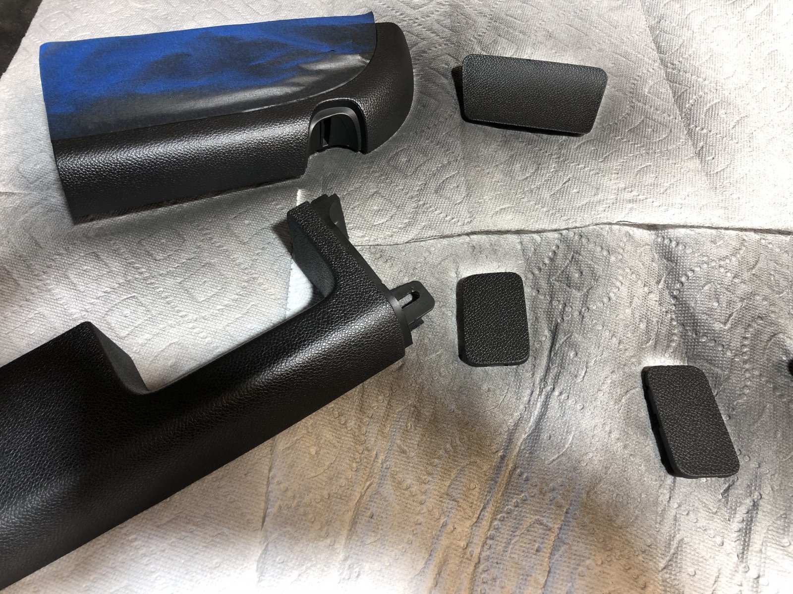

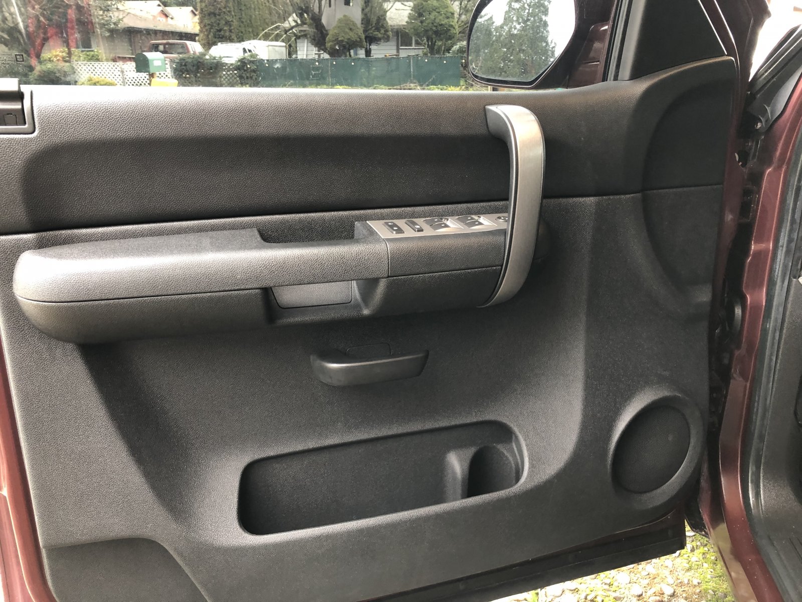

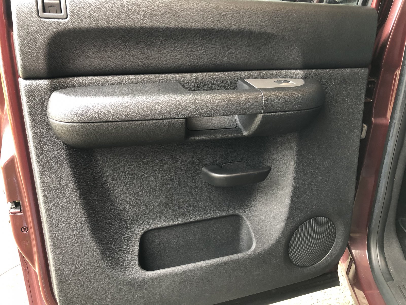

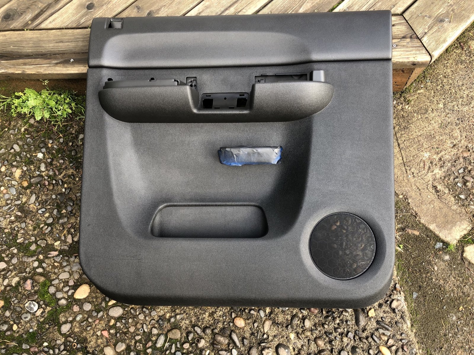

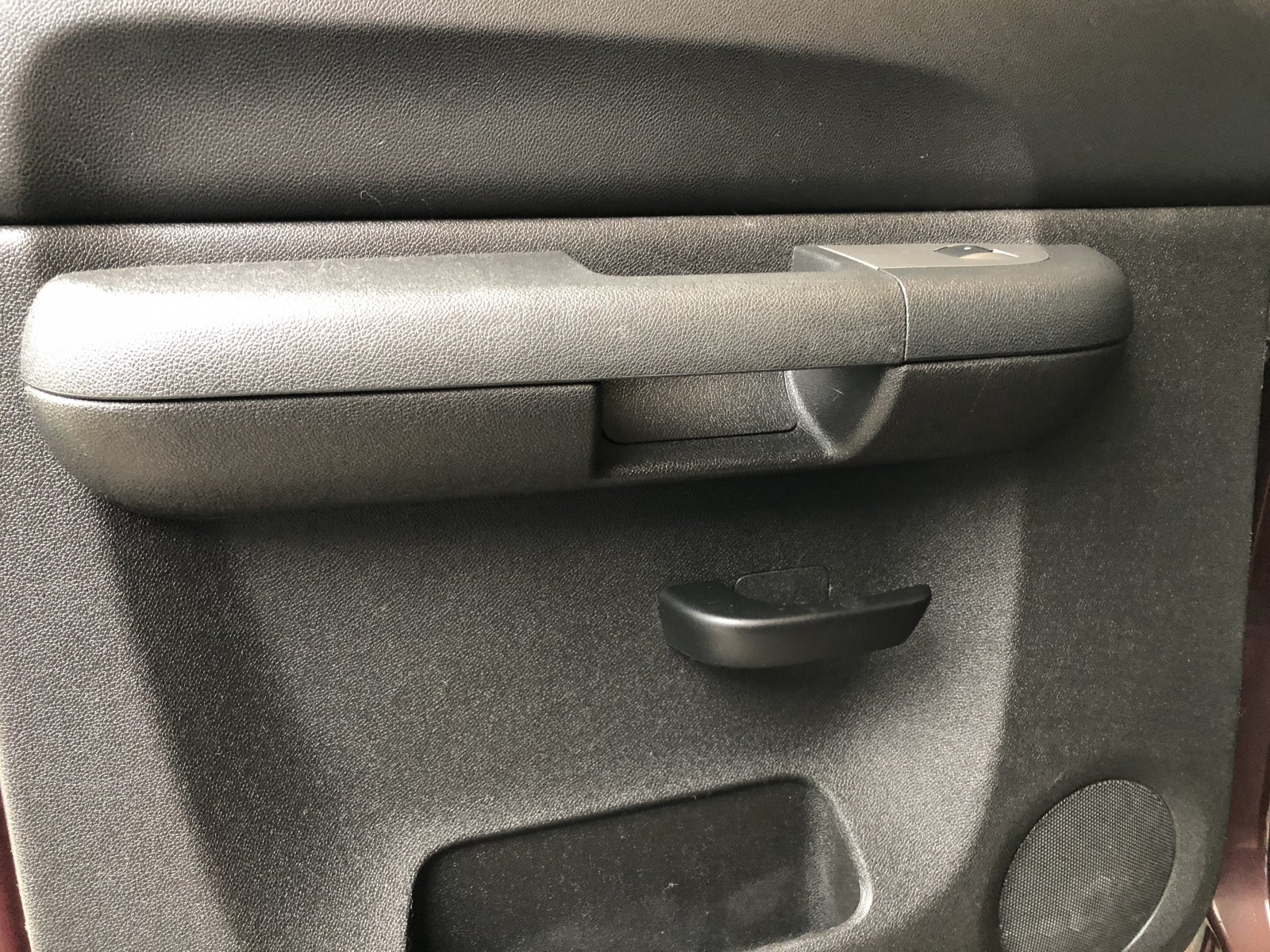

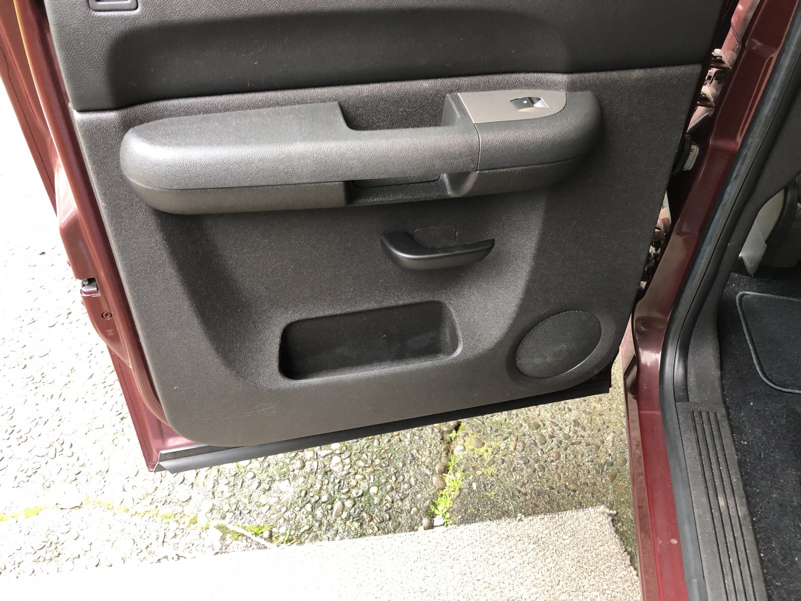

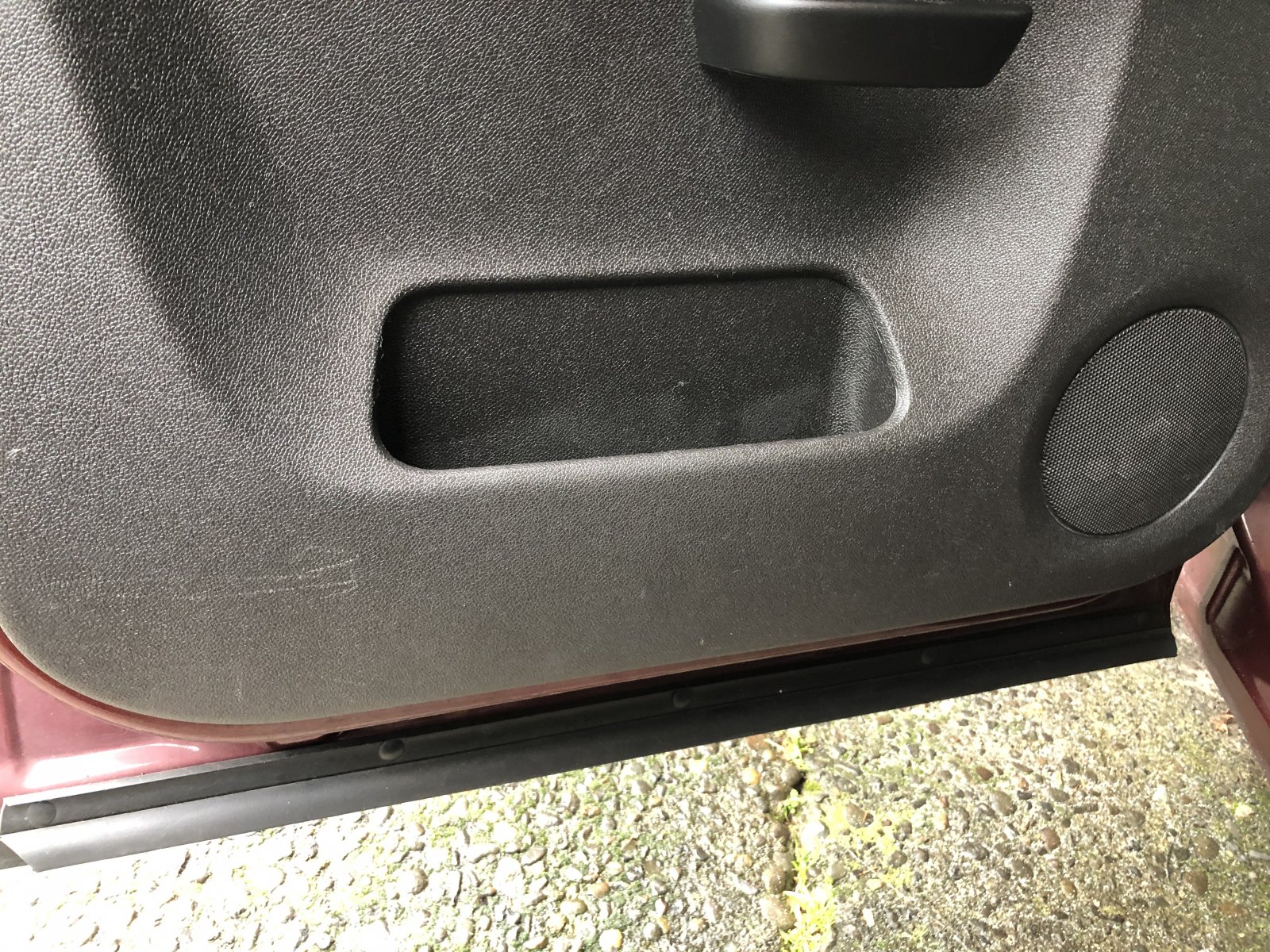

I pulled the driver side door panels to paint the armrests and switch housings. I decided this is the last time I’m pulling them off so if there’s anything else I see they needed, nows the time. I took a good look at them and saw a few areas where they were scratched or discolored. There wasn’t much I could do for the scratches except cover them as much as possible and a coat of paint should help and it will cover the discoloring. So that included the screw cover pieces. I was going to mask the top part and leave it but nothing would stick to it unless I scrubbed it with denatured and scotchbrite which left them grayish so I painted the whole damn panel. I have 100% faith in the Fusion. I have used it for years now on interior and exterior and never had it fail.

For light scratches on plastic, I use a heat gun. Works great, especially on those little plastic "hairs". Heat it only for a few seconds tho.

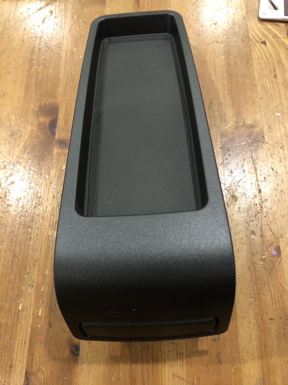

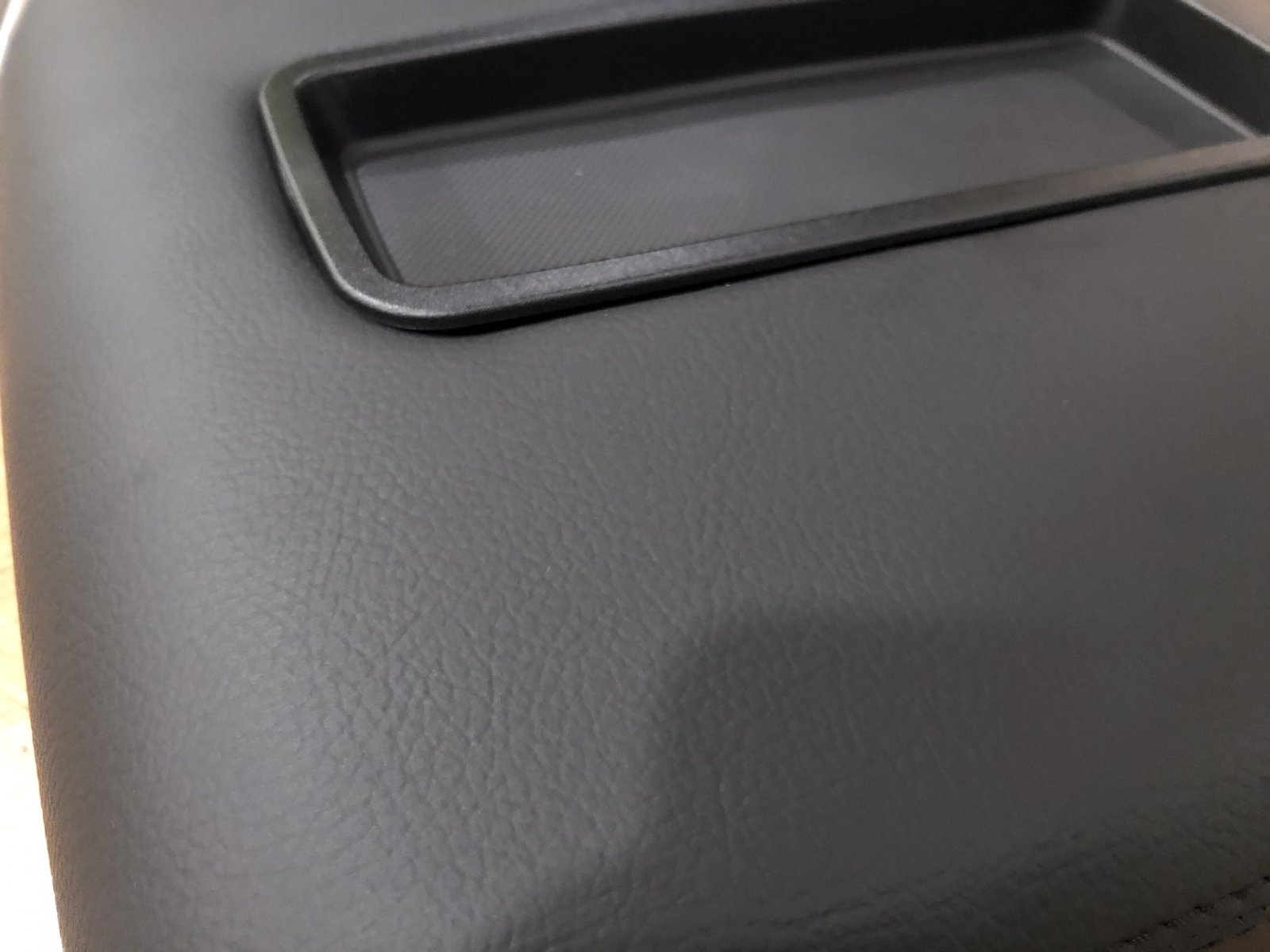

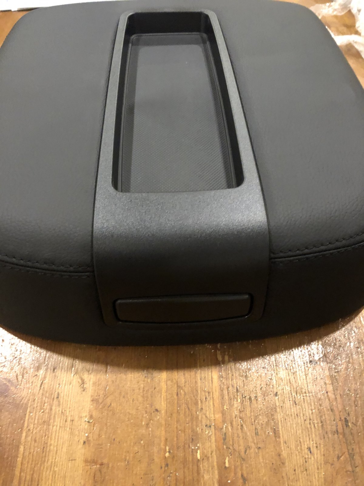

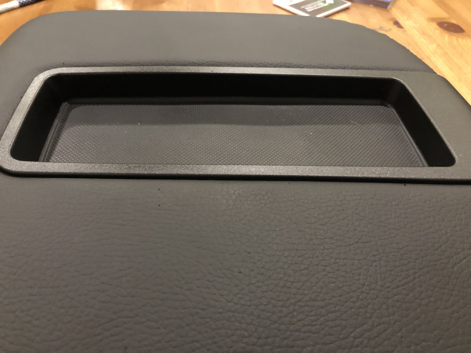

I got the new console latch tonight. The reviews said the screw holes didn’t line up so I was planning on swapping the actual hook part with my broken one and returning it but the holes lined up. But it wouldn’t tighten down and left a gap around the upholstery. So I cut about 1/8” off the bosses on the lid and that worked. The first 2 pics are before the mod. Sure wish I would have noticed the latch was broken before I bought the rubber insert because this came with one. And I was stupid enough to pay $20 for that OEM rubber piece. I’ll post it for sale in the classifieds but it will cost $8 to ship it usps.
