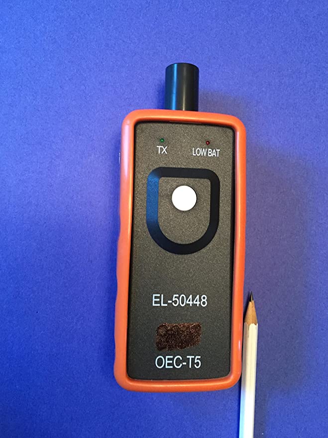

Upon closer inspection, the headlights are definitely not hazy, just have the diffuser lenses. I never heard of that before. Oh well. On another note, I decided to use the new TPMS sensors I bought for the new wheels I have waiting to go on the Silverado in order to get the message on the Tahoe's DIC to go away. (Just temporary until I need them for the new wheels, at which time I plan on pulling the old ones out of the old wheels and swapping them.) I hate warning messages. So I built a pipe bomb out of PVC pipe and put them inside and pressurized it. I tried to get them to get recognized by the Tahoe but increasing/decreasing the pressure didn't do it. I looked online, wondering if they needed to be activated, and found out they are stored in "off" mode and they needed to be activated. So I bought a tool to activate them. Still no luck, and then tonight I realized I'd bought an alldatadiy subscription for the truck when I was trying to diagnose the airbag issue. (That's another issue I've been working on.) So I checked the procedure for replacing a TPMS sensor and of course it isn't so easy:
"Important: A service replacement tire pressure sensor is shipped in OFF mode. In this mode the sensor unique identification code cannot be learned into the remote control door lock receiver (RCDLR) memory. The sensor must be taken out of OFF mode by spinning the tire/wheel assembly above 32 km/h (20 mph) in order to close the sensors internal roll switch for at least 10 seconds."
So now I'm trying to think of a way to spin them at 20 mph while they're in the pipe bomb.... any ideas? I could always cut the end cap off it, remove them, spin them somehow, and put a new end cap on...

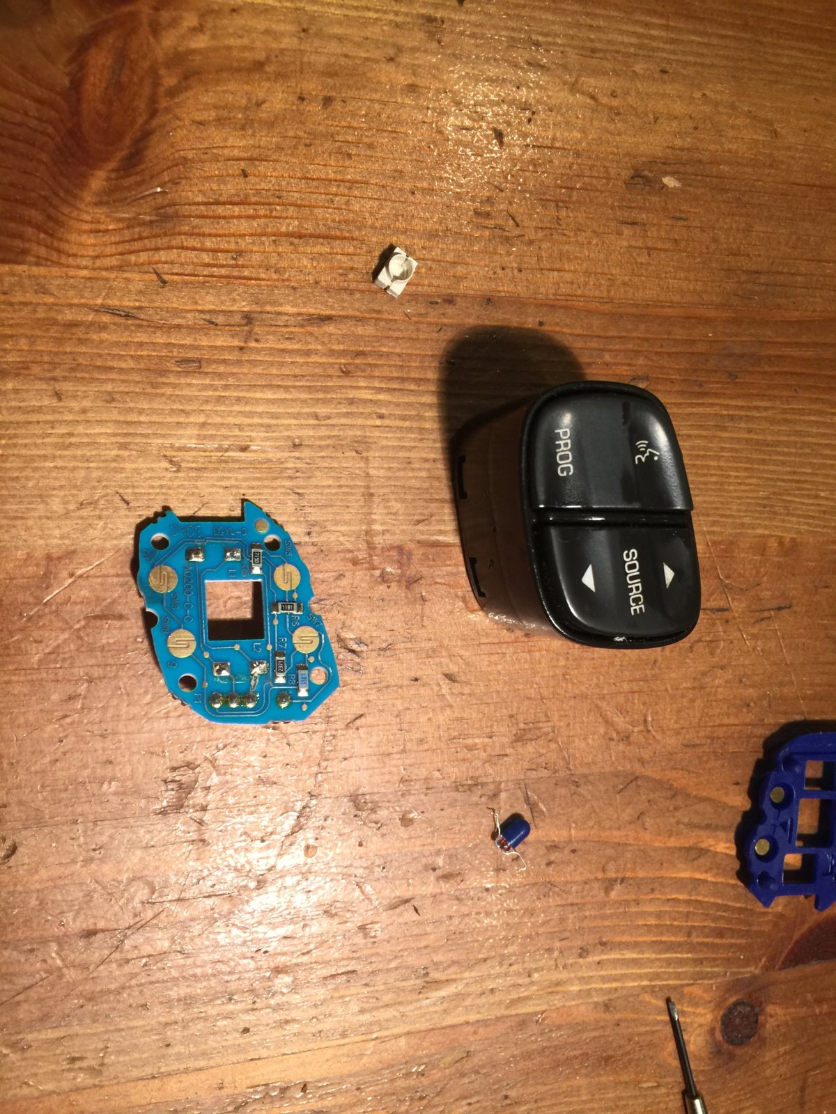

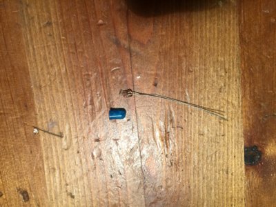

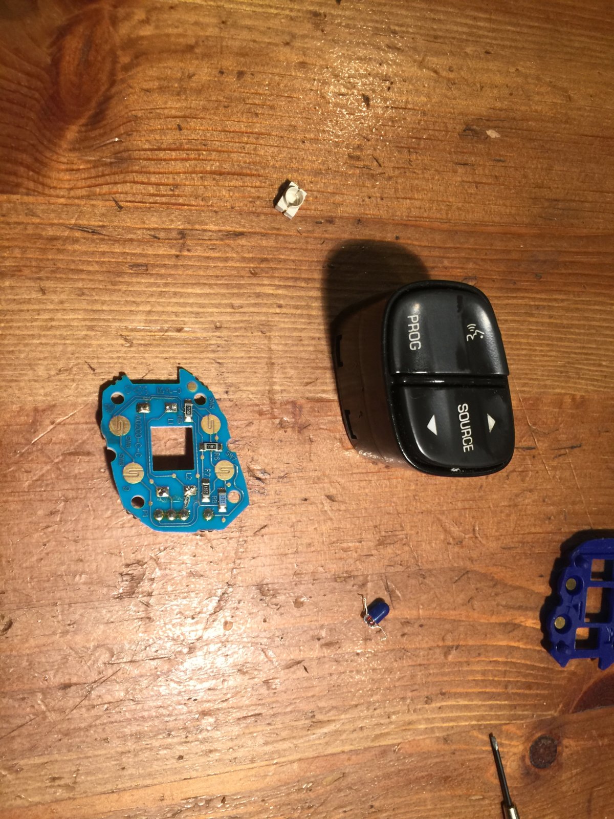

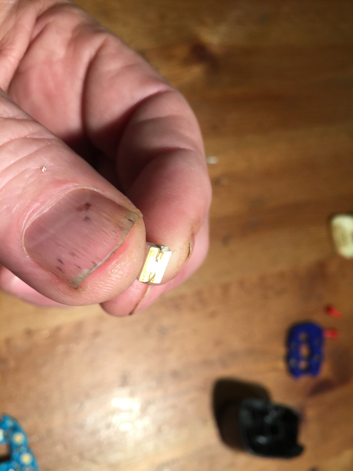

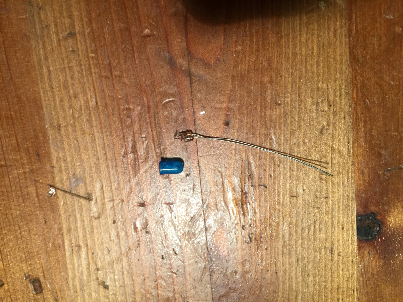

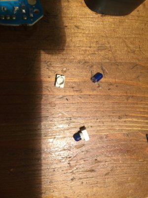

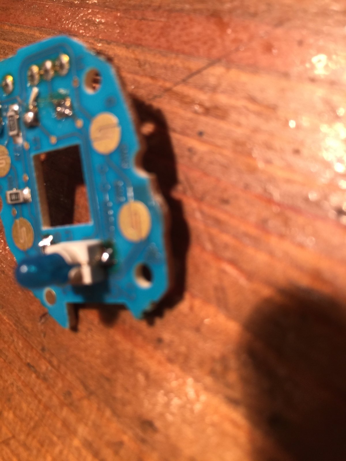

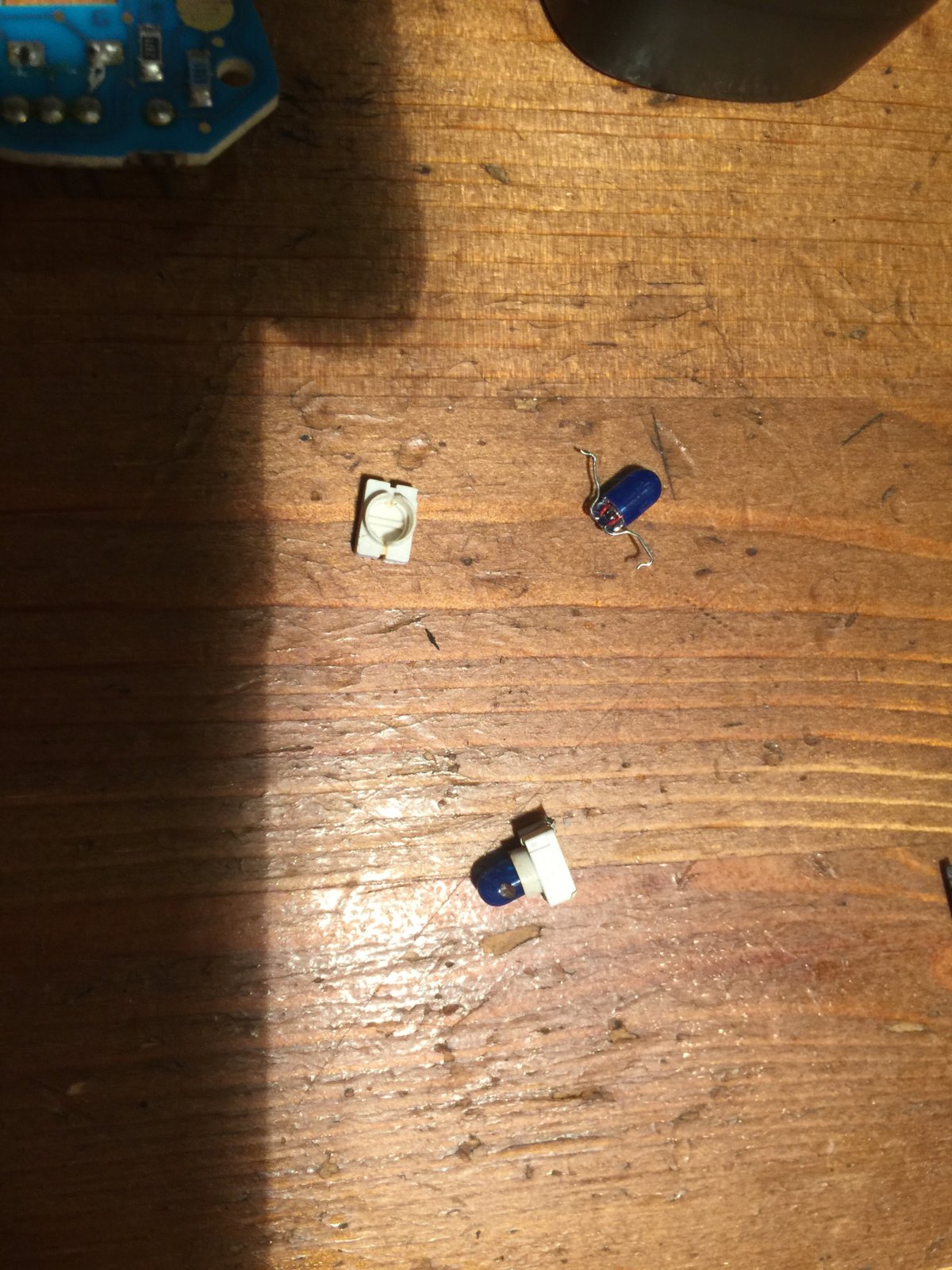

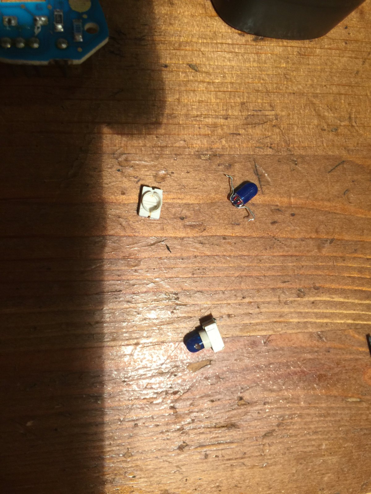

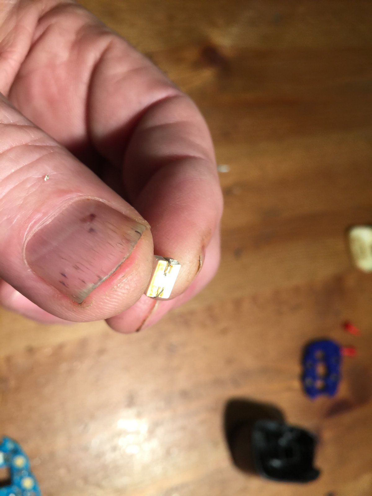

I ordered some replacement bulbs for the SWC buttons from audioxpress.com that came with the blue condoms already on since when I did the ones in The Beast those tended to rip. I forgot how tiny these things are. I found out that if I removed the airbag and clock spring I could get enough slack in the wires to make the r&r process of the button assemblies easy.
View attachment 214962 View attachment 214963 View attachment 214964 View attachment 214965 View attachment 214966
It's been awhile--can you remove the clock spring without removing the steering wheel?
52,949
Yep. It was all super easy. Remove airbag fuse, release airbag, disconnect airbag, remove first clock spring screw and horn starts going off, screw it back in and remove horn fuse, remove 4 clock spring screws. Then it was a matter of cutting one tiny zip tie on the button wiring harness and pulling it a bit until enough was sticking out to connect a set of buttons, then on to the next one. I watched some Youtube videos of guys making it super hard like using a piece of fishing line to hold the wire plug up while they blindly tried to put the switch into the hole and hope the plug went in, or assembling the switch in the hole while the internal parts would fall out due to gravity. They needed to turn the truck upside down for that one lol.
