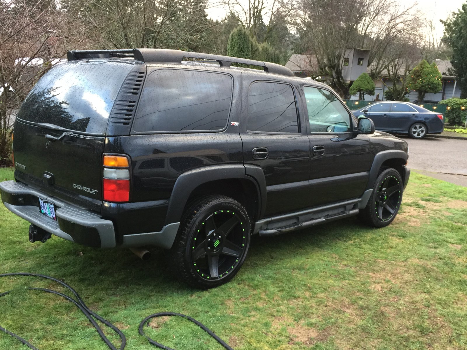

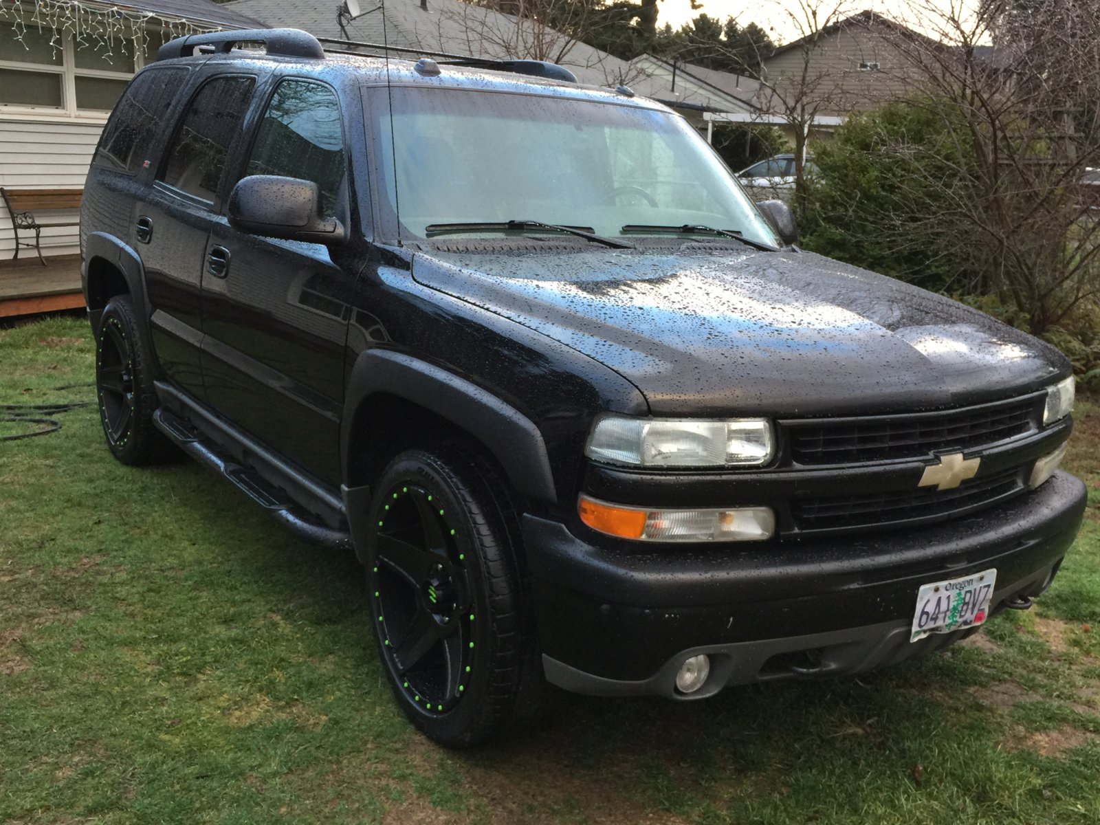

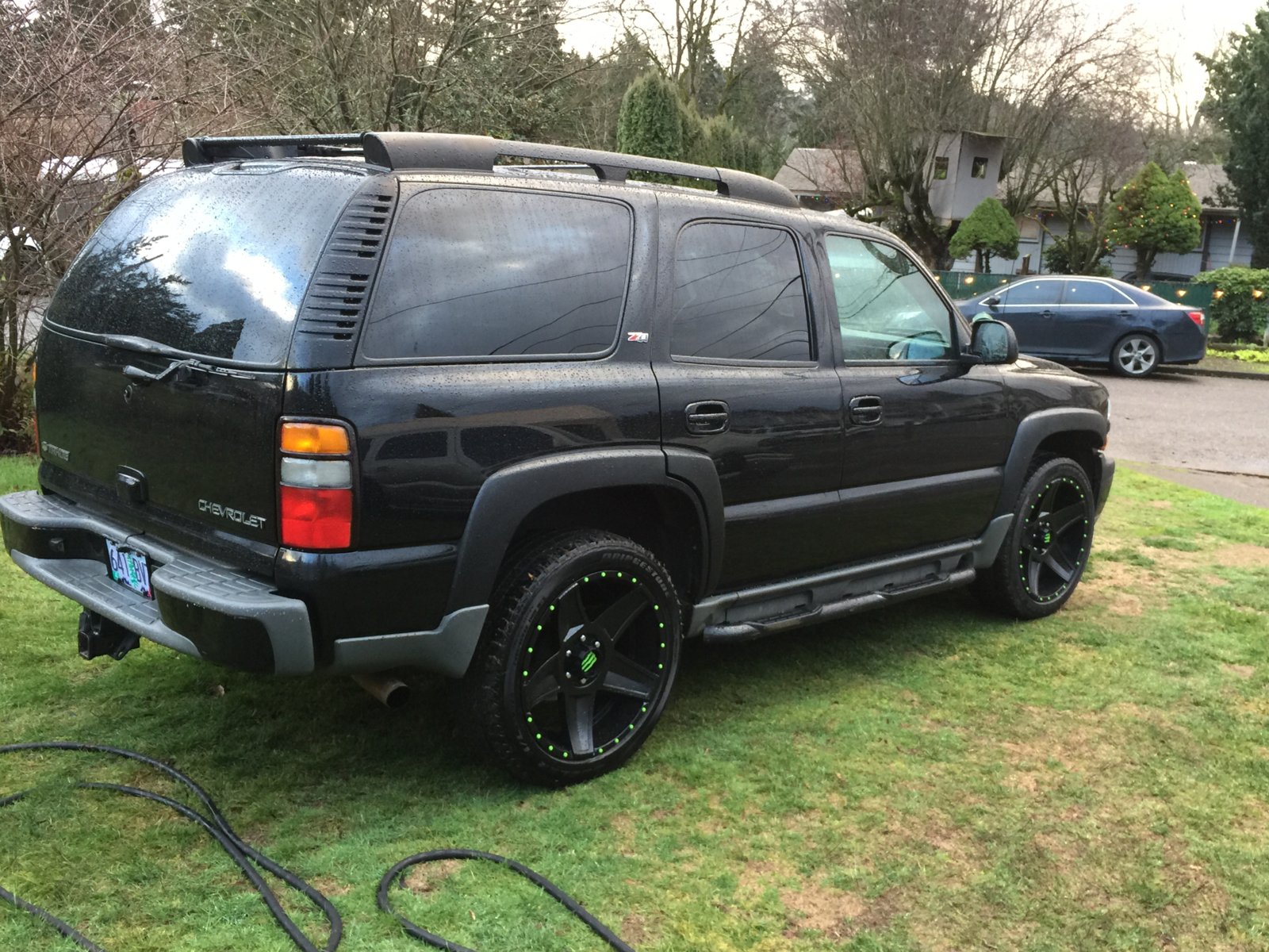

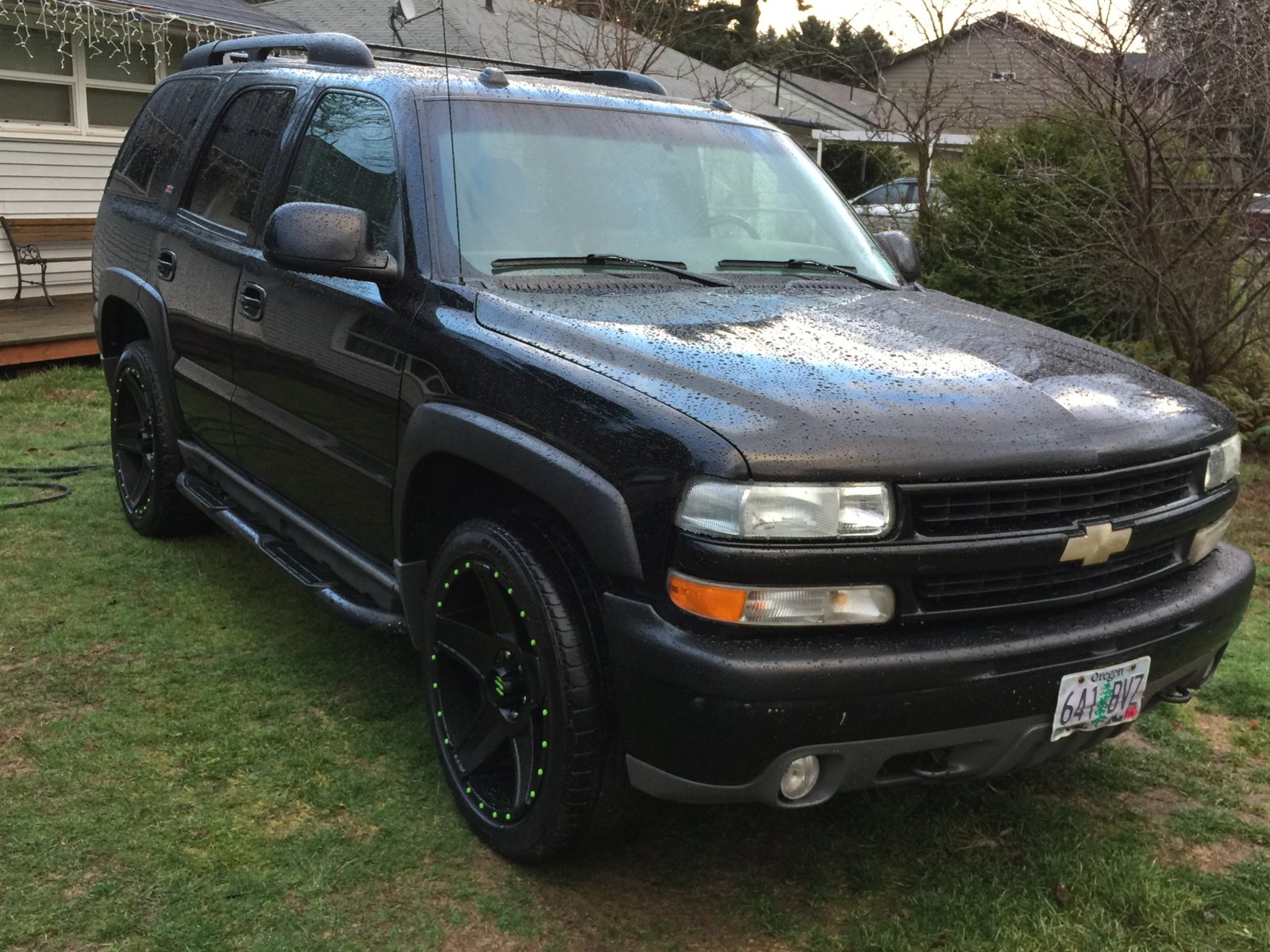

Hmmm that's an idea. But anyway I bought some time, or should I say a cheap Tahoe. It's a black 05 Z71 with 250k. I was looking for something with a little less mileage but this one looked like it was well taken care of which IMO is more important that the actual mileage. It's had the steering rebuilt, has some decent 22's although they have Monster logos on them, a new DD Kenwood with backup cam and a 10" Kicker sub and amp. The carpet is terrible but that's to be expected. It does have a couple problems which include no TPMS sensors installed (why he didn't put them on when he did the wheels is beyond me) and a problem with the Passenger Presence System for the airbags. But compared to what I was looking at for the price ($3500)it was the best I could find, plus I was out of time to look for one. I'm starting at a new jobsite tomorrow and didn't want to drive the Silvy there plus it is not a good truck to drive in the Winter. I kept hitting small holes in the roads around here and was worried about a blowout or bent wheel. I was going to look last weekend but unfortunately I had to put my buddy Kujo, my 12 year old Alaskan Husky, to sleep last Saturday. His cancer had spread again into unoperable nodules on his shoulder which were attacking his muscles and nerves, resulting in more and more pain to the point the narcotics I was giving him were beginning to fail us so I had to make the heart breaking decision to say goodbye. So the year ended rough for me but I will be OK. Thanks to all you guys for being here and supporting me.
