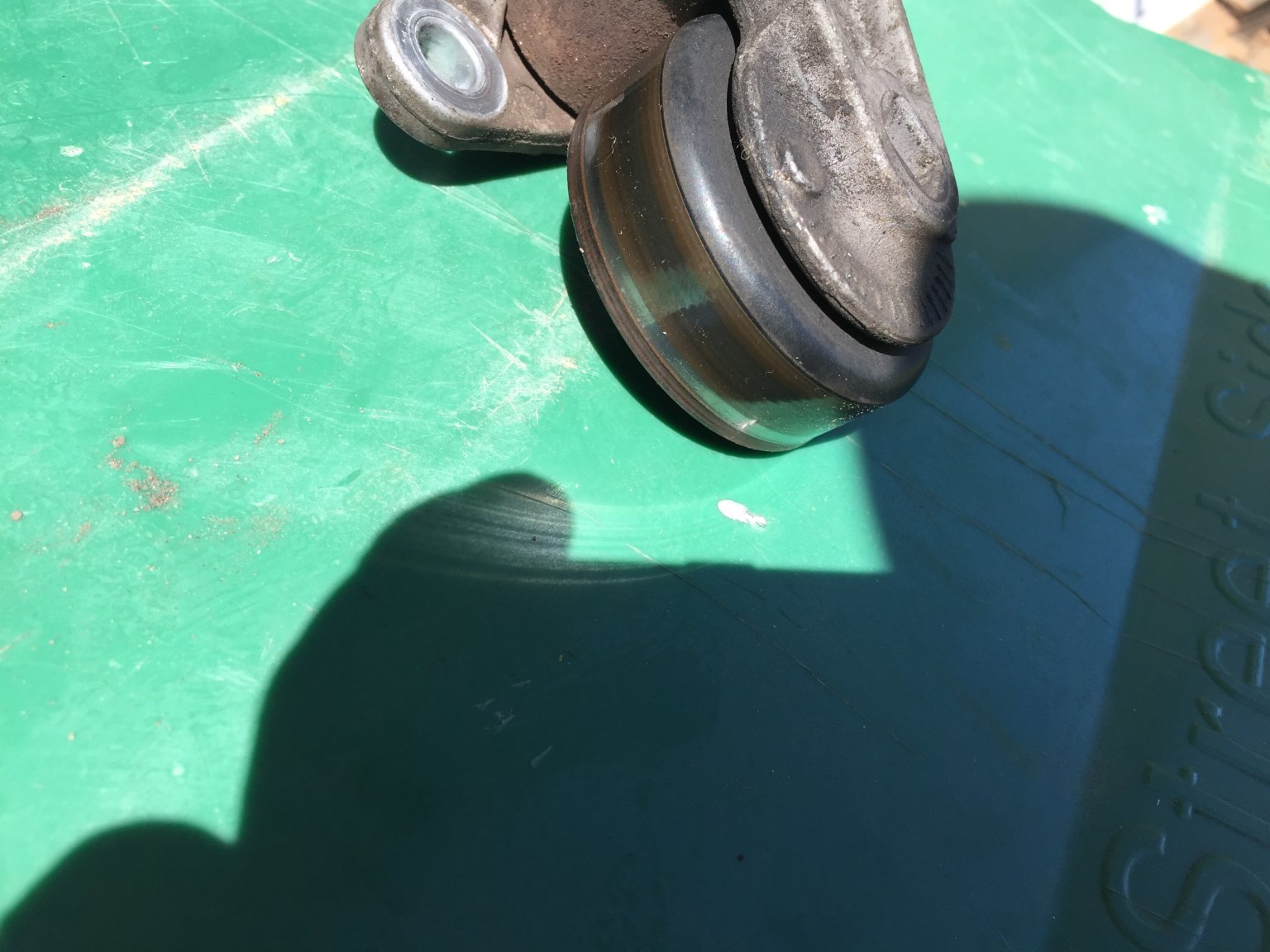

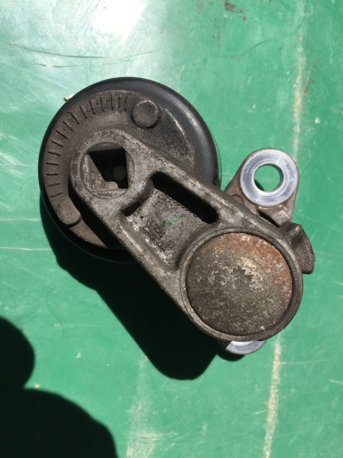

Then I decided to wash, clay bar, and wax with Tri Nova's Liquid Carnuba Wax. It really made it shine. I didn't get too much gunk off with the clay bar but that's probably because I've had so much paint work done and I think the body shop buffed the entire truck last year. Then while I was doing that, my AC belt tensioner showed up so I installed that. The old one was about half as strong as the new one. That should do it as far as belts since the AC belt, serpentine belt, and main tensioner are all new now as well.

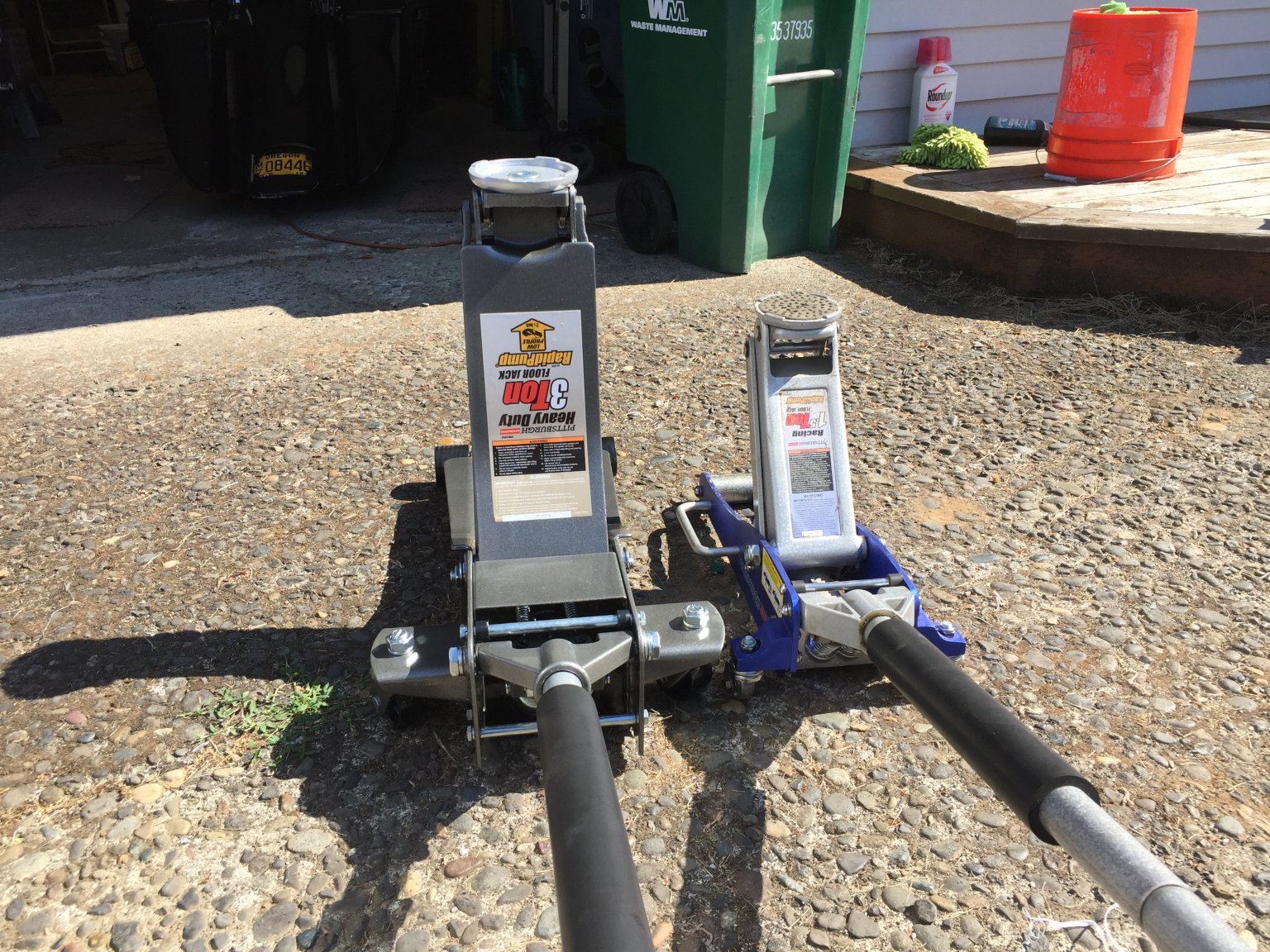

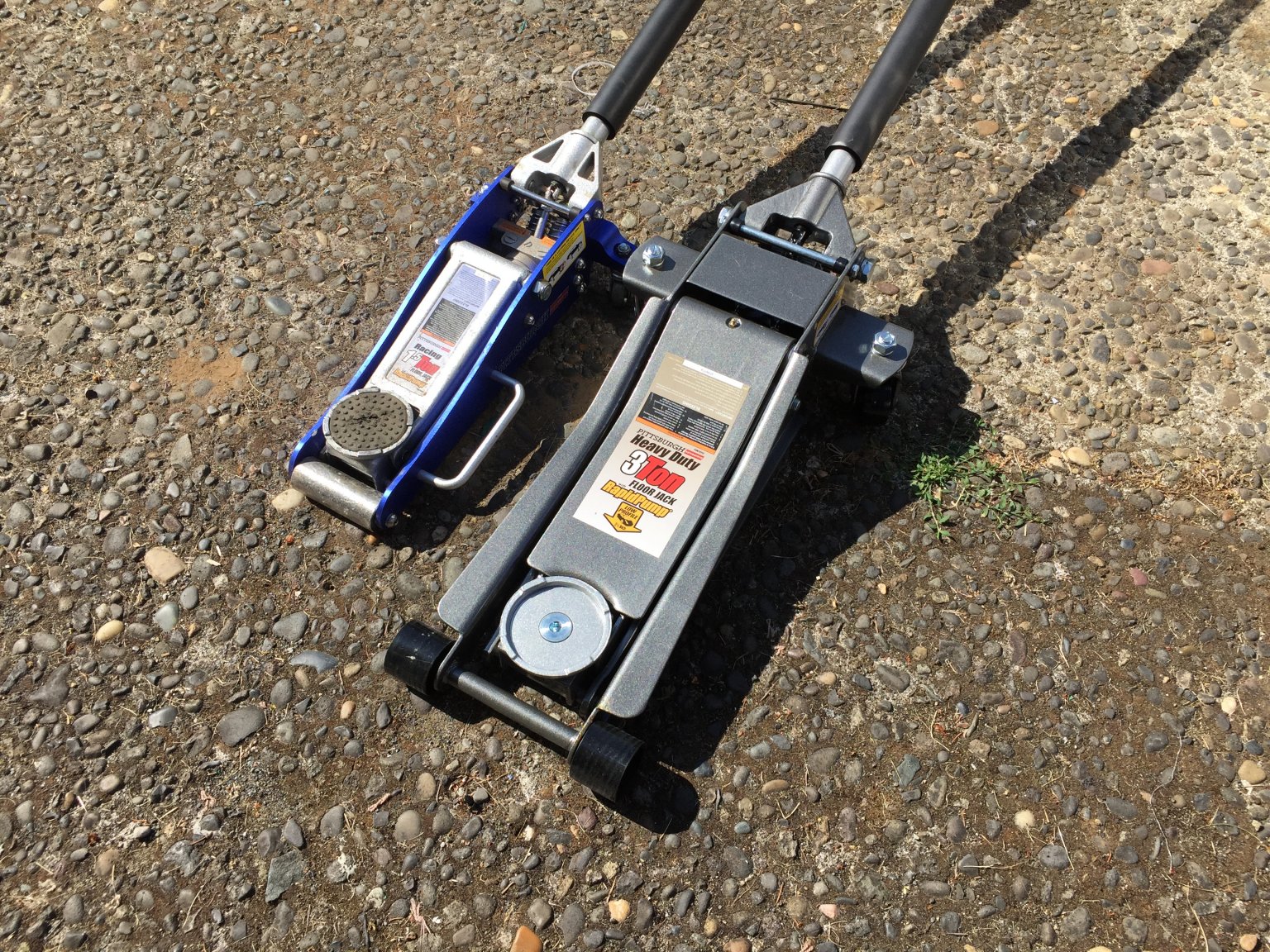

I just got a UPS notice- my headers will be here tomorrow! And I just got back from Harbor Freight with a new 3 ton low-profile floor jack that was on sale for $80, and a set of 3 ton jack stands to replace my old stuff. My other floor jack was a 1.5 ton aluminum one that worked OK for smaller jobs but was always weak and too short for the Denali. I would have to add 3 2x's on top and even then it would lift the truck just far enough to pull a wheel, plus it was maxed out on weight. Now this one lifts the wheel 3-4" off the ground without any 2x's needed. So much better!

I have the same jack, 4 ton model, just used it to do my oil change yesterday. No complaints as of yet

Same jack here. Love it. I had a coupon before for the 6 ton stands for $30, so I got those for fun.

X3 on that jack I've got the same one had it for 2 years no issues

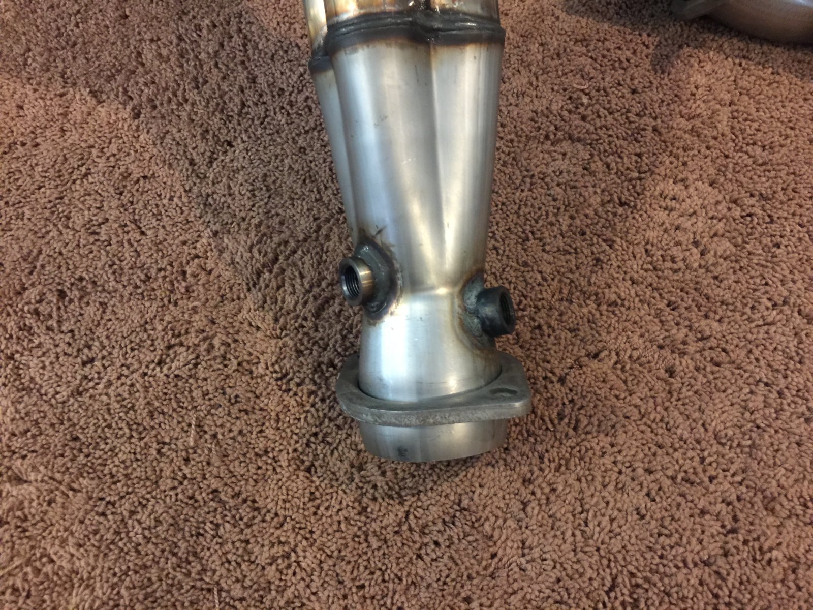

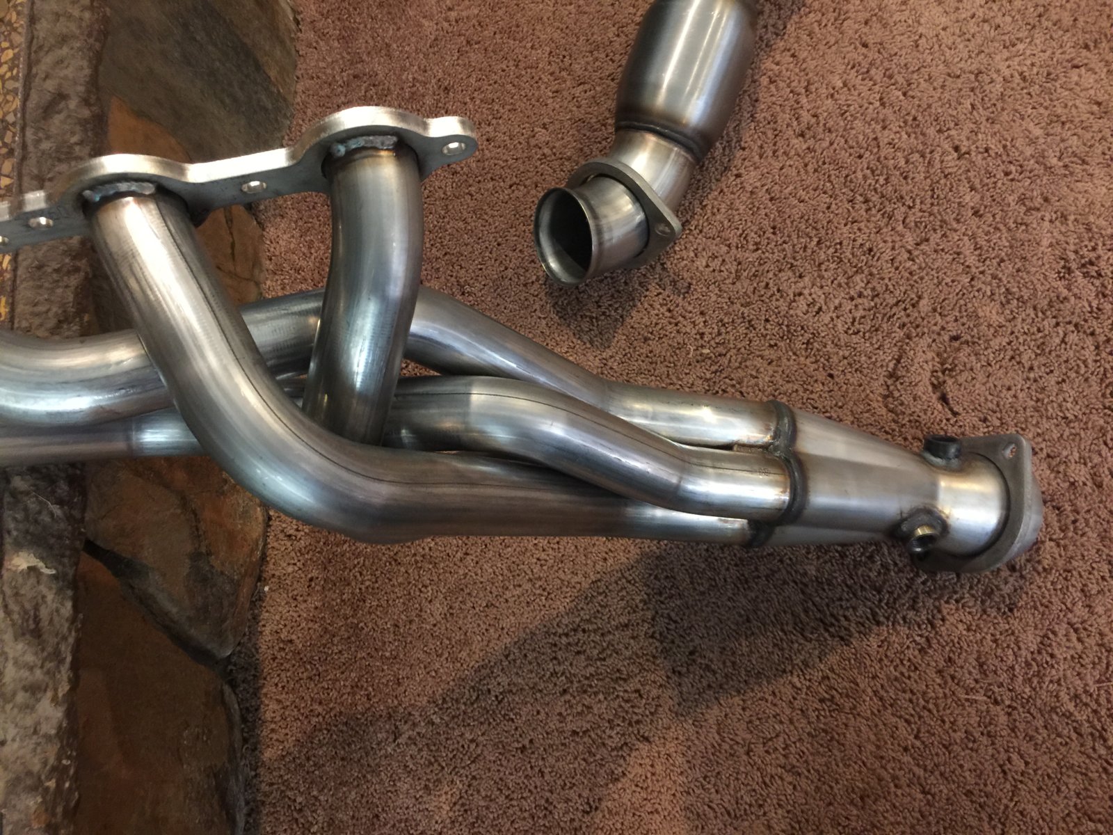

The headers came in today. Now I'm wondering if I should leave my AFR sensor like it is now- downstream of the cat on bank 1 with the downstream sensors tuned out. I feel like it's not very accurate but if I add a bung upstream on bank 1 then either I need to buy and install new downstream sensors and have them turned on in the tune or plug them. I have the plugs on hand. Any opinions?

I decided to go ahead and have a second upstream bung added on bank 1 of the headers for my wideband sensor so my AFR readings will be more accurate. Got that welded in today and I tested the exhaust manifold bolts that aren't broken to see if any more would break as I'm trying to remove them and surprisingly they all broke loose. I have 3 broken ones- 2 rear and one front. I have the Dorman clamps on hand to take care of that problem though so I won't need to extract the broken studs in the rear at least since there's no room unless I was to use the welding technique, since I don't weld. The front one I'll try to drill and use an extractor and if I fail I have the clamp. I crawled around under the truck today and measured for the headers and it looks like they'll clear the crossmember but it will be close. These don't have a Y-pipe, they have 2 separate 3" pipes that connect at the stock piece where they go into my double in, single out muffler. Just like the stock Denali system. So my plan is to install the headers tomorrow. I'm a bit nervous but after checking the exhaust bolts I feel better. I just don't want to get into a situation where the heads have to come off obviously, especially with the blower. As far as the downstream O2 sensors, I have 2 new ones ready to install if Blackbear ever gets back to me to say if they'll work ok.

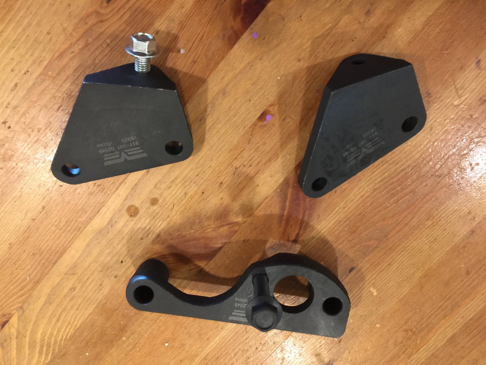

That's a really sweet setup on those headers. Will those Doorman clamps work on headers?
52,949
Yep. They just mount into pre-existing bolt holes in the heads and then the ones that hold the flange to the head just thread through the clamps and onto the flange hole in the manifold or header. My header flanges are as thick as the oem ones. Just mount the clamps to the head and then crank down the other bolt until the header is tight.

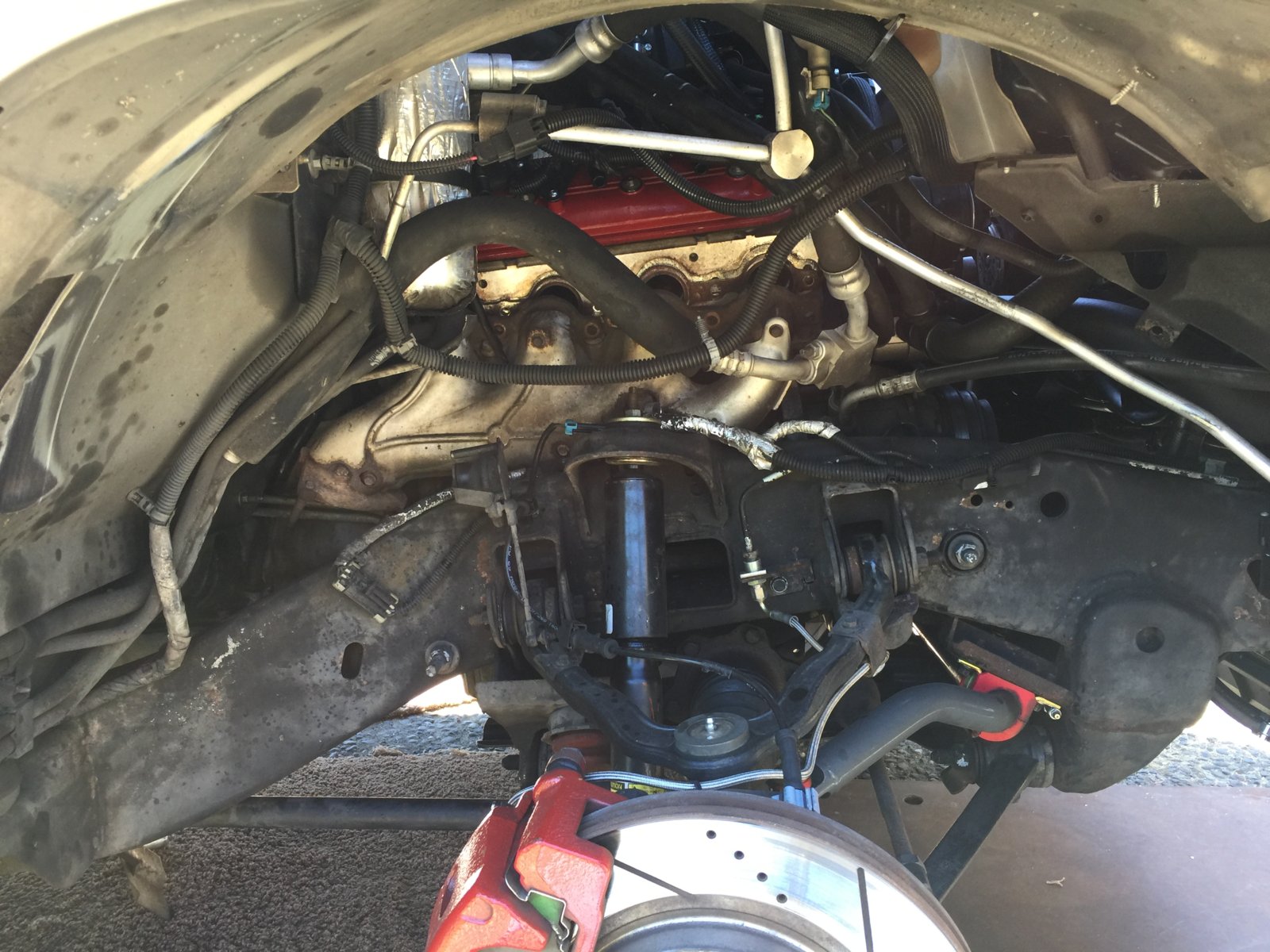

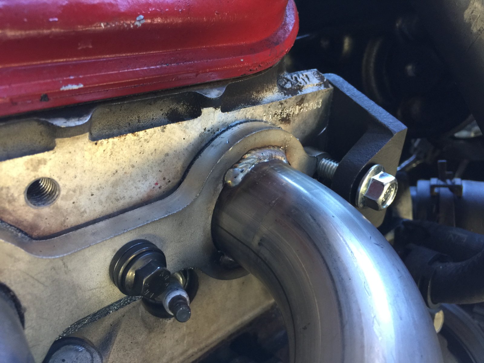

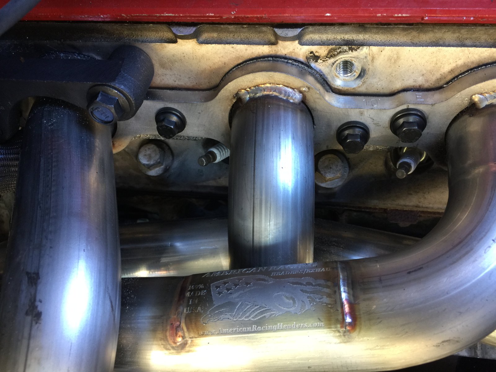

I decided to update progress so far. I removed the wheels and inner fender liners for access. Here's pics of the old midpipes, removing the old exhaust manifolds and trying to drill a broken bolt on the passenger side and failing. I tried an easy out called Grab-It and it was a failure. I actuallt had a different bolt starting to back out with a pair of vise-grips on the protruding stud but then it broke off. I had no luck at all removing the broken bolt studs so lucky that I prepared by getting the Dorman clamps. I did manage to get the broken dipstick tube out.
52,949
here's some pics of the passenger header installed with the Dorman clamps in the front and rear which is where the bolts broke; the middle ones came out OK. The last shot is the clearance at the oil pan. These headers were actually pretty amazing to me as to how well they fit. I was nervous, and after measuring and checking I decided it was too close to call if I'd have any problems and decided to trust what ARH told me, that they would fit my Denali. They were right, they cleared everything (the dipstick tube has yet to be determined, I think I'll have to modify it) and both midpipes connected into the stock exhaust just like the originals and used the stock hangers.
