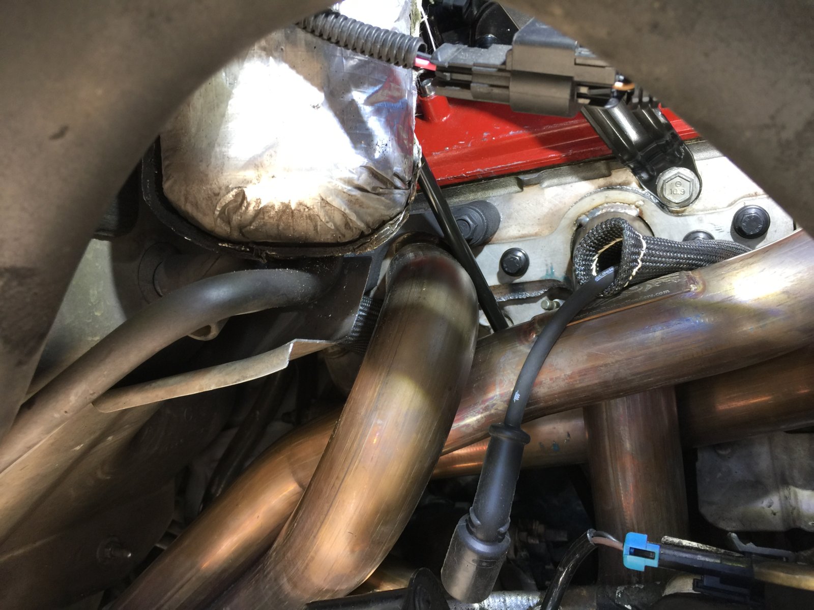

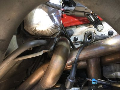

My AC Delco dipstick tube arrived damaged so I reordered one from Amazon and they said it would be here next Monday. I wanted to get this done today so I bought one from my local GM dealer for $7 more than Amazon's shipped price. Now I remember why I never buy parts there. That's way over list price. ARH had called me the other day to say an OEM one should fit with their headers so I unbolted the header like they said, leaving if connected at the swivel fitting. The OEM one popped right into the hole. The Dorman clamp had to go on at the same time in order to get the bolt in it. Basically, I had to have the header loose, then pop in the dipstick tube but leave it's bolt out, then install the header bolts, then the Dorman clamp bolts, then the dipstick bolt, in that order. I cleaned and painted the inner fender liners and installed them too. To be clear, I DO NOT recommend the Dorman dipstick tube. It must have a manufacturing defect because it would barely start in the hole and then get stuck. Glad to get this done.

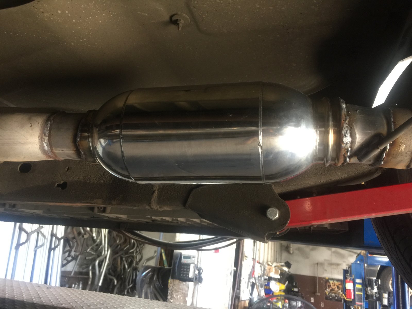

Thanks @Fosscore . I just got back from my local muffler shop where I had an Aero turbine 3535 muffler installed. It's stainless 3.5" in/ out with lifetime warranty. I decided I wanted the Denali to SOUND like it had headers and a blower and now it definitely does. If you guys haven't heard one of these mufflers, especially under WOT, you'll be amazed when you do. It's "on the verge of being obnoxious" as the guy at the shop said. He explained that it's actually louder than a straight pipe and I believe it. I'll have to figure out how to get a sound clip on here since Photobucket is now a rip-off.
