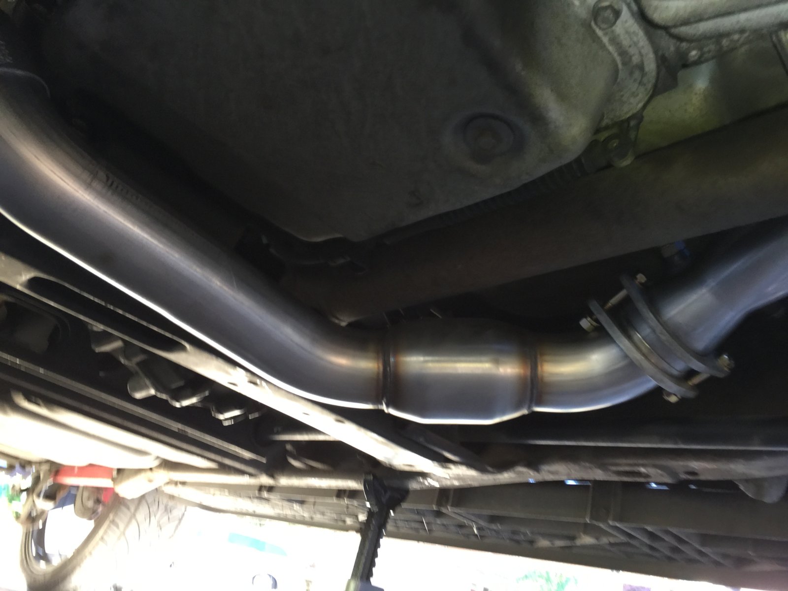

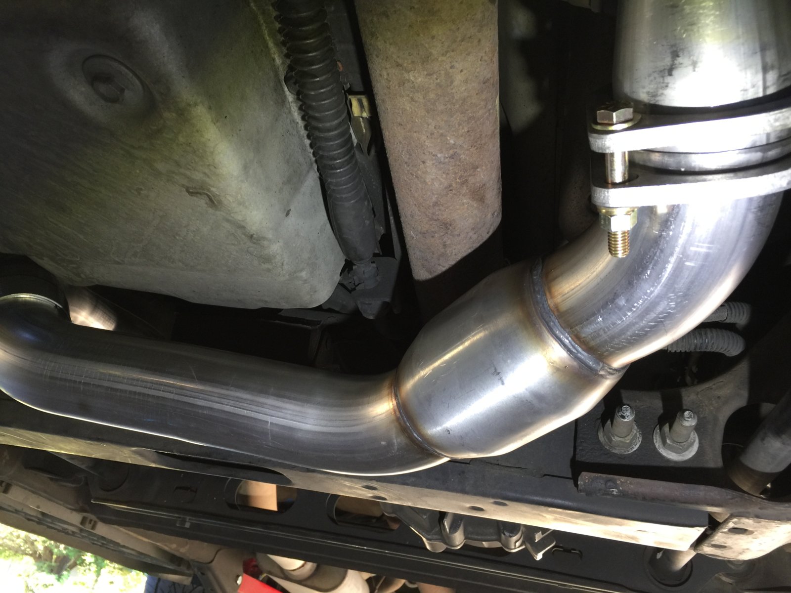

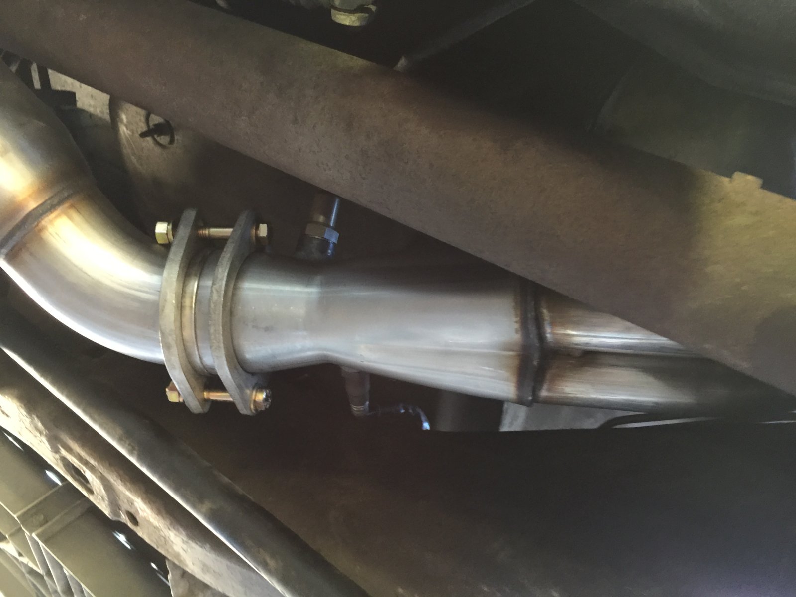

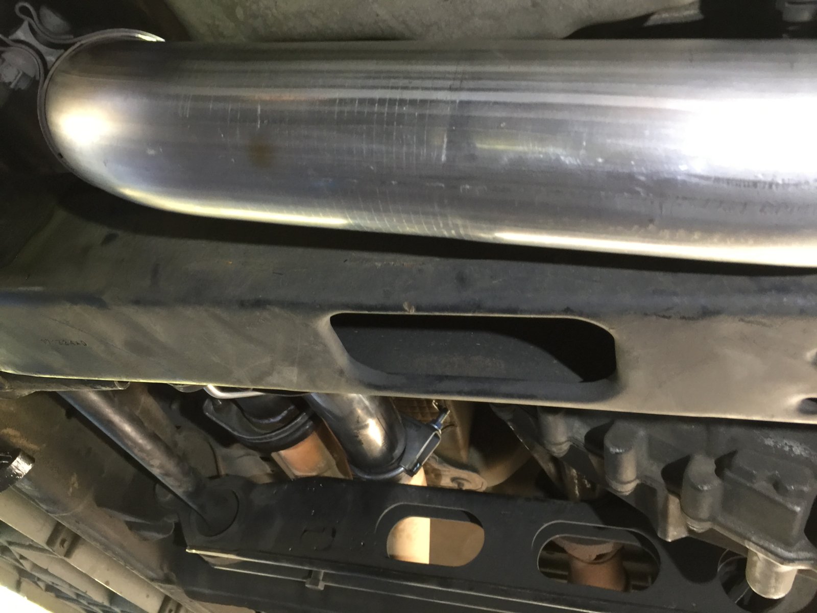

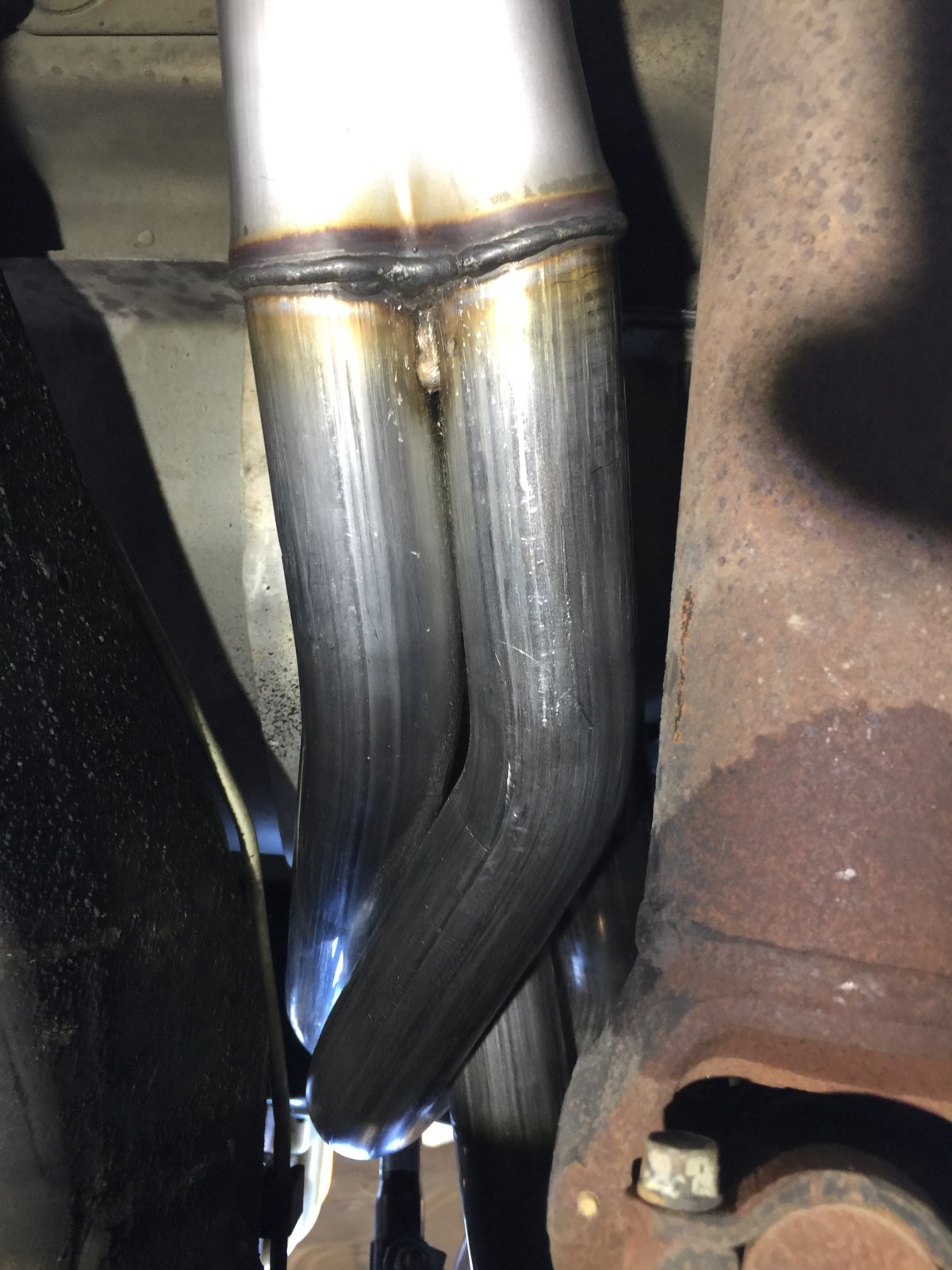

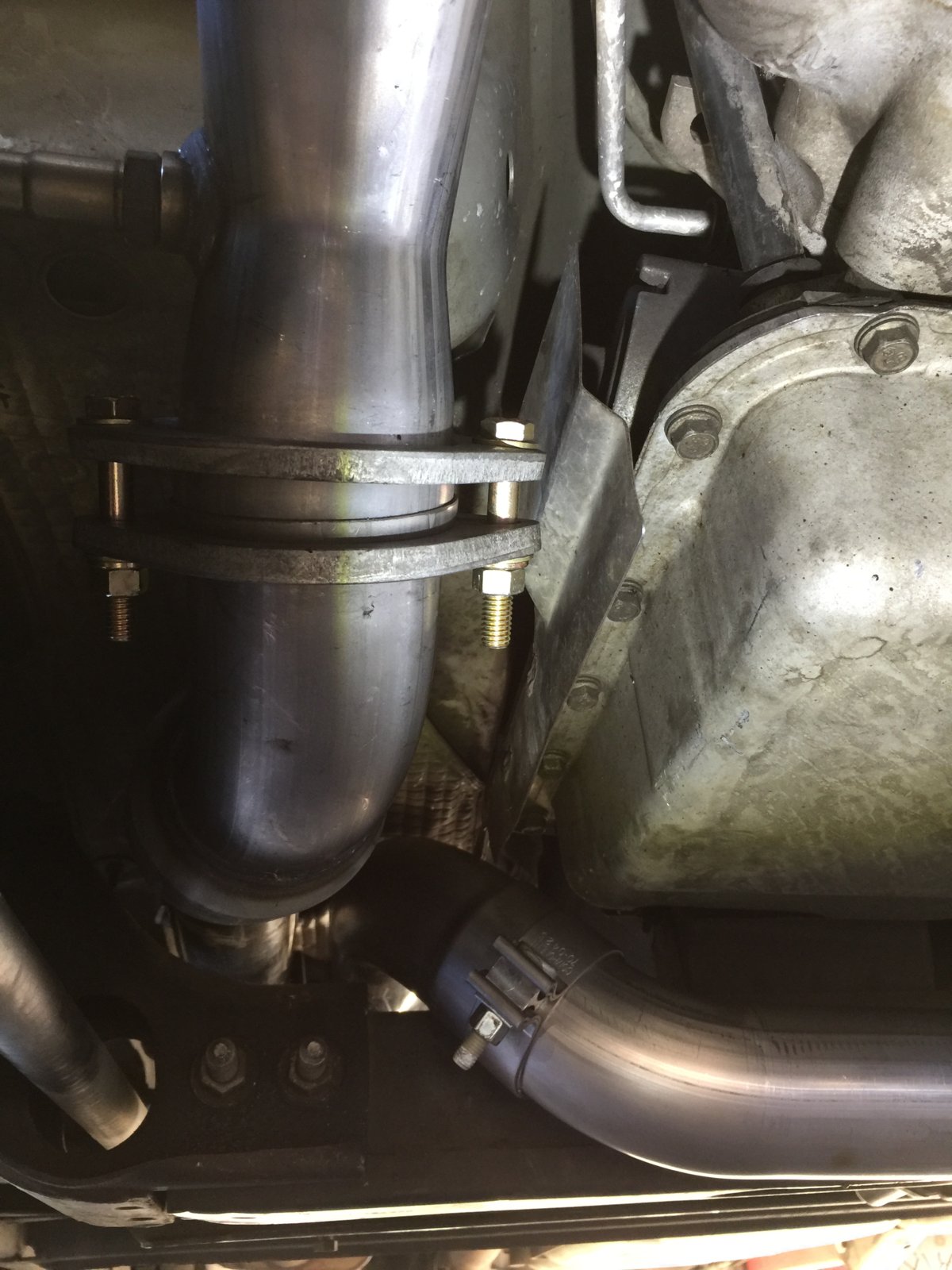

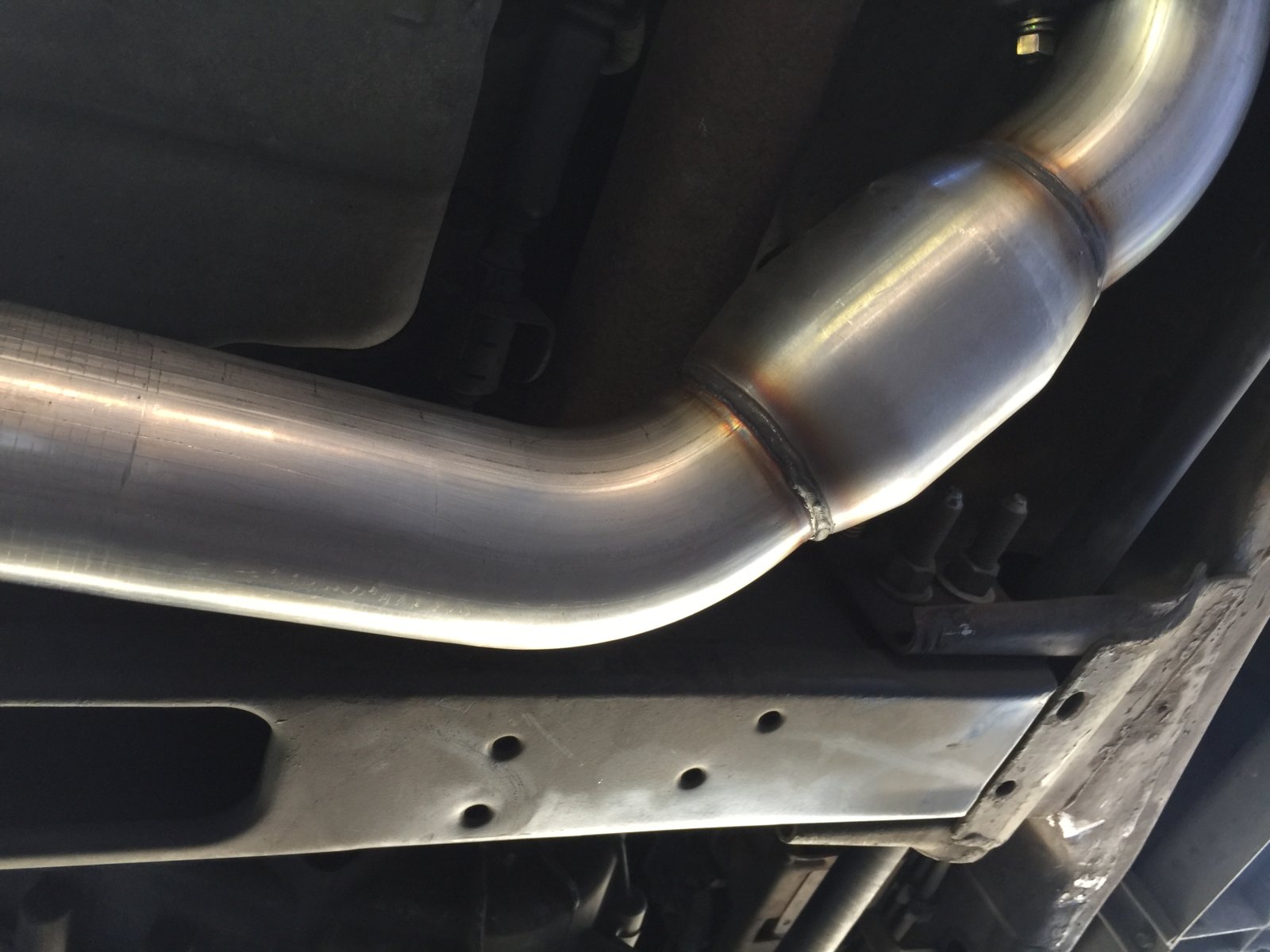

Here's some more underneath shots of the clearances. It was nearly perfect everywhere. These have dual 3" midpipes going all the way back to the point where the factory dual pipes go into the dual-in, single-out Flowmaster.
52,956
It was a real ***** getting things into place at a few spots but once in place, it all lined up perfect. I really was amazed. I planned on having it done today and I almost succeeded but tomorrow it will be running and I can't wait to see what it sounds like!

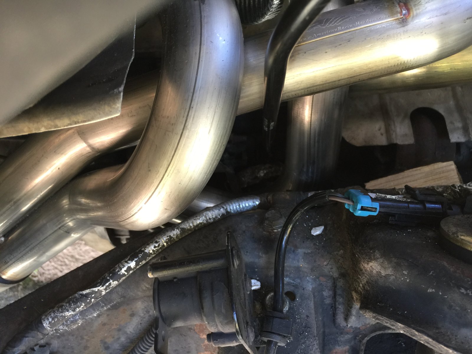

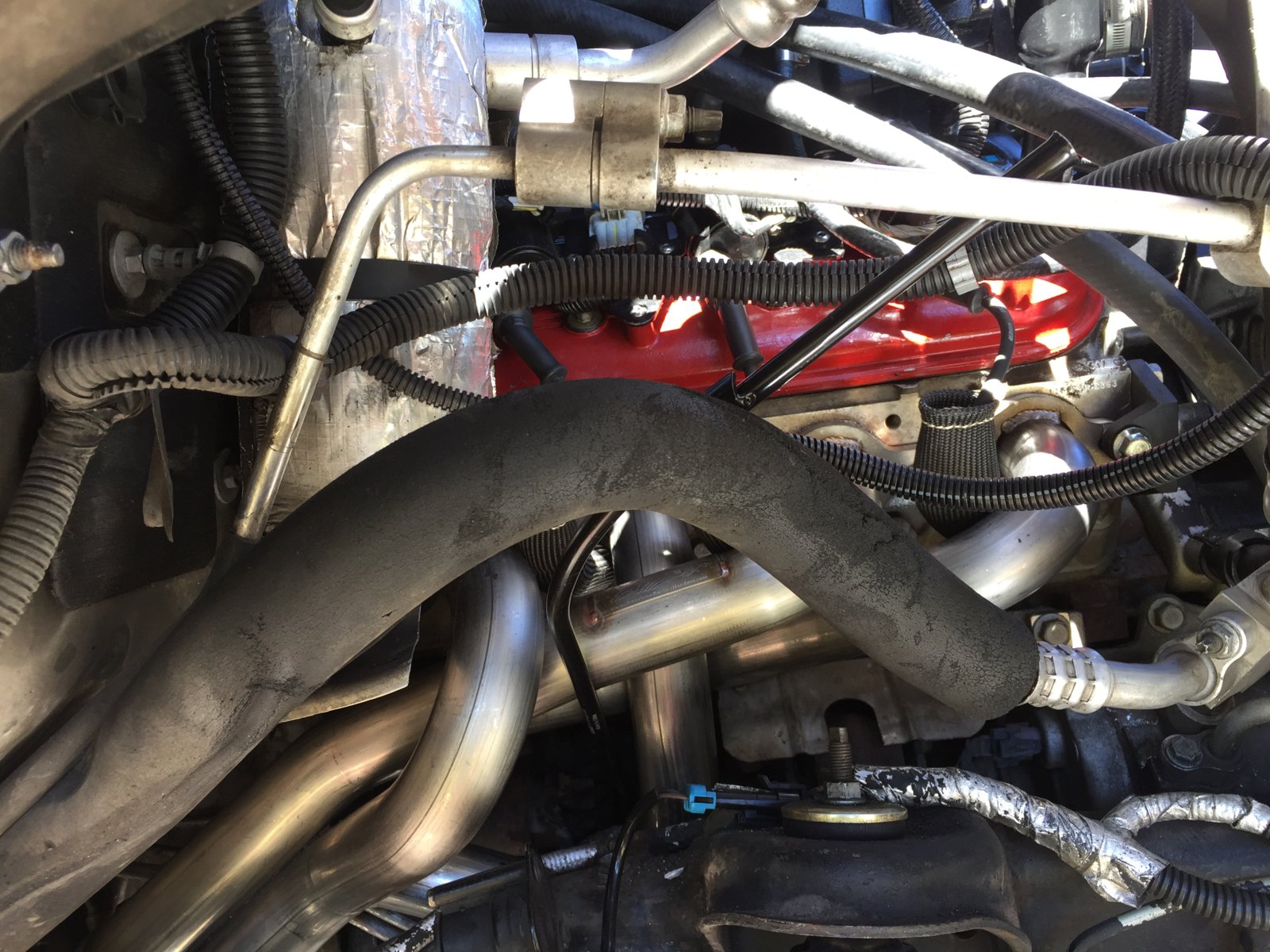

Still have an issue with the dipstick tube. I got a second Dorman (free warranty exchange) and decided there is no way it will go back anywhere even close to the way it originally was with these headers. So I removed the mount bracket since it will be useless and tried bending the tube so it would just go into the hole and end up where I could get the dipstick in and it started breaking again at the same place. I have an OEM one on order and will be here Tuesday.
I got everything else back together this morning and fired it up. Sounds good but I was expecting it to be louder honestly. There was a ton of white smoke coming from the tailpipe that freaked me out until I read up and found out it's normal for the first day or 2. No leaks of any kind so I'm happy with that. Does kind of sound badass when I give it some gas but I still haven't driven it yet. I'm going to install the wheels and grill and go for a test drive an awhile.

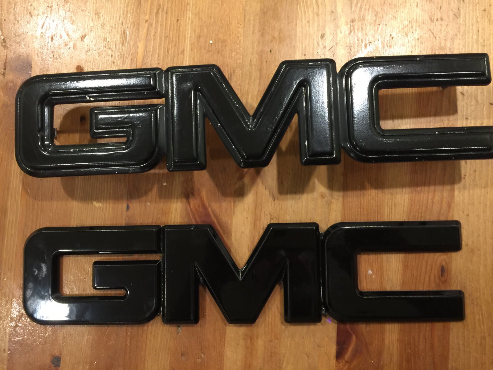

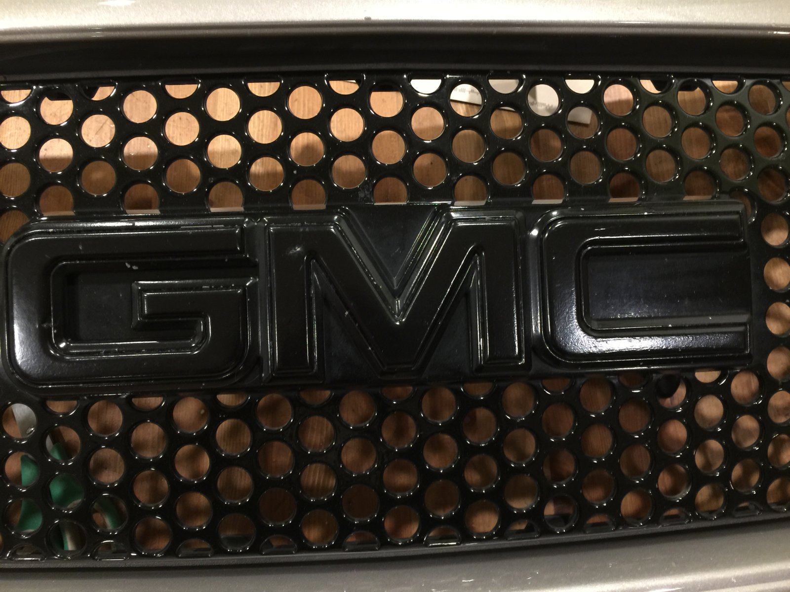

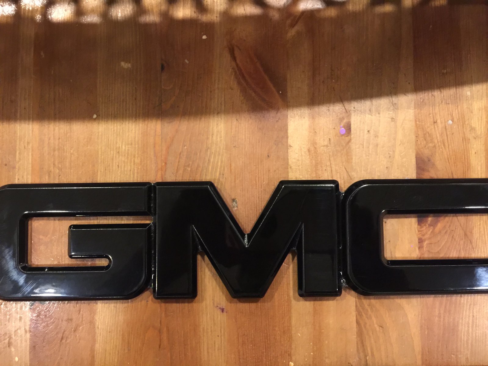

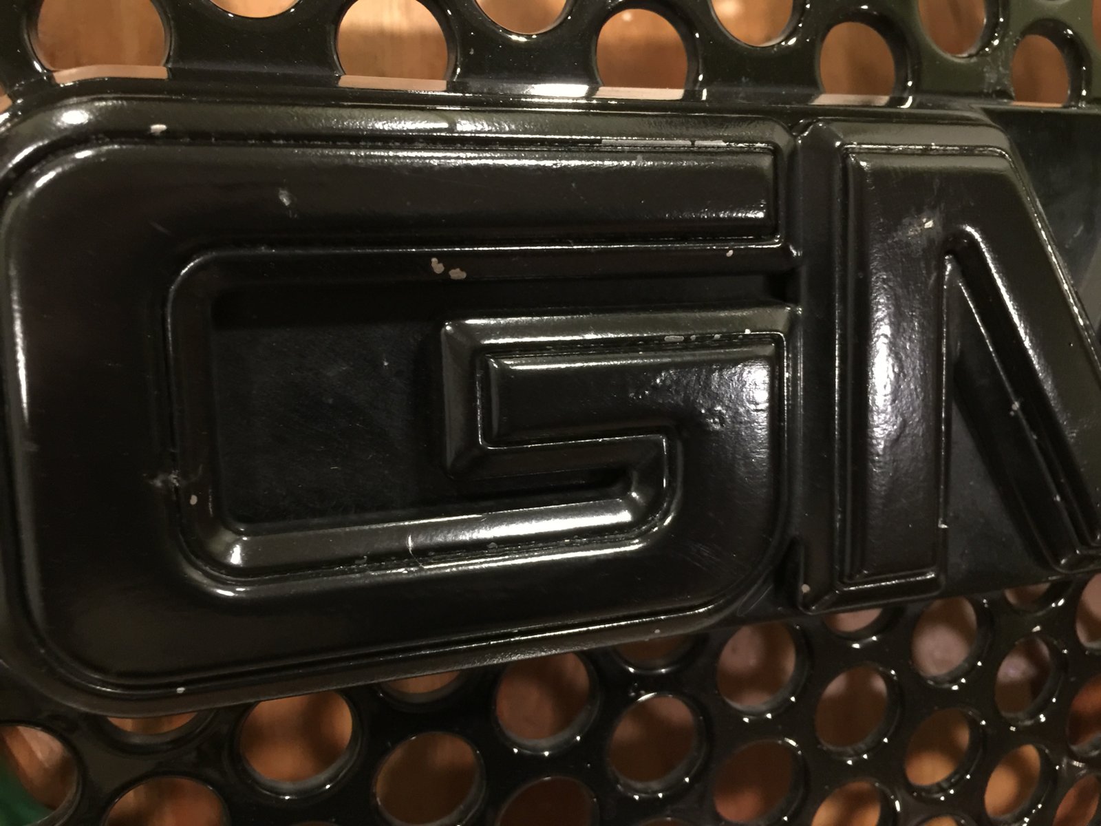

Went for a test drive and it does sound better; before when I hit WOT it had a weird sound that sounded like it wasn't able to push out all the exhaust it needed to and now it sounds like it's breathing better. Seems to rev faster too and acceleration is a bit quicker. I think when I get the cam in it will wake up the exhaust more also. I also got my billet front emblem in and installed it this morning. Looks way better than the old beat-up one.

Thanks. Not sure if it was worth the money but my oem one was messed up and even a new one of those is about the same price.
The billet will probably hold up better than a painted one, so probably a good investment.
