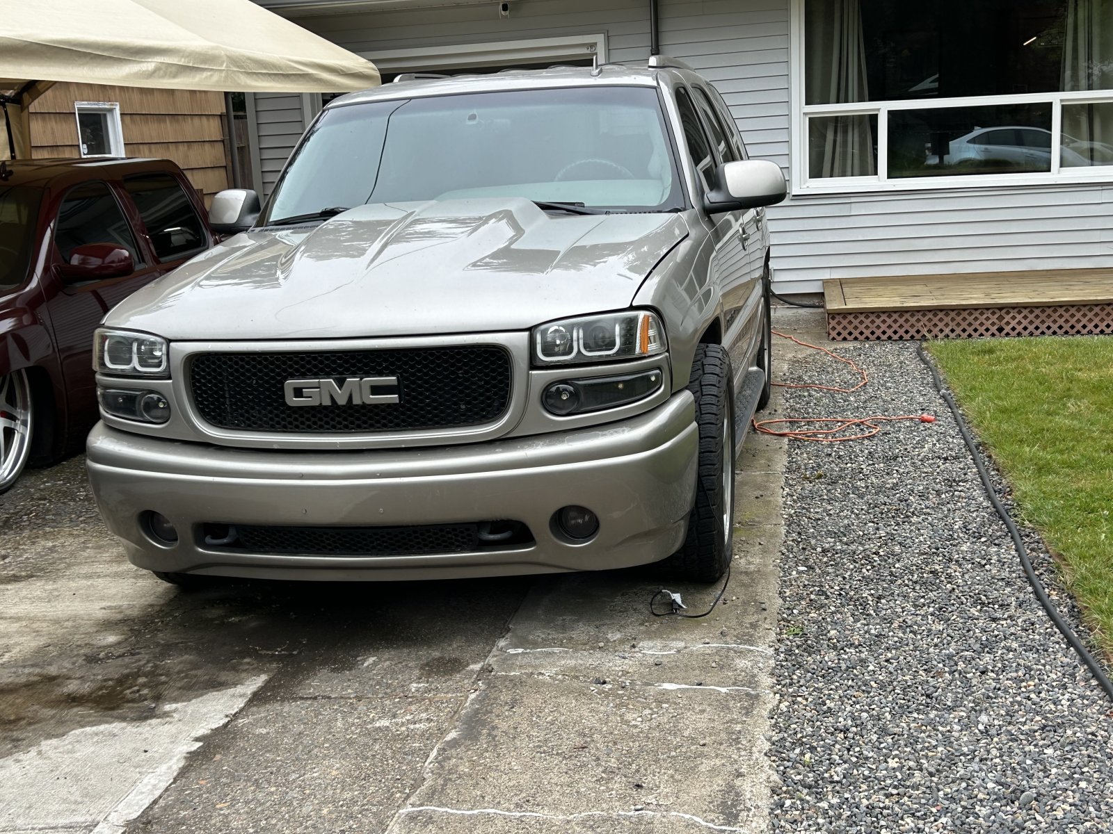

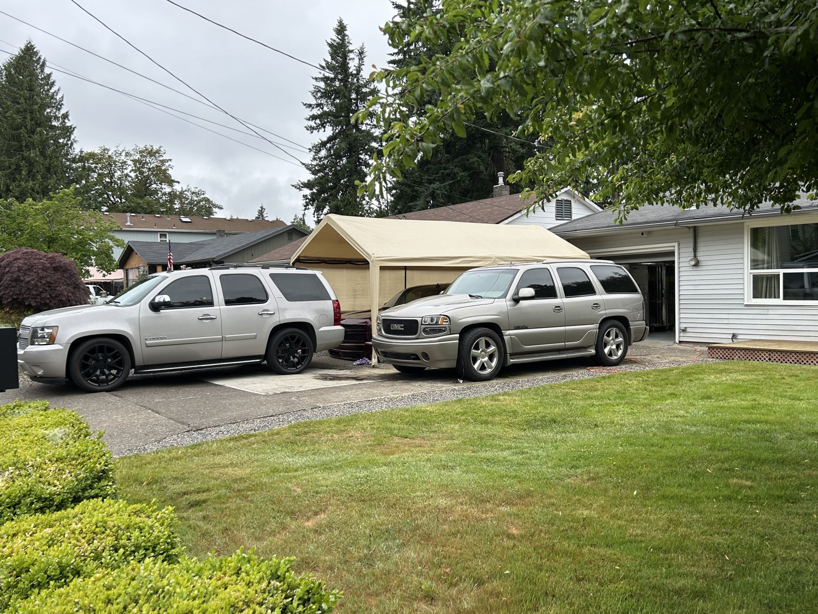

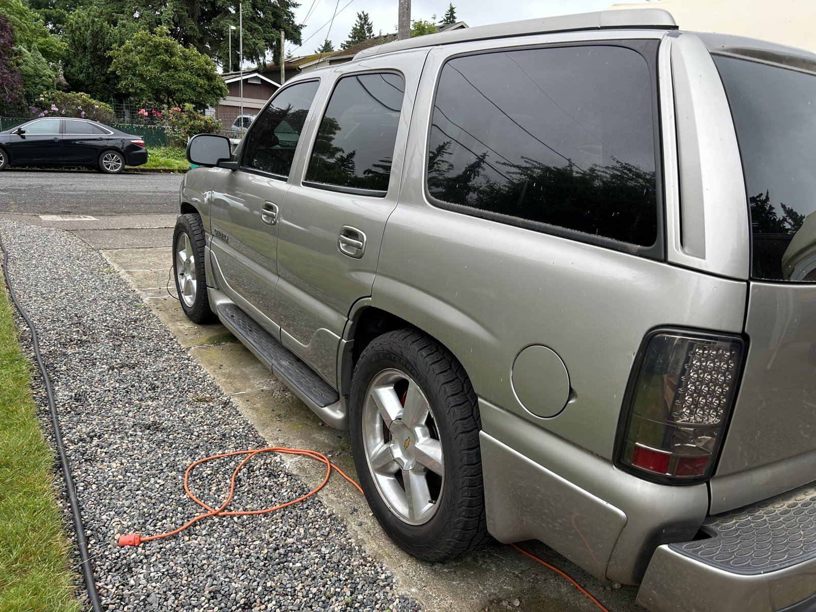

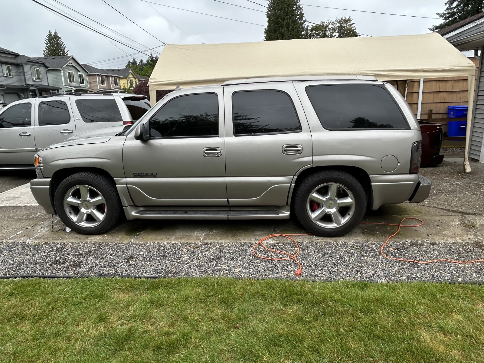

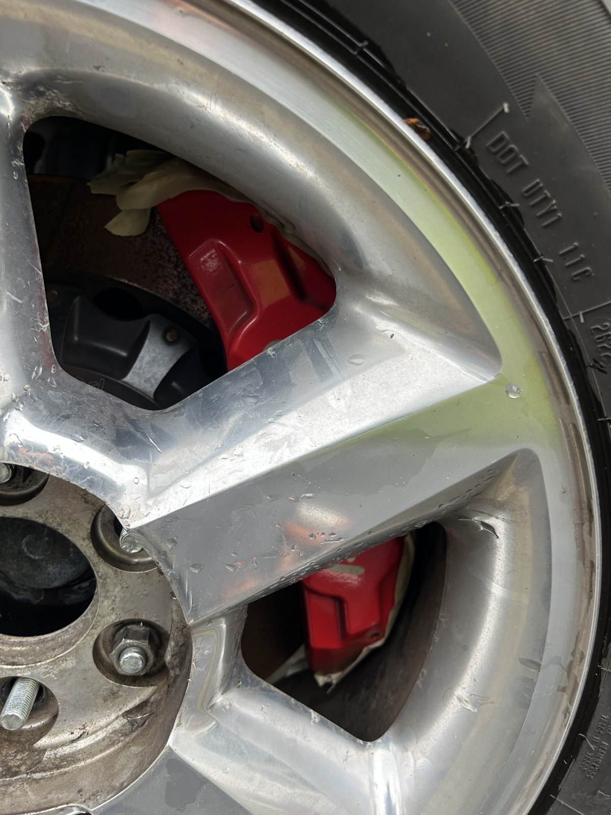

The spacers worked. There’s about 1/8” clearance. The GM wheels taper at the outside so the further in they go the smaller that diameter is for calipers. They weren’t thinking about big brakes when they designed them. The reverse stance looks weird but it rolls. Still haven’t figured out what’s wrong, I have a few things going on and I’ll get to it.
