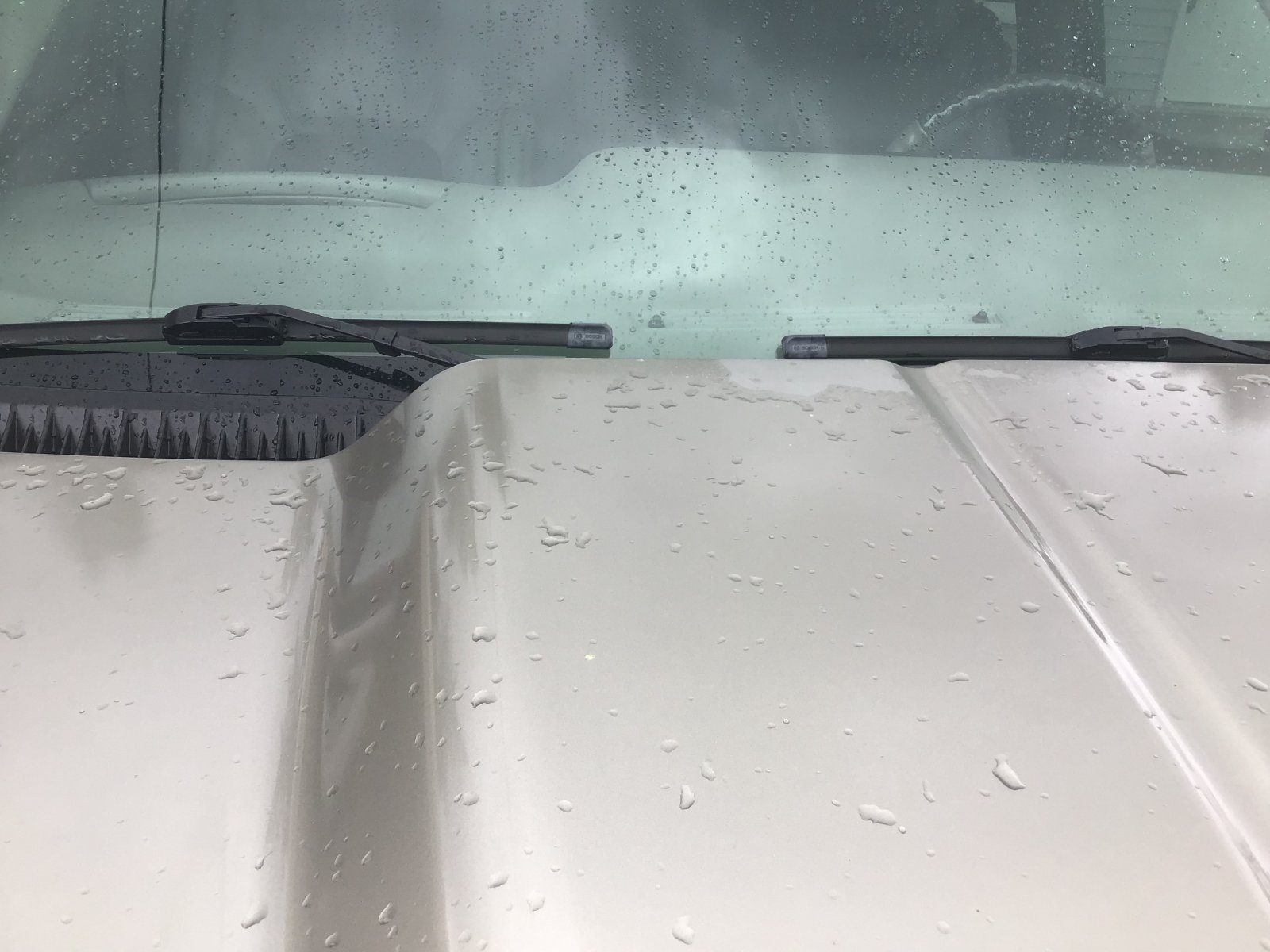

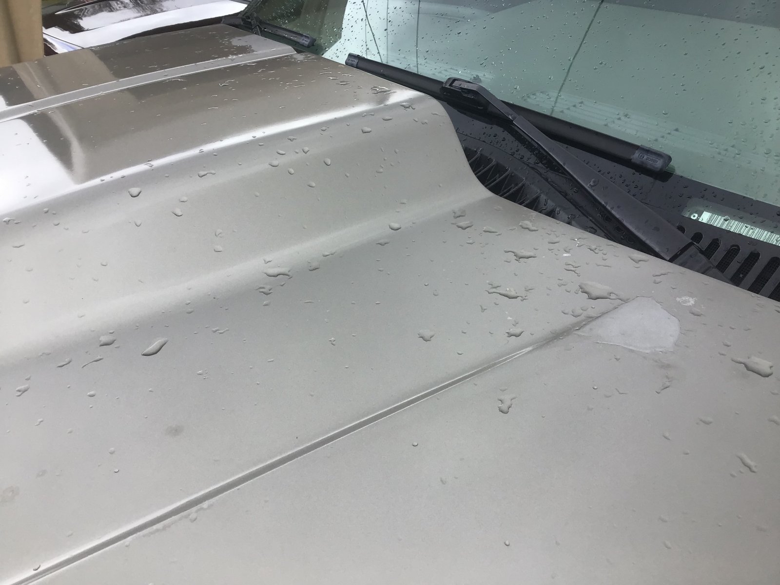

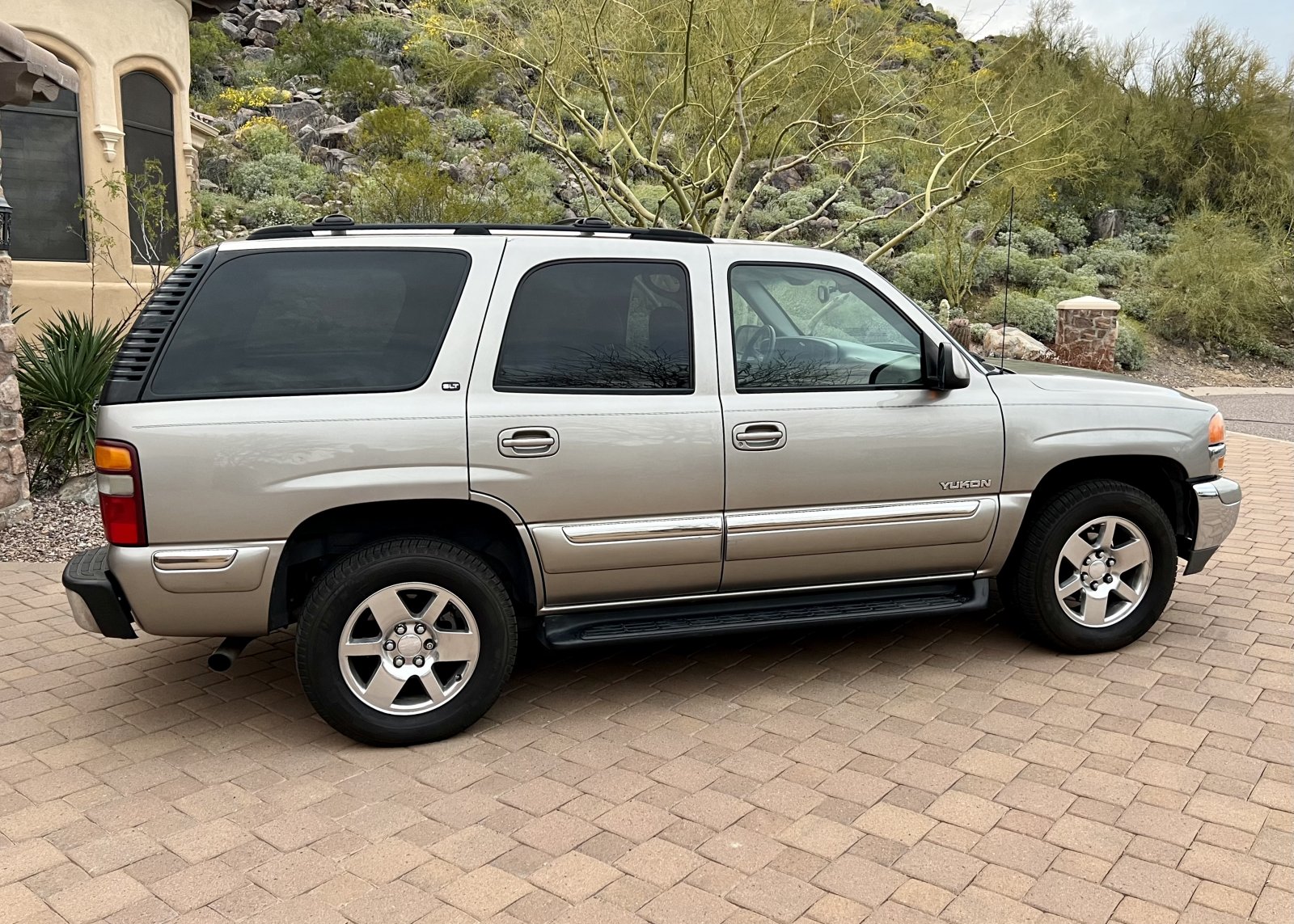

My appointment at my friends body shop was today so I stopped by. He is way behind due to the big snowstorm we had a month or so ago and so we decided to push it back 2 weeks to give him a chance to catch up. I understand since he’s doing it pretty much for the cost of materials plus a little. Had a nice long talk about him trying to get to a retirement point. He bought a house with a big shop and plans on eventually just doing small jobs there and close his body shop down but he figures he’s still at least 5 years out.
Here’s a couple pics of how bad it’s getting. Once clear coat starts flaking off it starts looking bad pretty quick.

It must only bother you cuz you know it's there. Anyone else only sees the taillights.

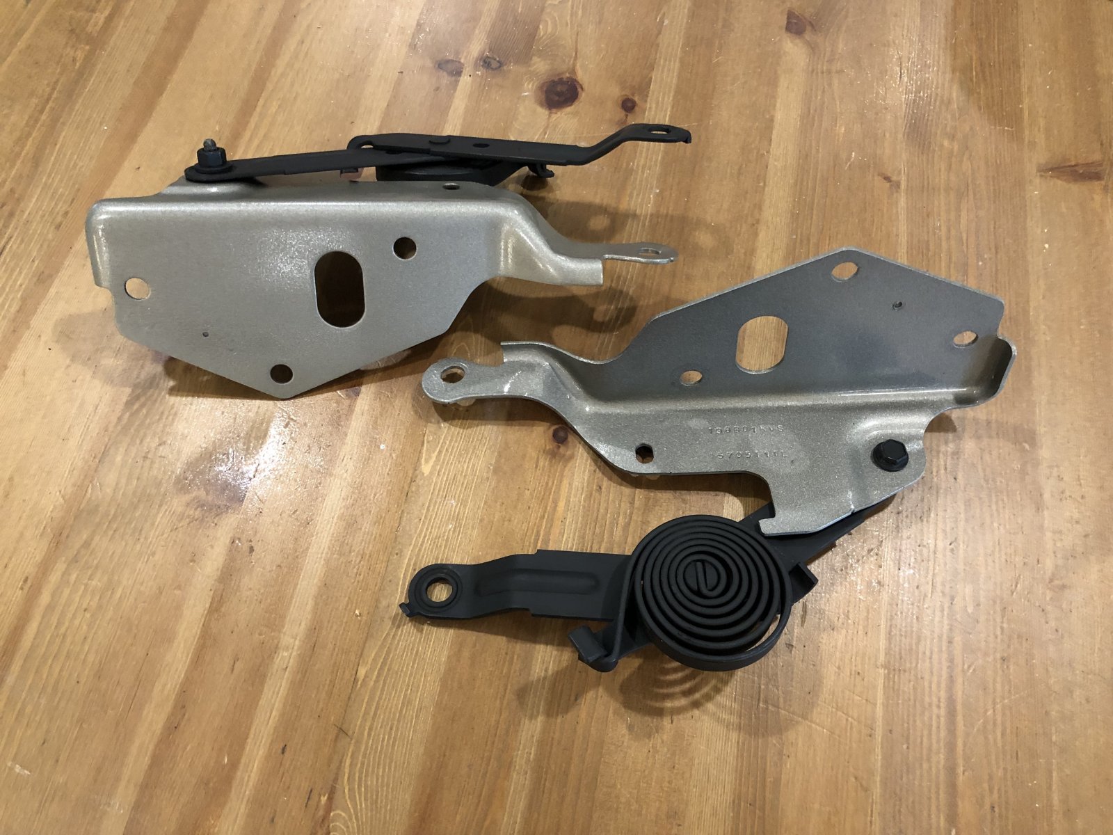

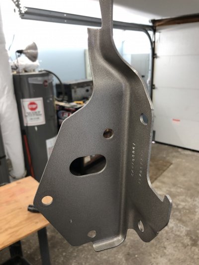

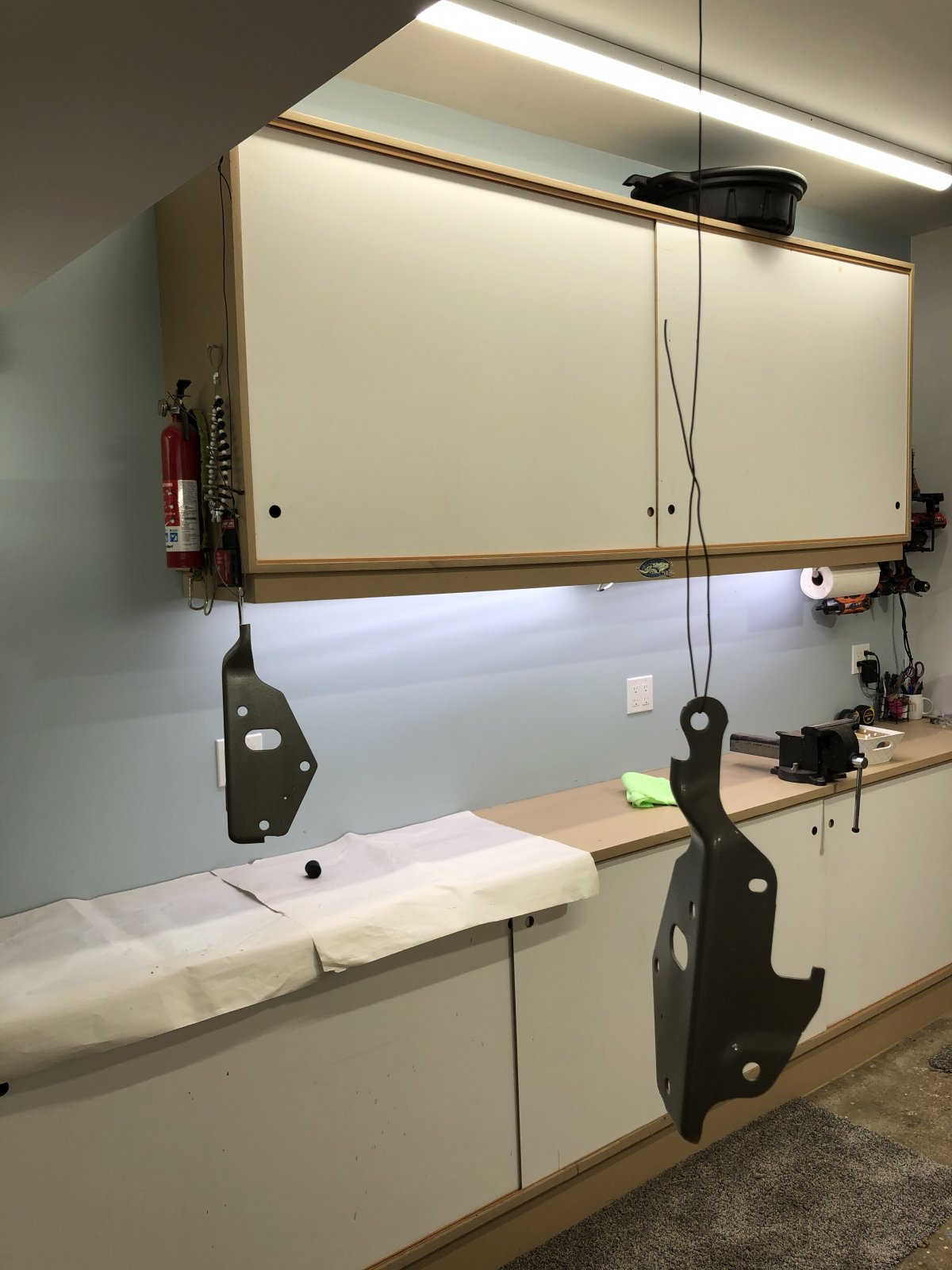

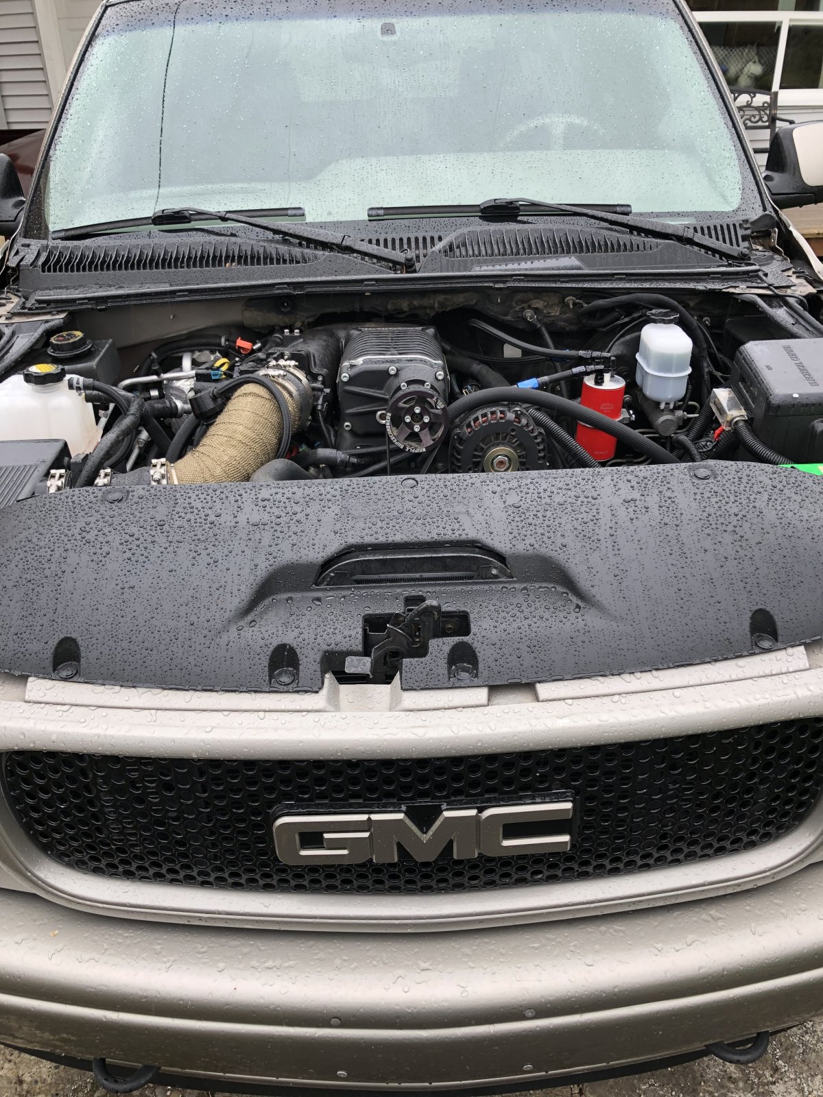

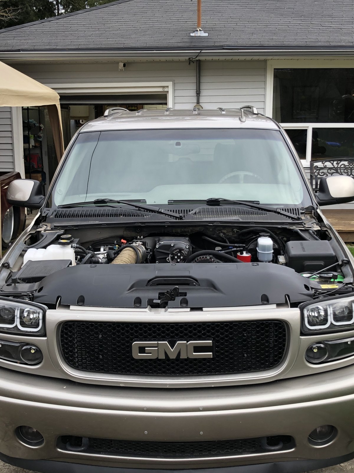

Dropped the hood off yesterday so he can sand it down and primer. He will call me to drop off the truck when it’s time to paint so he can blend the fenders. The hinges had some rust on top where they contact the hood so I sanded those down, primed, painted and cleared.

you should just leave the hood off imfo

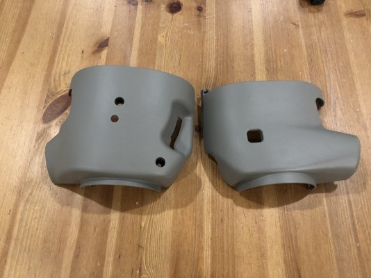

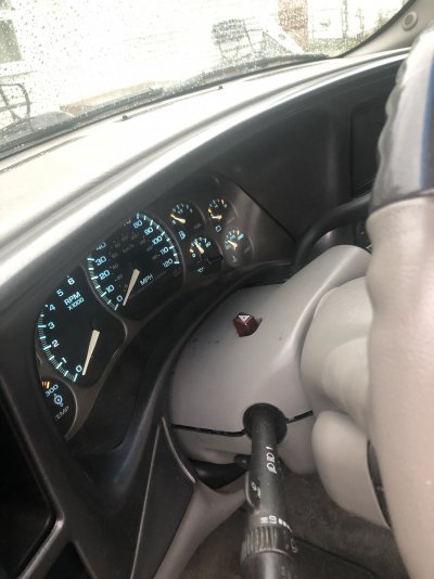

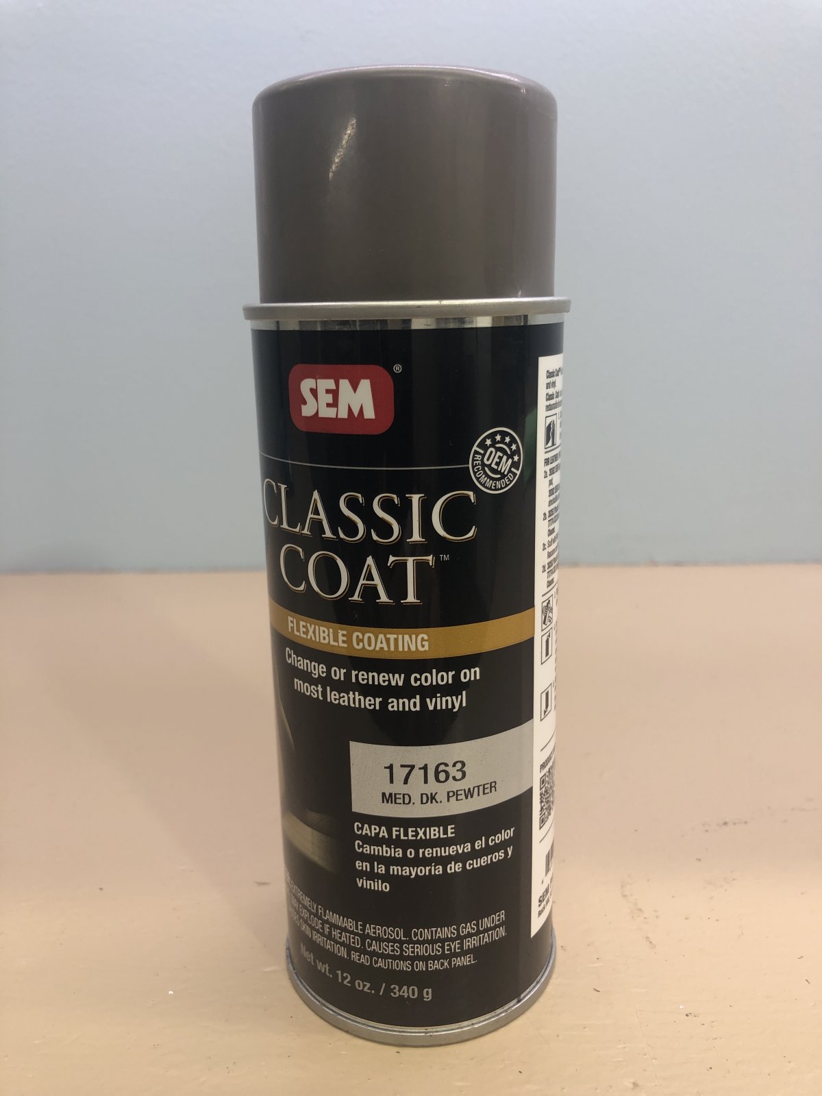

I bought a new steering column shroud and painted it. The one that’s on there now keeps popping open on the left side ever since I swapped out the ignition switch a couple months ago. And there wasn’t a problem with that switch it turns out. I guess I messed up the shroud when I removed it.! You used to be able to but these color matched to your interior but all I can find now is black. I have some SEM just for this purpose on hand. This is the color for the pewter interior in case anybody needs to buy some.

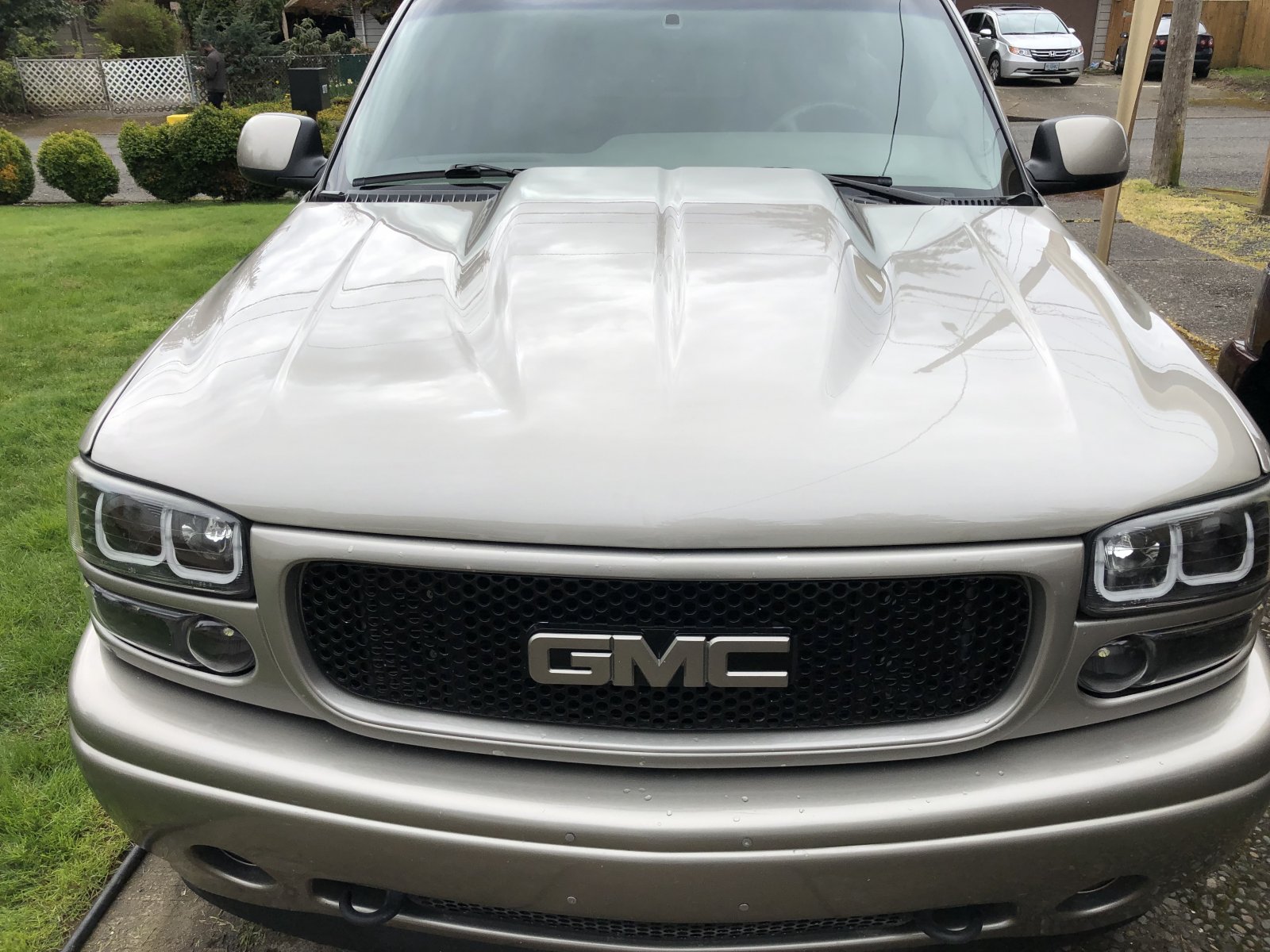

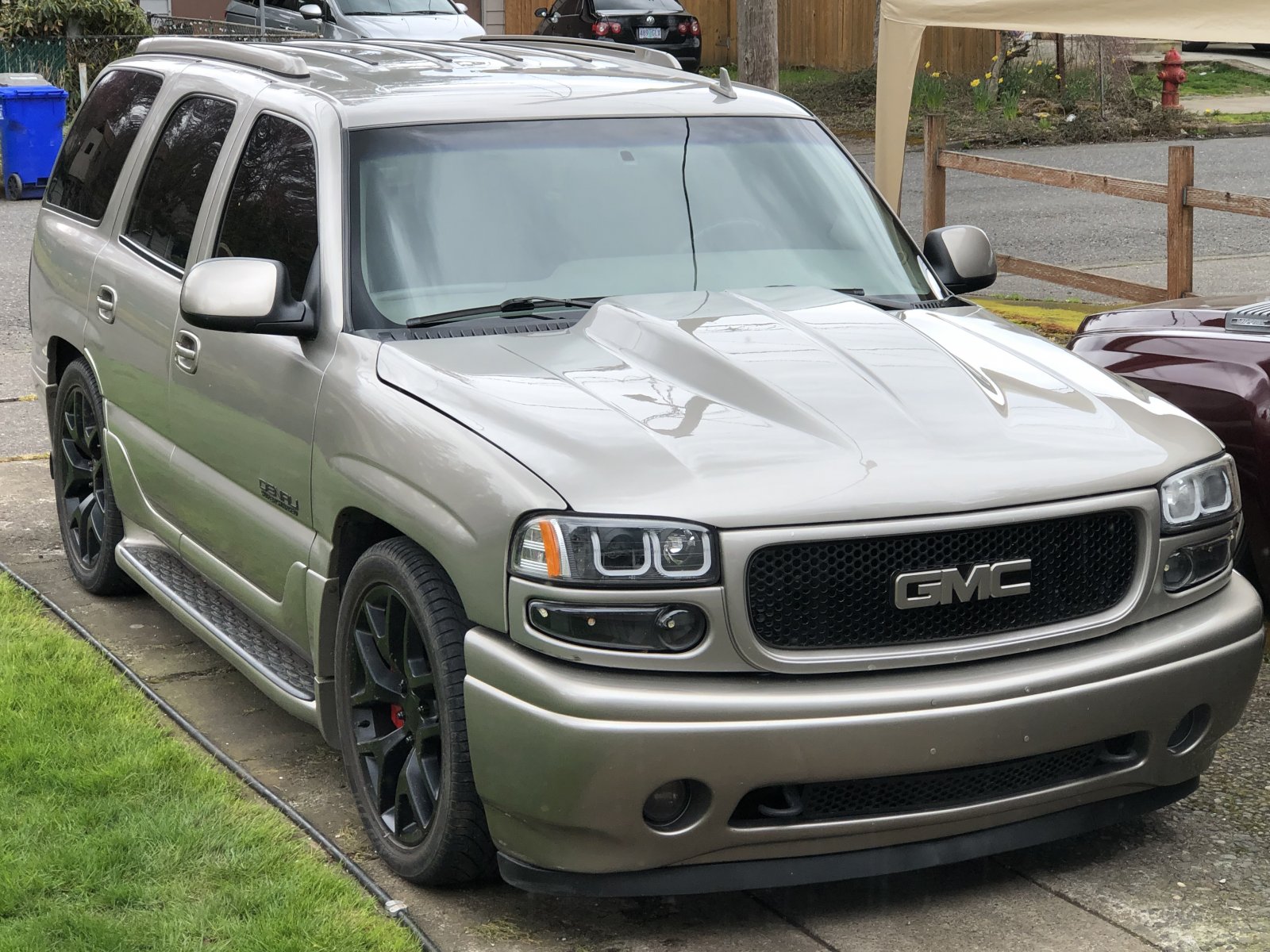

And my body guy had me come by today so he could match the fenders color for the hood. The hood will be ready in the morning. Kind of interesting- he took my paint code for pewter metallic U382 and showed me they provide him with 6-8 shades of that color on swatches so he could hold them up and zero in on the exact shade depending on how much the surrounding areas have degraded from UV and age. Then he mixed up a batch and had his assistant (wifey) hold this bright light up and they both determined it was dialed in to my fenders. This way he won’t have to blend since the fenders aren’t in a plane with the hood. He said if it’s adjoining panels like fenders to door he might still have had to blend but he’s confident in this method for this application. We will see.

My camaro is pewter and them amount of variants for that color is stupid. I'm not doing any blending on my car either, since the hood and spoiler were painted at SLP when they did the SS package on all of the camaros. It wasn't a perfect match before, so I'm not concerned with "perfect". We pulled like 15 spray outs and 8 color cards. Zero were a dead match, just using the sun gun (probably the bright light you were talking about). We have to wait for a sunny day to do all of this but its looking like we'll still have to do some experimental tinting when we get it to the body shop and start our sprayouts. We have a base color picked out but its not "yellow" enough. Metallic is great, base color is 95%, but the tint is slightly off. I'm not looking for perfection, you'll never get it without blending, but I want it as close as I can get it. The way the hood lines up with then fender on your truck, it should be fine. My car has about 4" of fender on the same plane, so I'm sure it won't be a perfect match. Again, they weren't perfect when they shipped to the dealers so I have that going for me!

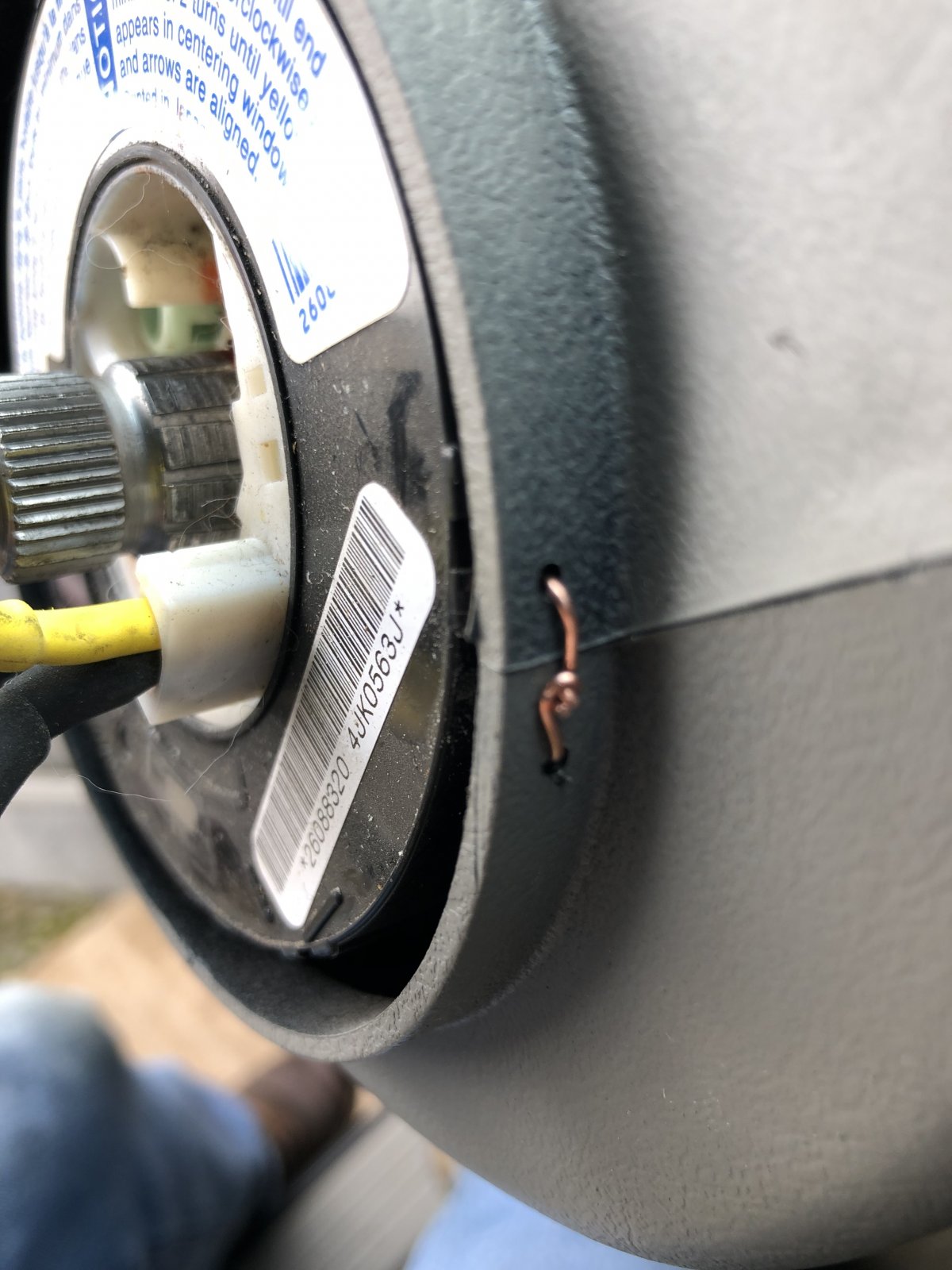

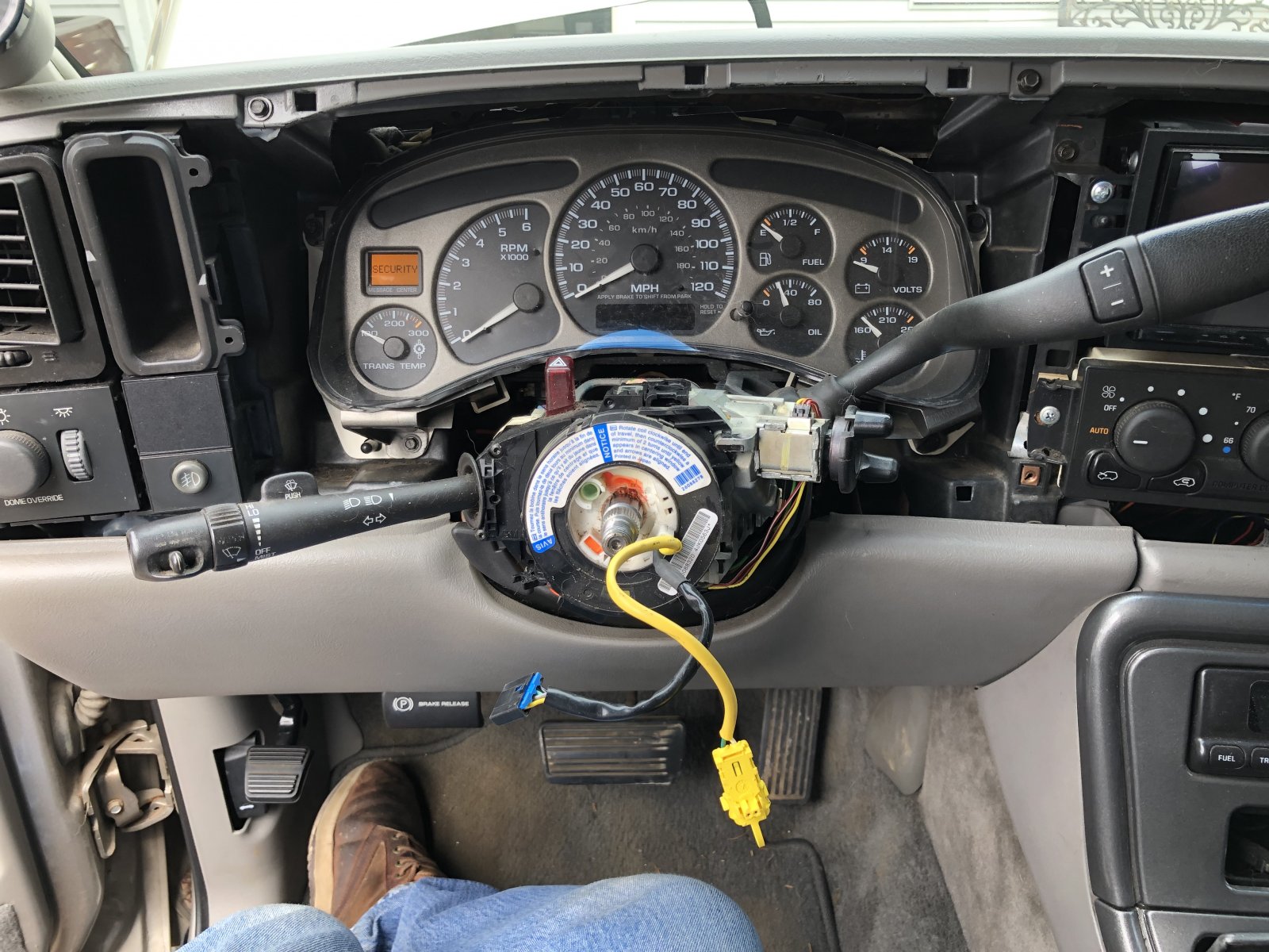

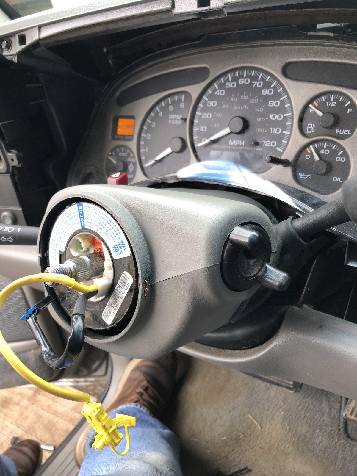

After I brought it home I decided to tackle the column shroud. What a giant PIA. No wonder I broke the other one when I removed it to replace the ignition switch without removing the steering wheel. I pulled the wheel this time and I still managed to break one of the clips on the new one. I ended up stitching the right hand side with a tiny wire. Can’t see it with the steering wheel on. And while the wheel was off… cleaned the grime off it.

I approve of the MacGyver repair sir. :favorites37:
