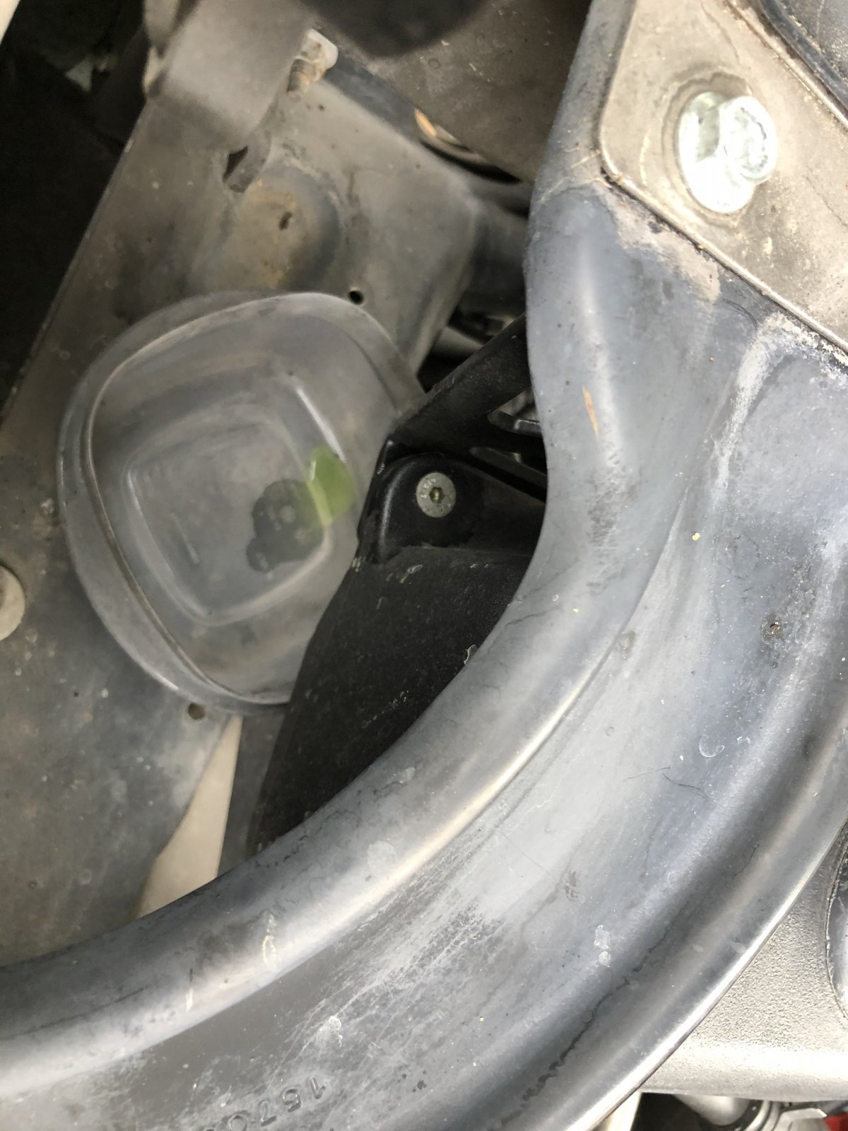

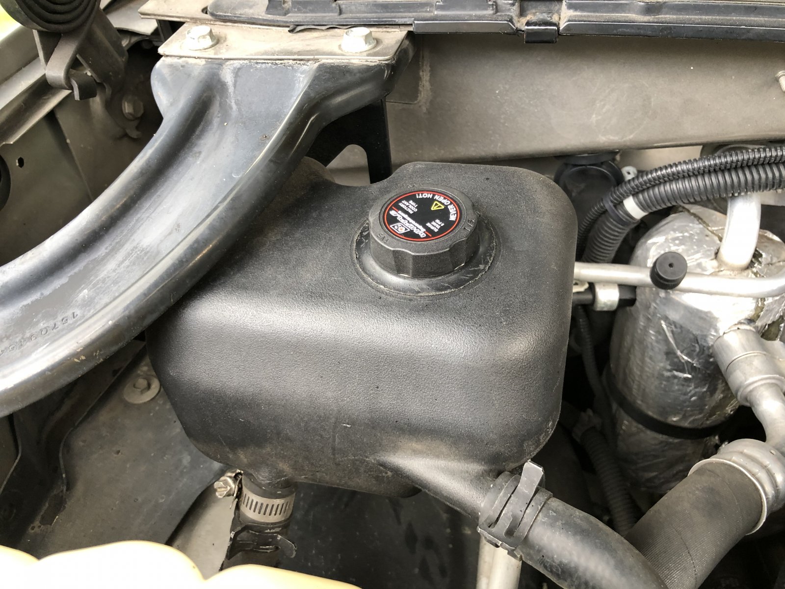

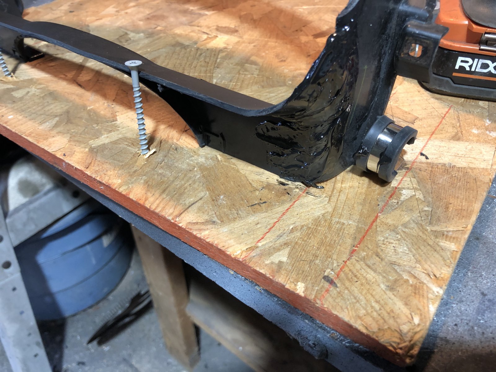

Thanks Chase. Well it looks like the reservoir tank for my intercooler has developed a leak. I don’t even know for how long, I haven’t checked the coolant level in it for at least a year, maybe two. I only thought about it because @Bombsquad85 saw it in my video and asked what it was which brought my attention to it. I added 1.5 quarts to the system and then noticed fluid on the concrete after a drive. It was nearly where the ac drips condensation on our trucks so maybe I didn’t notice the leak before because I thought that’s what it was. So I contacted Whipple to see about buying a new tank. And of course it’s been changed to a “Filler T” and to swap over it’s a measly $125. Plus shipping. I’m gonna pull the tank and see if I can fix it. It’s a slow drip so it might be hard to find or fix. I got 3 drips after the truck was running for 15 minutes.
4AC2505E-E556-446F-90D8-D72785EA31AA.jpeg 5BE7F82C-53E2-4CAB-822E-B00FA6475EC2.jpeg

I have some Lord Fusor plastic repair epoxy, it’s the best stuff I have found. I found out about it from the bike builders when I cut my Harley fairing and raked it so my headlight wasn’t pointed at the sky when I raked the bike for a 28” front wheel. It had to be the best to hold that plastic together with the way a Harley shakes and vibrates. It never cracked or showed any sign of weakness. My issue I think is finding the leak, it looks like it’s coming from one of the mounting holes and only leaks, barely a drip, when it heats up and the system is under pressure. Whipple said it’s pressurized at 5-8 psi. I’ll know more tomorrow when I pull it off. I forgot to go pick up my 05 hatch glass today so I’m gonna do that tomorrow before I pull the reservoir.

Throw a little air pressure in it and soap it.

ya you could fill it with air and put it in a tub of water, like checking for a leak in a tire, I would try to repair it from the inside, maybe once you locate the precise spot, rotate the tank so that the crack is the very bottom and pour some epoxy inside so it fills in that particular spot, effectively sealing it. just an idea

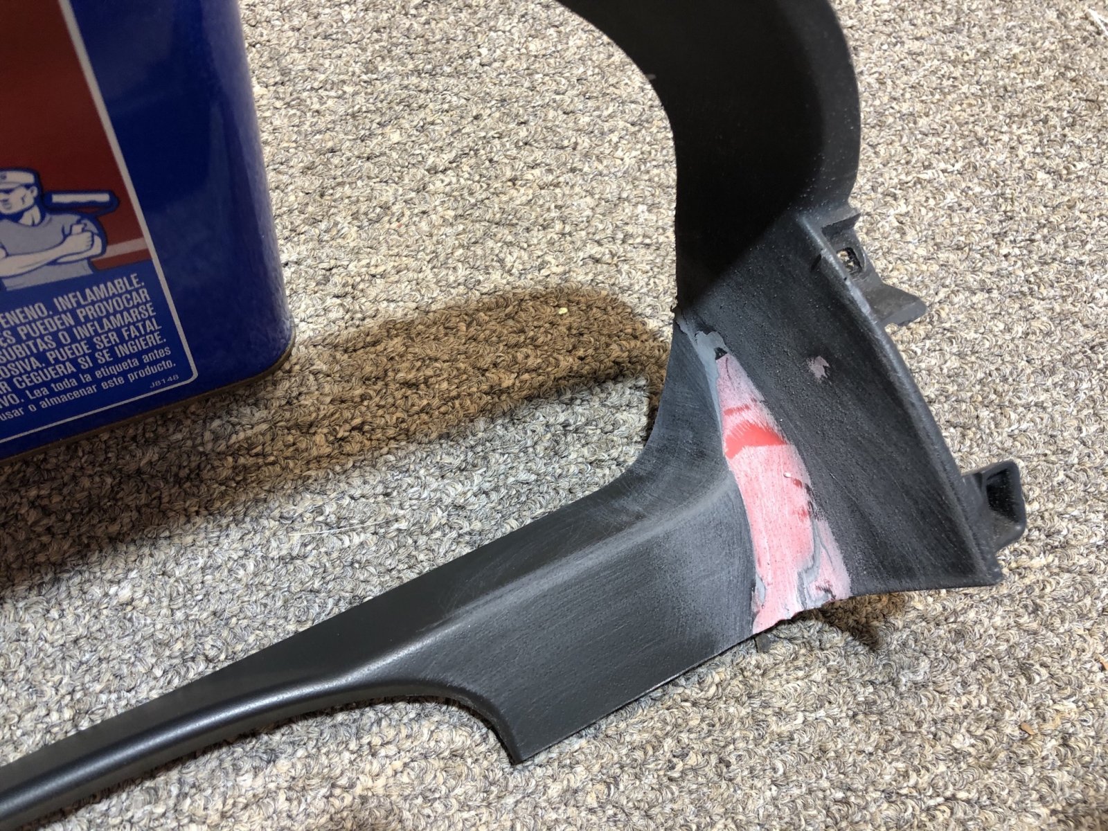

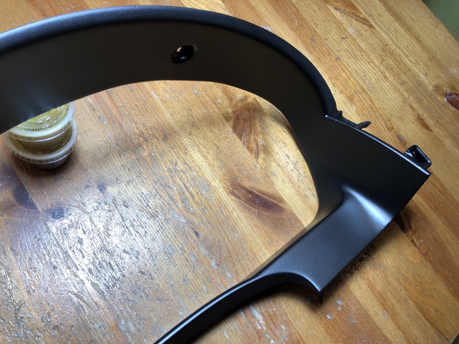

Why did you add Flex Tape? Fusor doesn’t need that. I used their 142 Plastic Repair on my custom cluster bezel for structural and their 114LG Finishing for feathering. And I have bent and twisted that with no cracking or separation. The stuff is awesome.
2100540E-D027-4F13-922D-BAA91B36CFD8.jpeg 76190842-2B0C-4A2D-9BDC-4AAF8FB11F5D.jpeg D93FCD3C-E868-43C5-94C3-5392F4022639.jpeg

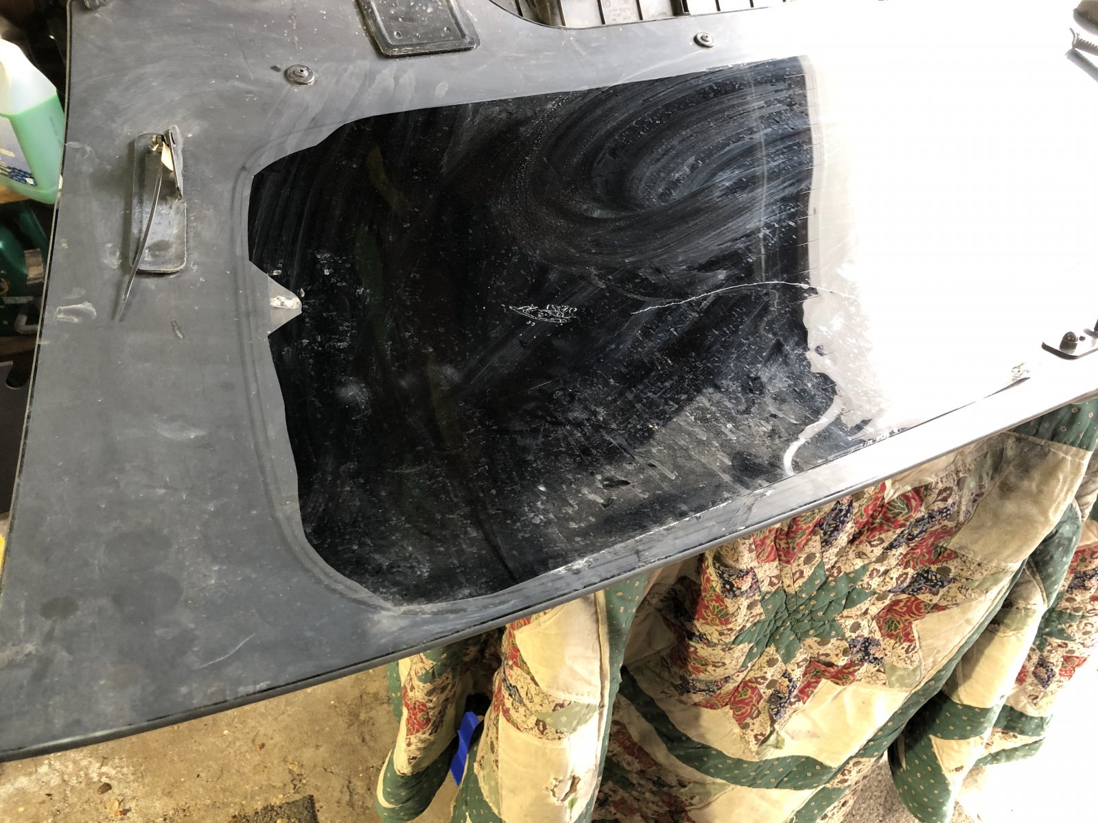

Got the hatch glass. Returned the hatch glass. Ordered another hatch glass. I don’t know how LKQ makes any money.
