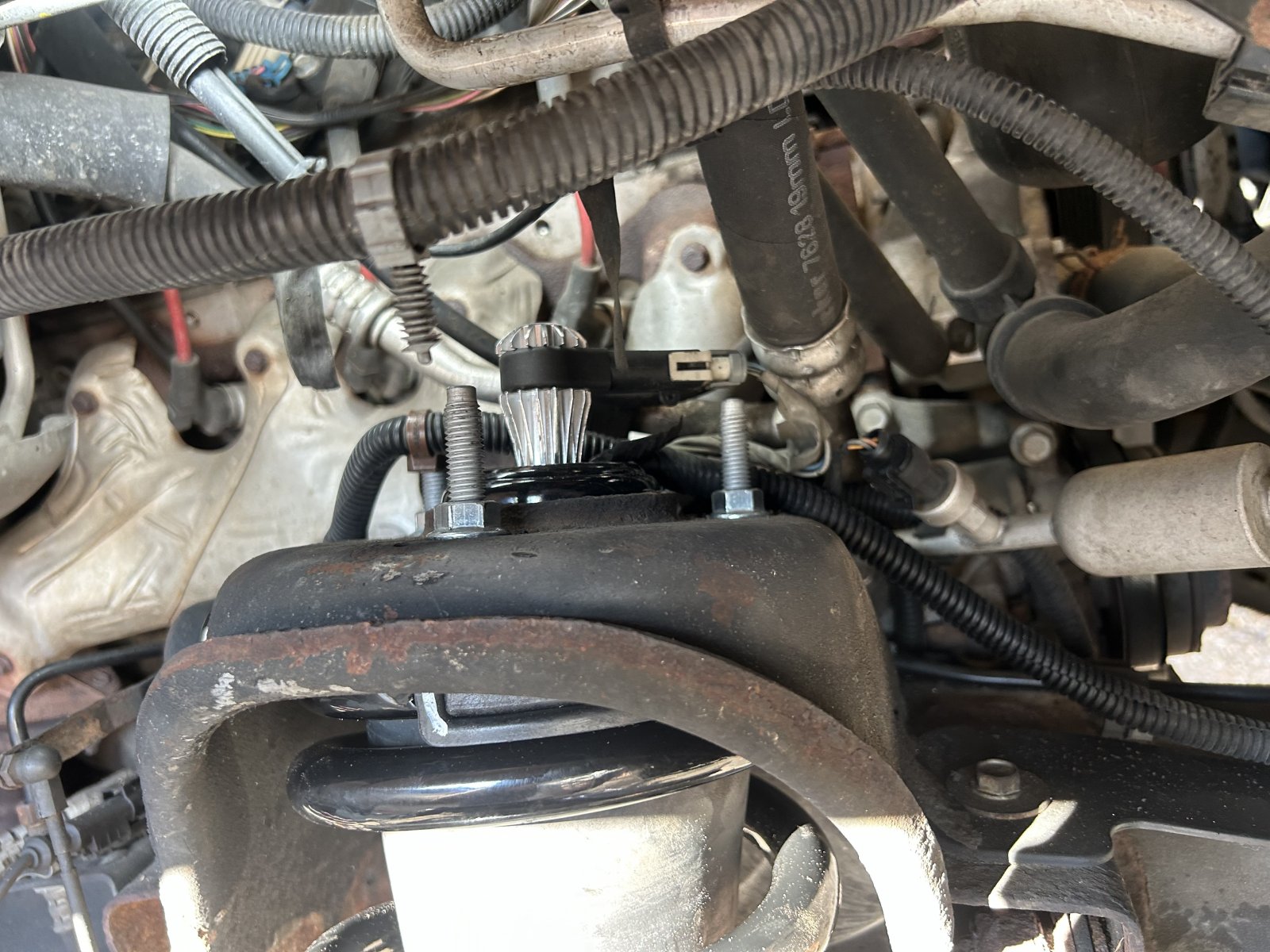

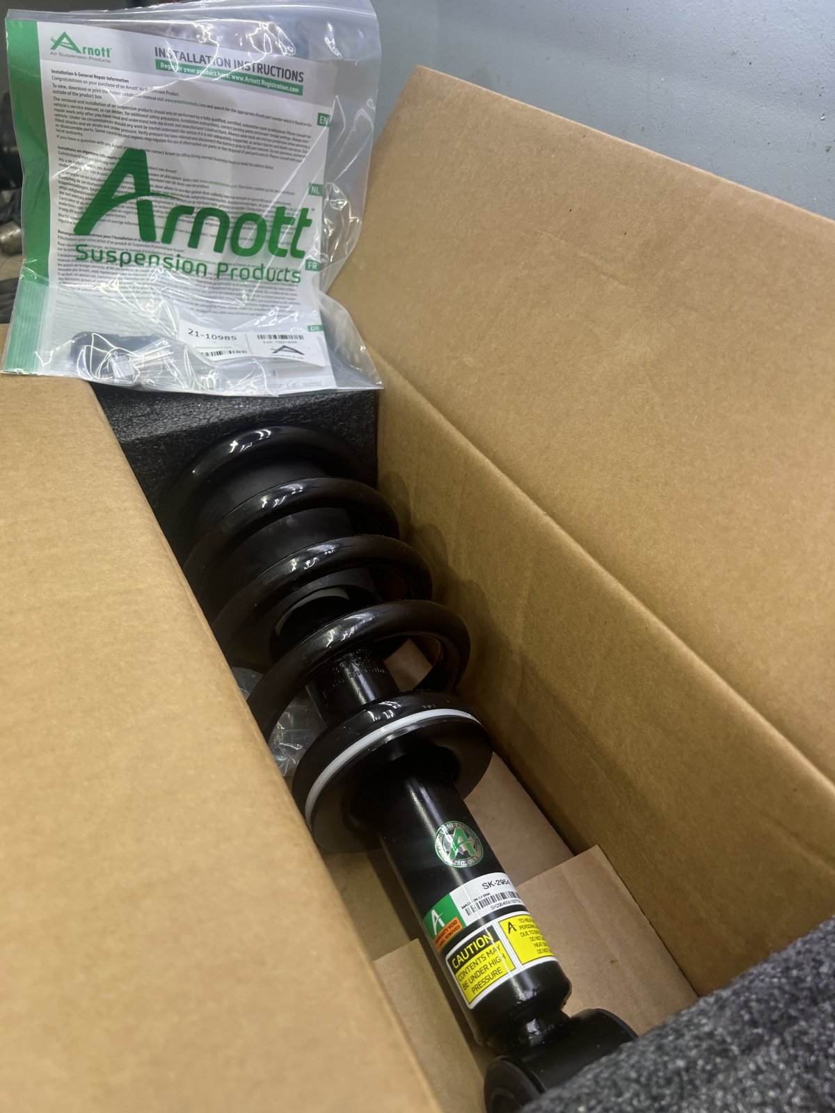

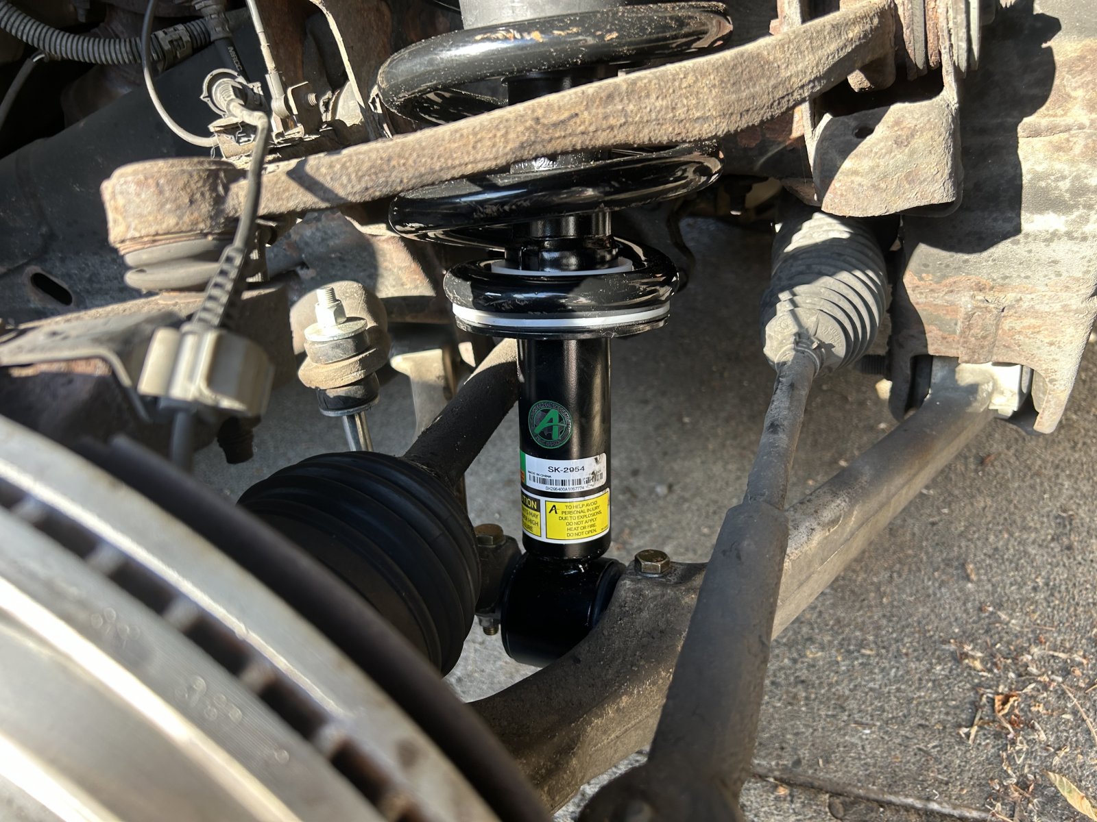

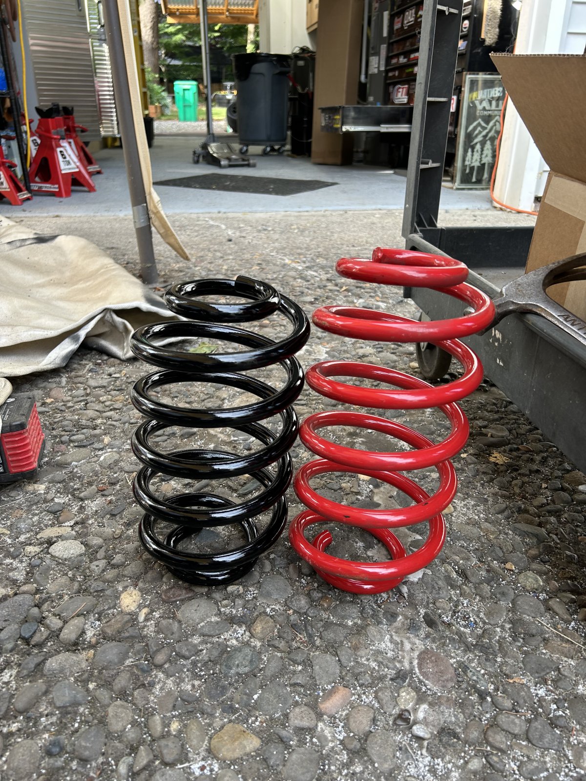

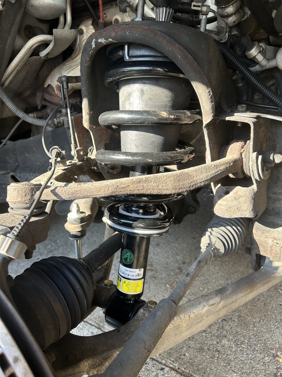

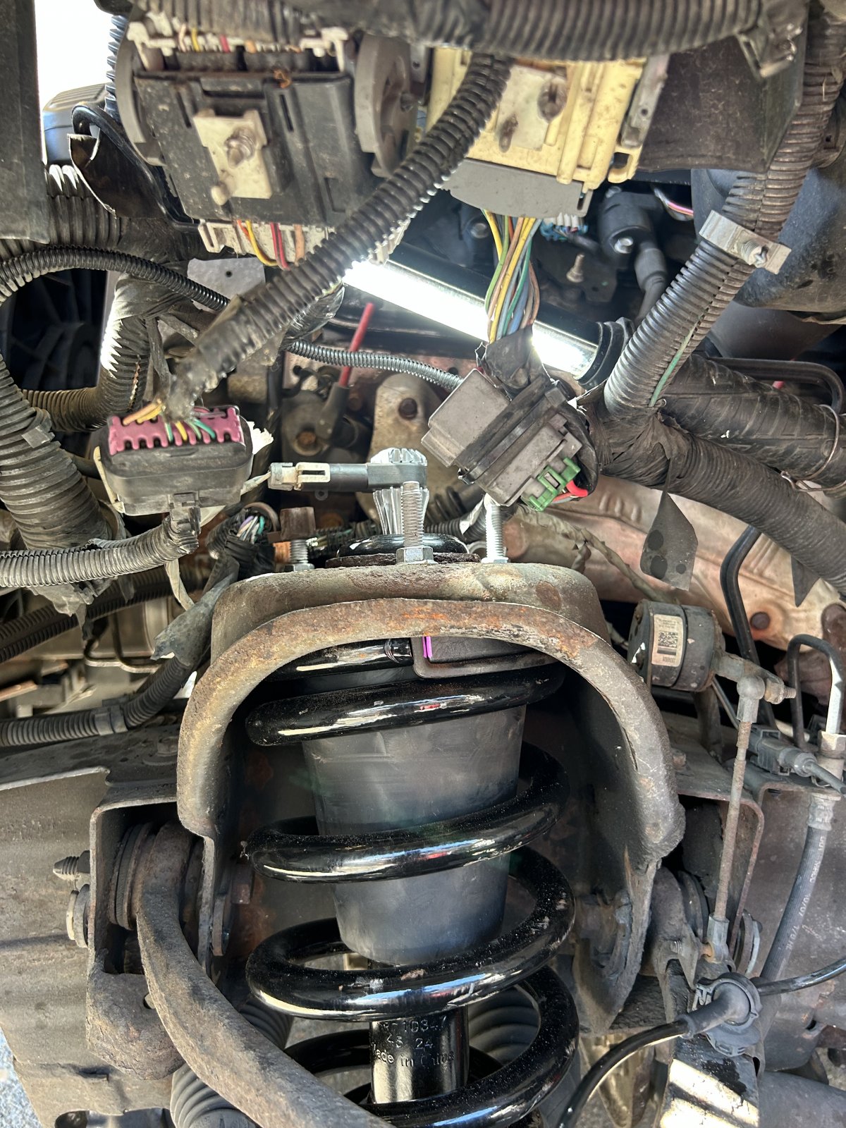

I replaced the front struts with Arnott’s SK-2954 assemblies. Super easy install. They included some nice resistors for spoofing the ride computer. It rides pretty nice now, those were a huge improvement. It does sit about 3/4” lower for some reason. So I ordered some 5” drop springs to swap the 4” drop springs out with. The rear was close to needing to be dropped a bit before but now it definitely does. I need to do the rear travel mod. I bought a plasma cutter but haven’t had time to get into it. I’m trying to get stuff done before this coming Wednesday because I’m scheduled for surgery which is in effect a look see inside my bladder for any remaining cancer after treatments. Hoping for no surgery but I have to be ready. I feel great so we will see. :p

I replaced the front struts with Arnott’s SK-2954 assemblies. Super easy install. They included some nice resistors for spoofing the ride computer. It rides pretty nice now, those were a huge improvement. It does sit about 3/4” lower for some reason. So I ordered some 5” drop springs to swap the 4” drop springs out with. The rear was close to needing to be dropped a bit before but now it definitely does. I need to do the rear travel mod. I bought a plasma cutter but haven’t had time to get into it. I’m trying to get stuff done before this coming Wednesday because I’m scheduled for surgery which is in effect a look see inside my bladder for any remaining cancer after treatments. Hoping for no surgery but I have to be ready. I feel great so we will see. :p View attachment 467959View attachment 467960View attachment 467961View attachment 467963View attachment 467964
Good luck on the exploratory surgery Mark. Hoping for the best buddy!

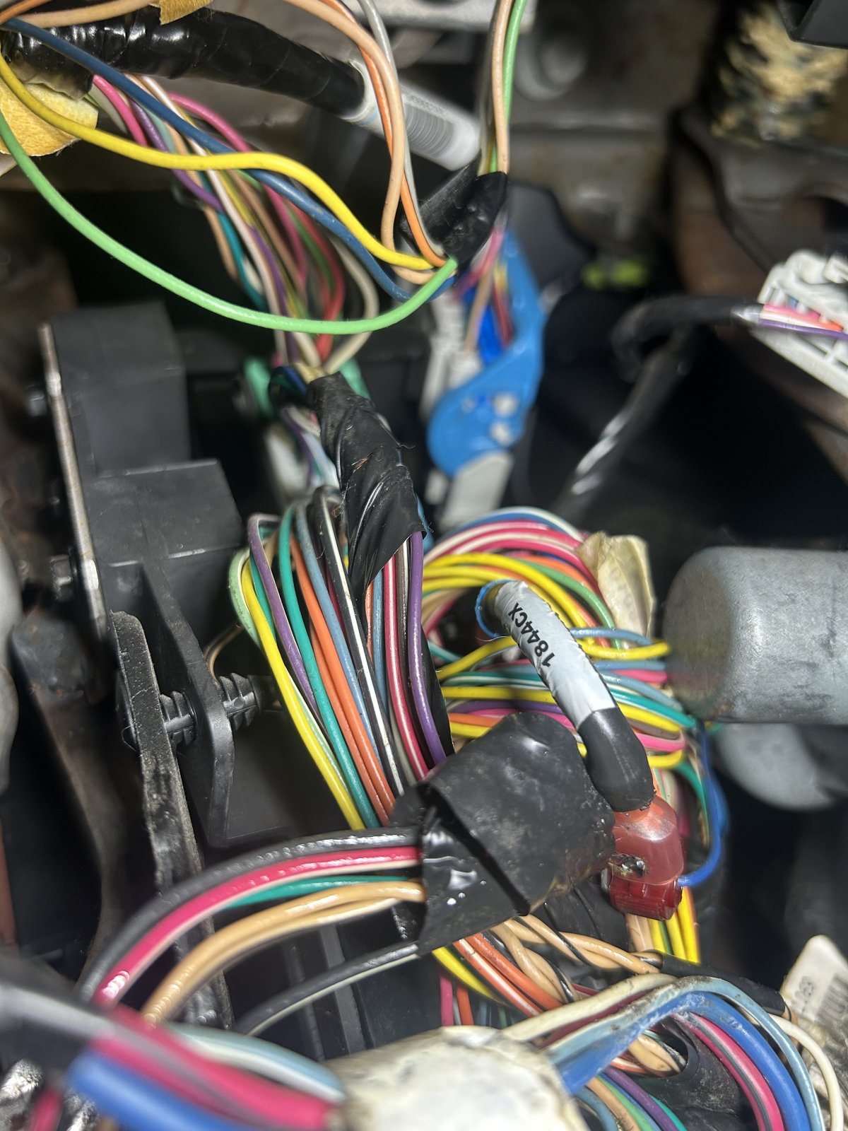

Oh and the Boost Auto auto fog light mod is simple to install. Just follow the instructions on which wires to tap into on the BCM.
This turns on the fogs when the headlights are on when in “auto” mode. Which is where I leave mine set. I like it. It’s probably just a diode heat shrunk with a couple connectors and I paid a stupid price ($35?) for it but it was worth it to not have to mess with finding out how to do this. I did it the old fashioned way on the 02 but there was a clear write up on it. I didn’t see one for the NNBS.

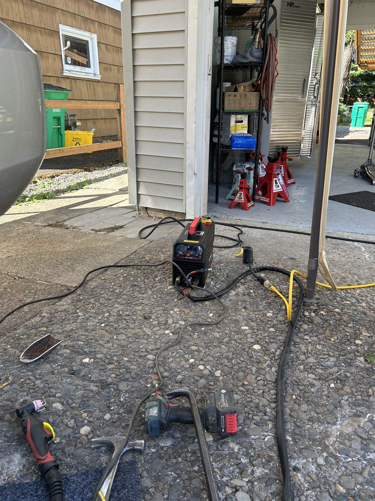

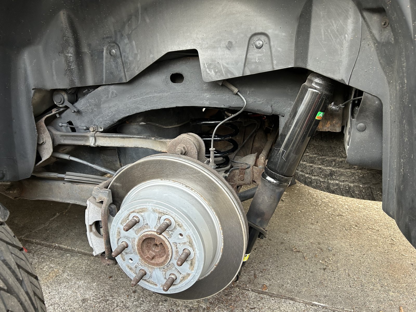

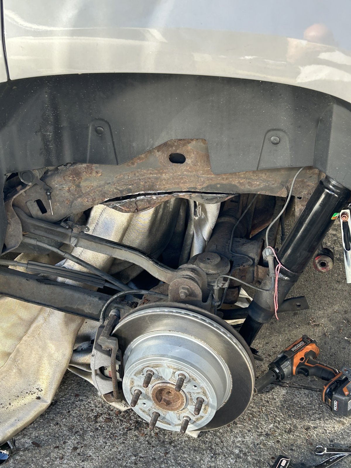

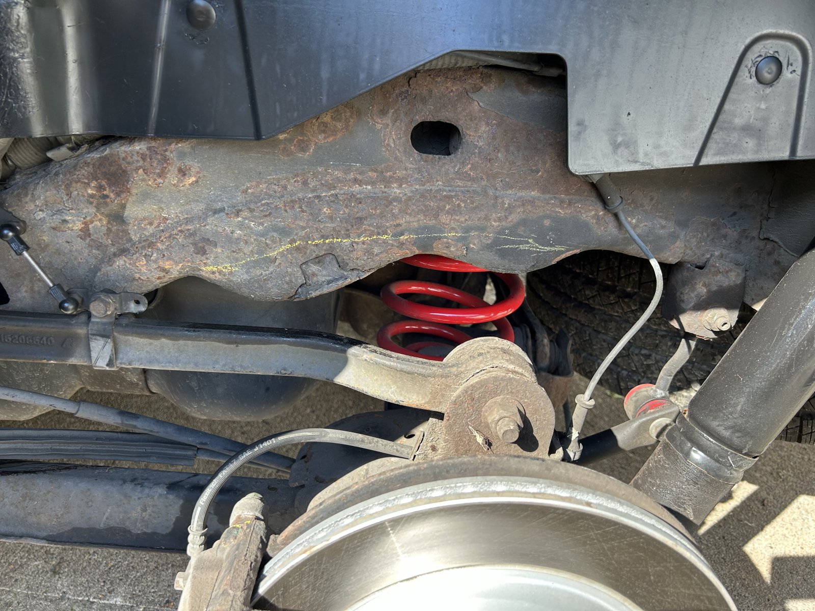

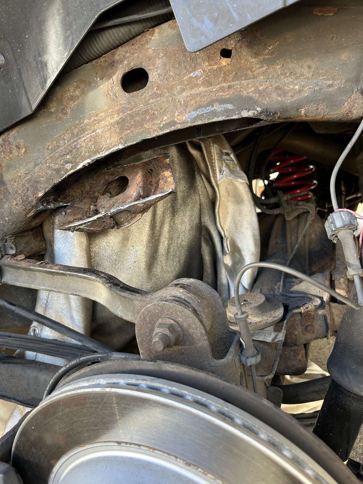

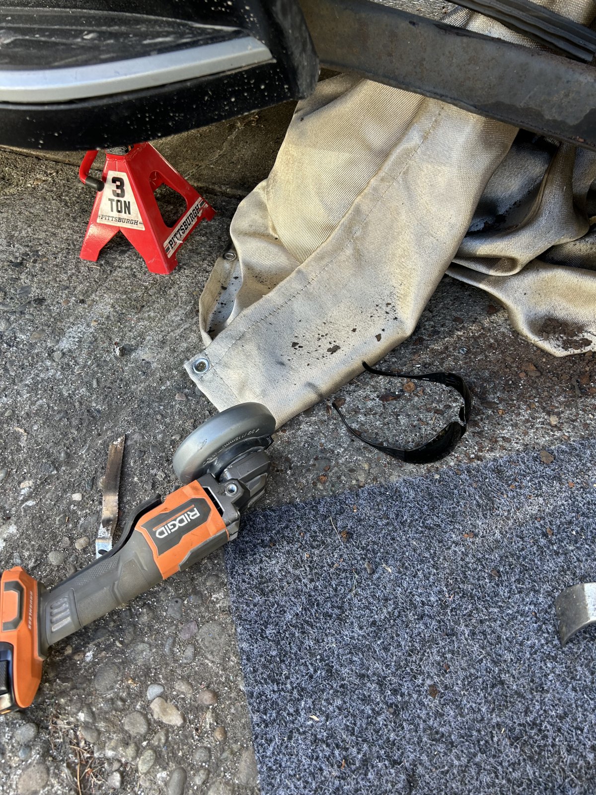

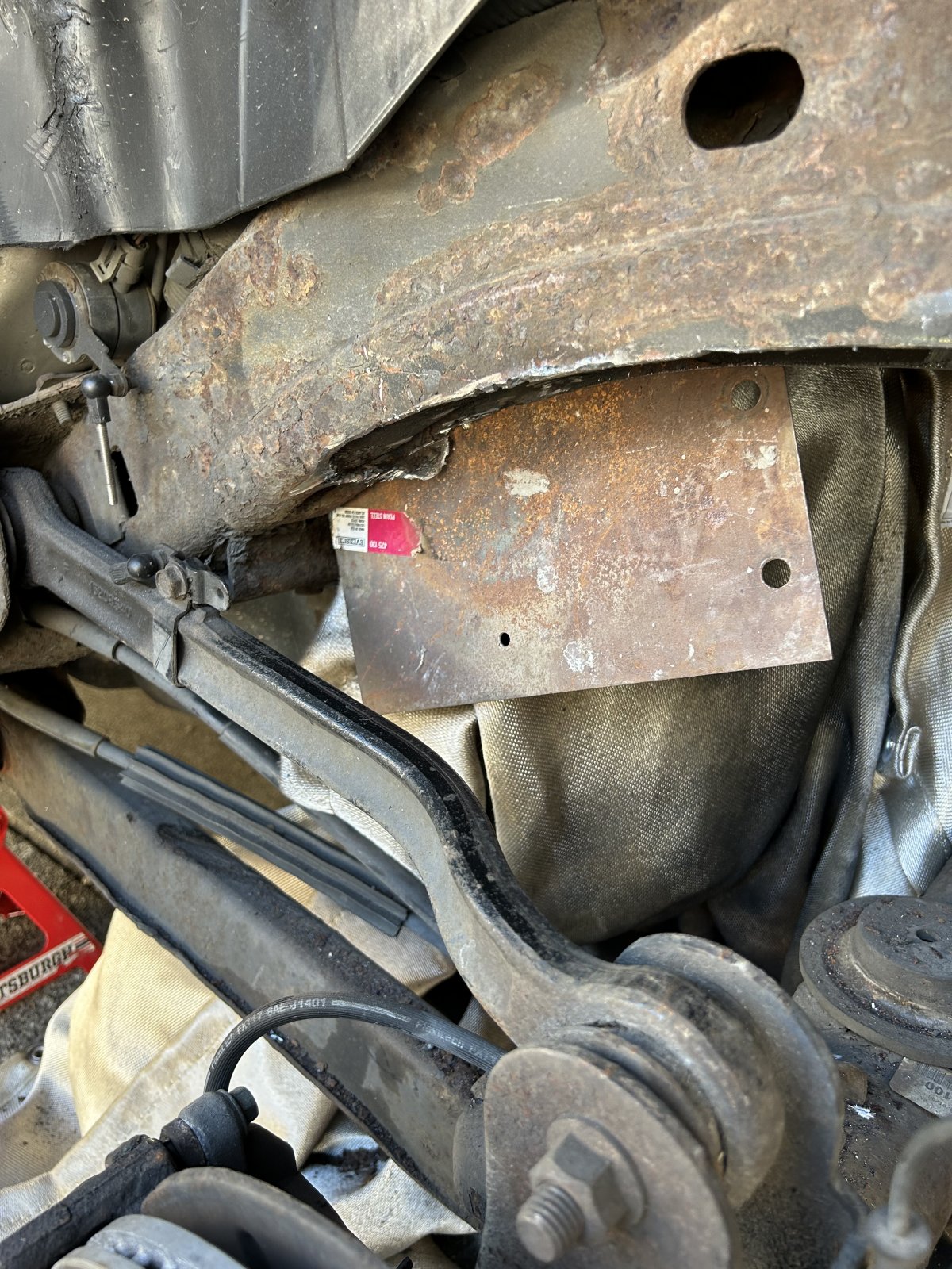

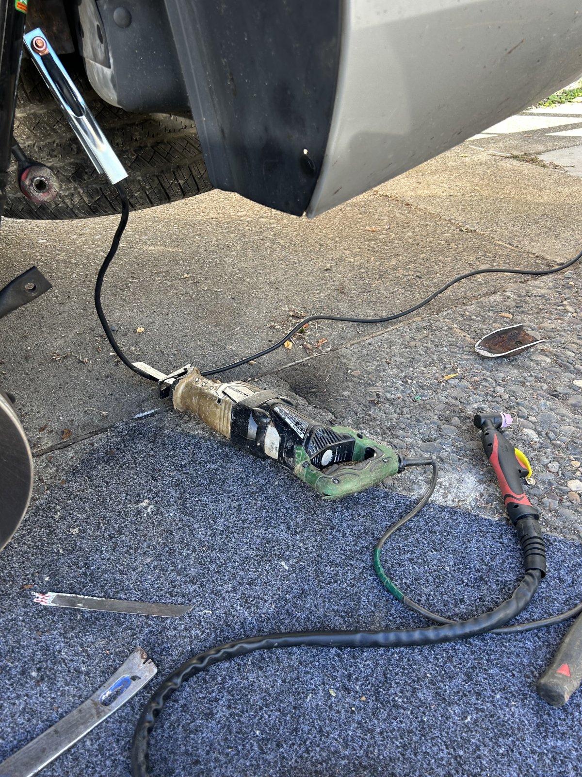

So today I’m back to normal mostly. I decided to start on the free travel mod since I needed to, it’s been banging on hard bumps back there. Also for some reason when I replaced the front coilovers it dropped the front another inch. So I got some 5” rear drop coils instead of the 4” ones in there, to get the back down an inch more too. I got the hard side by the fuel tank done this afternoon. I used the new plasma cutter as much as I could but it didn’t fit in most of those places I needed to cut, so the angle grinder sawzall and prybars helped. Initial measurements after a short ride is 1 1/4” lower. I may be able to adjust the ride height sensor rods and get a bit more. I’ll see tomorrow after I do the other side. I was on doggie duty today too, my friend is in the hospital.

So today I’m back to normal mostly. I decided to start on the free travel mod since I needed to, it’s been banging on hard bumps back there. Also for some reason when I replaced the front coilovers it dropped the front another inch. So I got some 5” rear drop coils instead of the 4” ones in there, to get the back down an inch more too. I got the hard side by the fuel tank done this afternoon. I used the new plasma cutter as much as I could but it didn’t fit in most of those places I needed to cut, so the angle grinder sawzall and prybars helped. Initial measurements after a short ride is 1 1/4” lower. I may be able to adjust the ride height sensor rods and get a bit more. I’ll see tomorrow after I do the other side. I was on doggie duty today too, my friend is in the hospital.View attachment 468304View attachment 468305View attachment 468306View attachment 468307View attachment 468308View attachment 468309View attachment 468310View attachment 468311View attachment 468312
