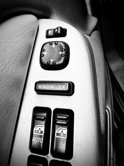

Mirrors- I don’t have the light up middle part on my buttons. And the buttons don’t do anything, so I’m gonna investigate when I go to R&R my passenger side signal mirror.

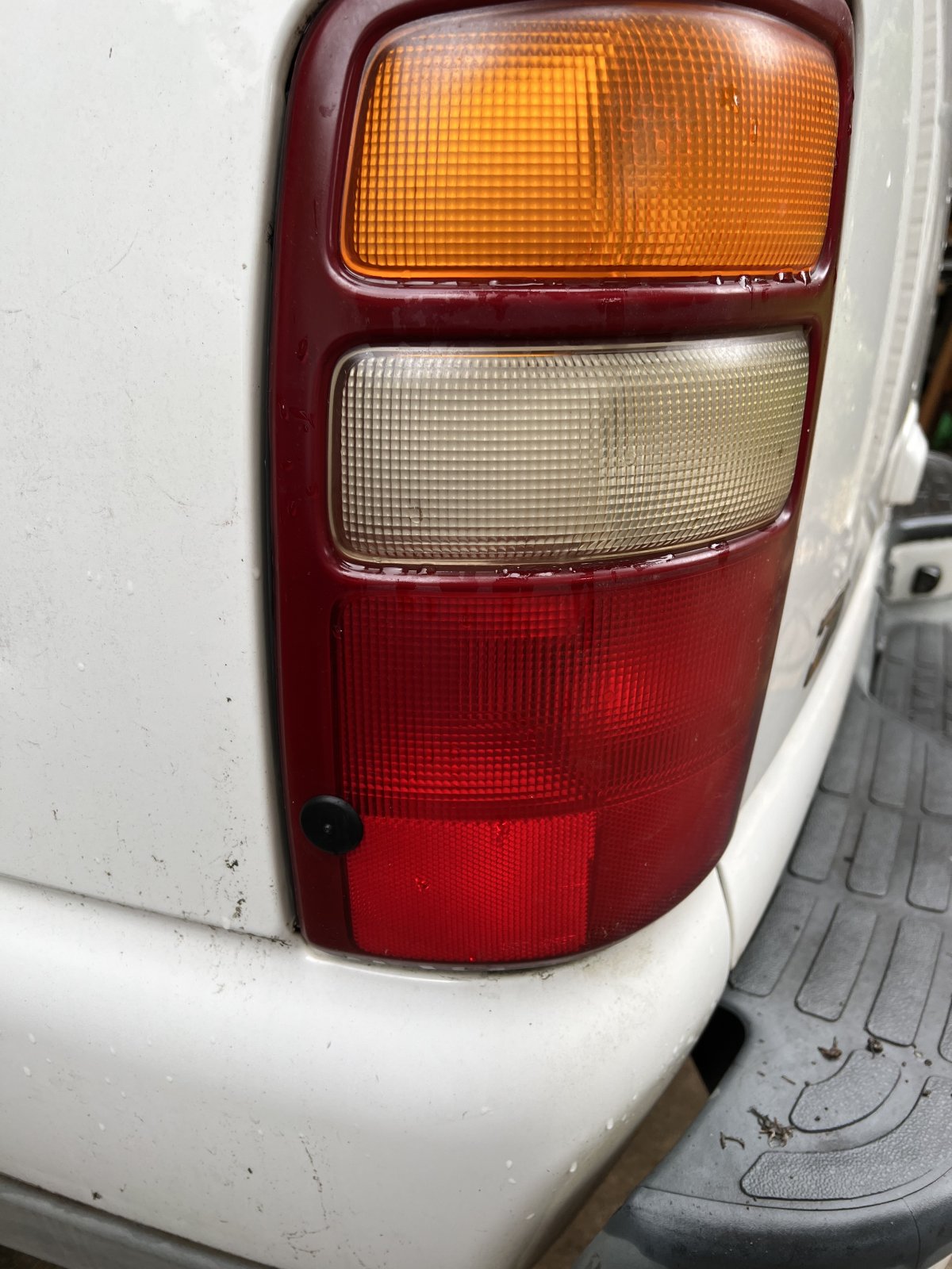

There was a time when it was fashionable to hide the antenna mount between the body and tail light housing too
I pulled the drivers tail light this morning to see if there was anything behind it, because it had this “dot” on the tail light.
Maybe it’s just a mole. A beauty mark of sorts, I dunno. I didn’t see anything behind there.
I'm sorry, mine is an 03, I didn't know yours was an 02. Different electrical systems--and switches.

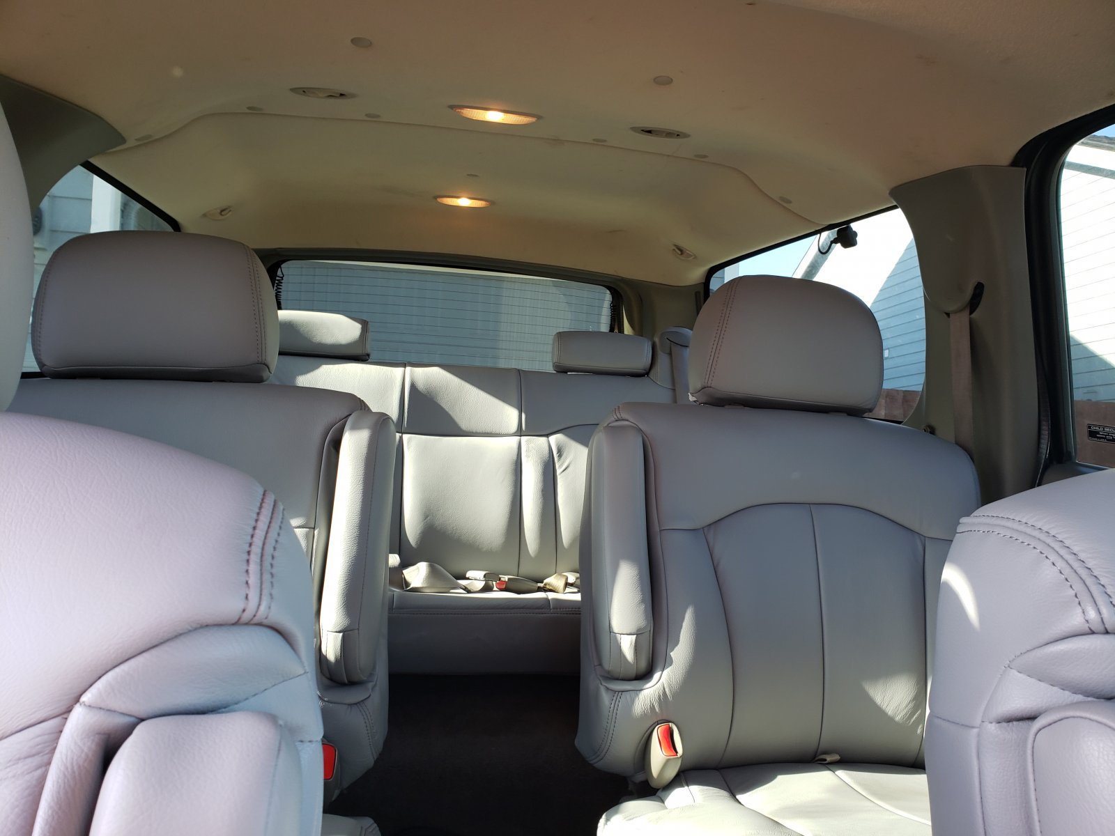

Way to go! Looks great, and you’ve got a rig to be proud of.
I hope to do some sound deadening/ insulating when I get to the point of tearing the interior out. I’m hoping the seats will clean up enough to be a’ight for my use (with the exception of the drivers seat).
I’ve got an industrial sewing machine ready to go, I may try making the seat cover myself. I have some leather samples on the way.
Were the whole seats leather, or only certain parts?? Because mine are a mix. I don’t know if that’s how they were from the factory. I kinda assumed the vinyl bolster on the drivers side was a repair, but then I found the same on the passenger side. Could’ve been a double repair, I reckon.
Leather seating surfaces with vinyl on the sides. That's original.

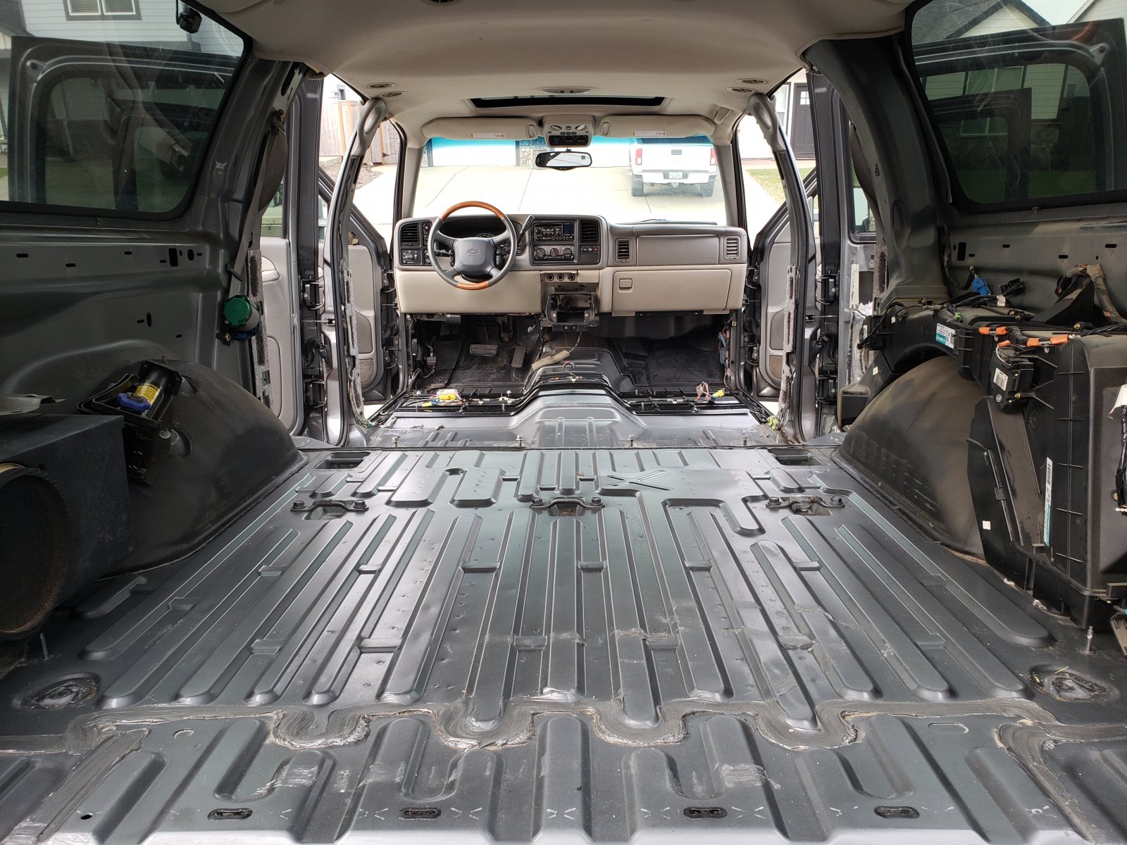

Round four
Maybe there is something in the wiring…
And there was- A LOT!
I removed an alarm system (old Hornet) with windows controller, an XM box that was probably really cool at one point, an air horn, a hands free apparatus, some junk speaker wires, etc.
And to my surprise, it still cranks and runs!!
Question: that cable going under the carpet in front of my console, it was attached to that silver box. What is it, and should it be there? Thanks in advance.

On another note, from the picture you posted of your window switch/mirror controls, that switch appears to be from a pre-2003 truck, and if your burn is a pre-2003!
EDIT: let me correct myself…. Lol tahoes, burbs, and Yukons did not get DL3 power folding mirrors til 2003, however the first Escalade of the GMT800 range, the 2002 Escalade and EXT variants did get power fold mirrors although they didn’t have turn signals. The power fold switch wa s located beside the cluster in the spot where the 4x4 switch controls are mounted in the other trucks.
