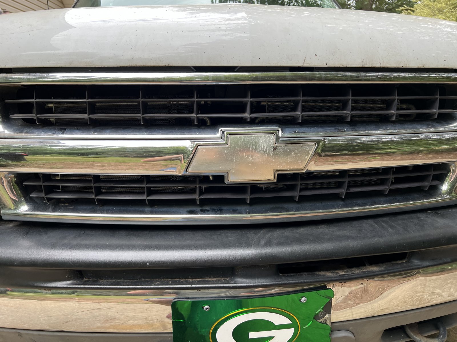

Just wanted to put up a pic of my trans cooler set up. Honestly, it’s probably over kill and will have a negative affect in the winter.
Behind that one beautiful grill is two 1405 trans saver coolers, in series.
“Whoa, Nooj- save some trans cooling for the rest of us”. Yeah, I know.

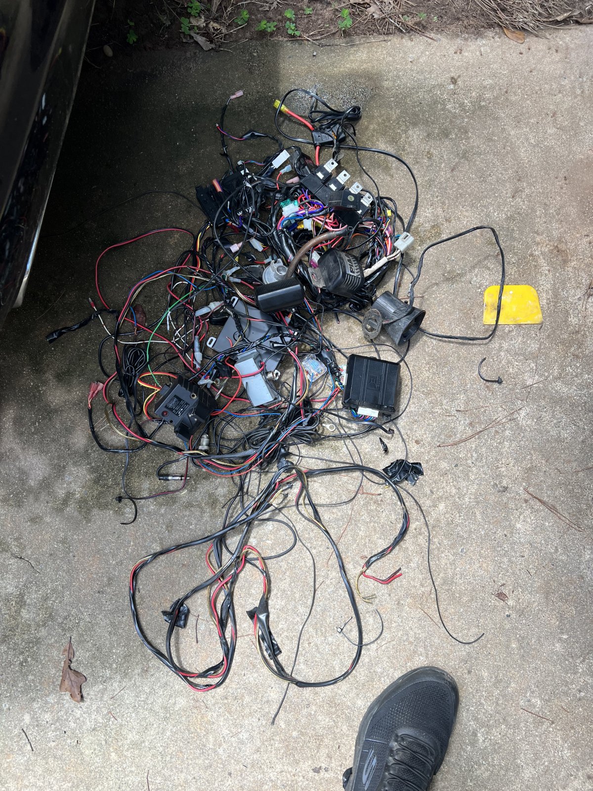

Maybe there is something in the wiring…
And there was- A LOT!
I removed an alarm system (old Hornet) with windows controller, an XM box that was probably really cool at one point, an air horn, a hands free apparatus, some junk speaker wires, etc.
And to my surprise, it still cranks and runs!!

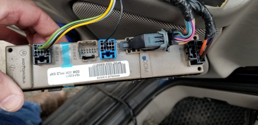

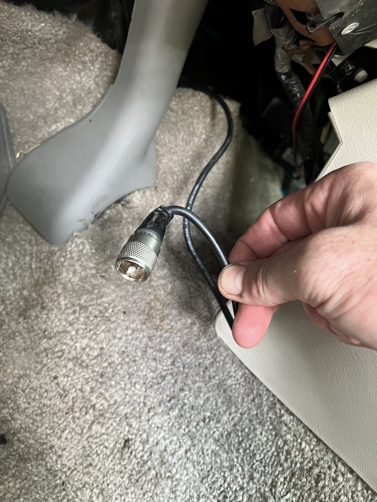

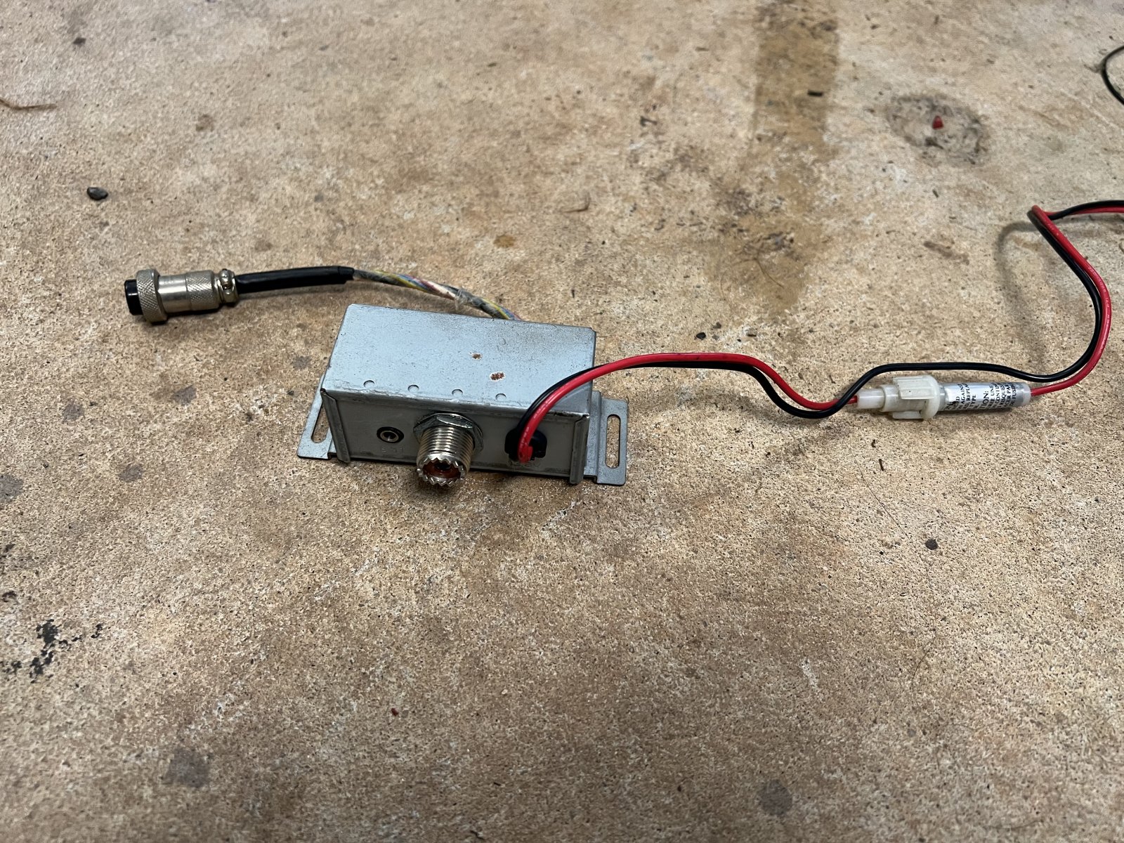

Question: that cable going under the carpet in front of my console, it was attached to that silver box. What is it, and should it be there? Thanks in advance.

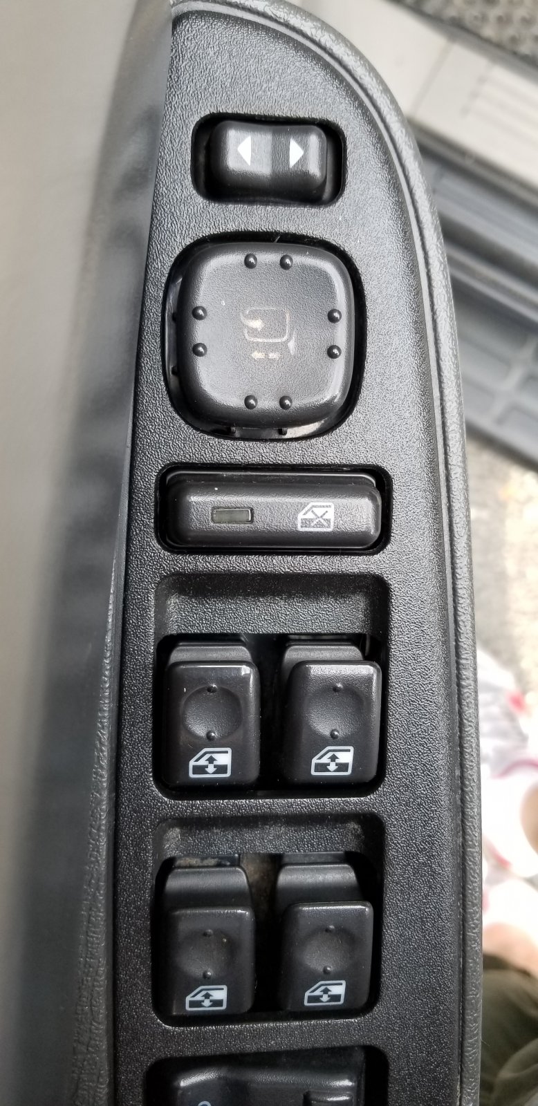

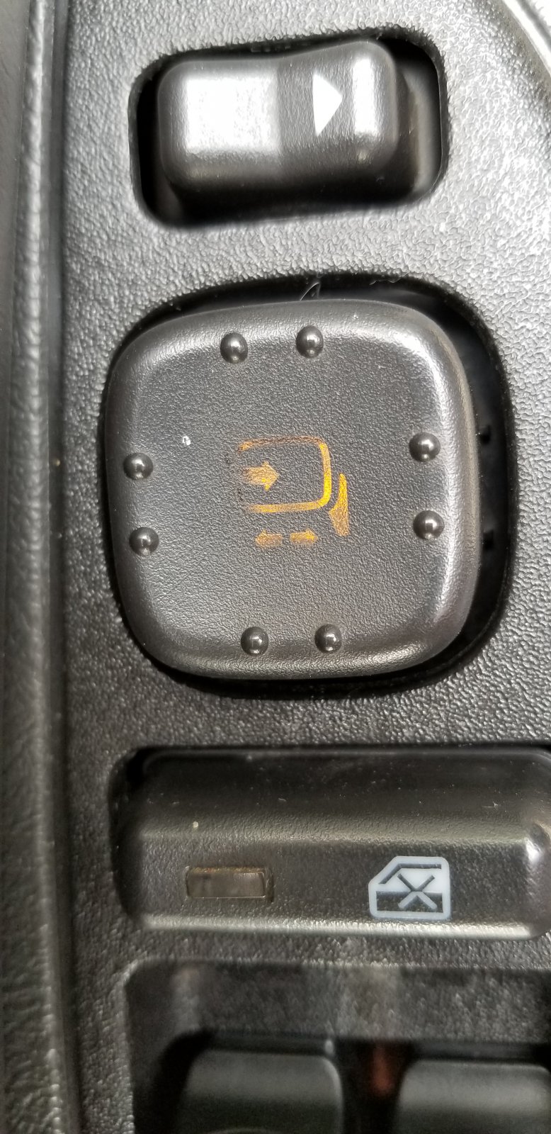

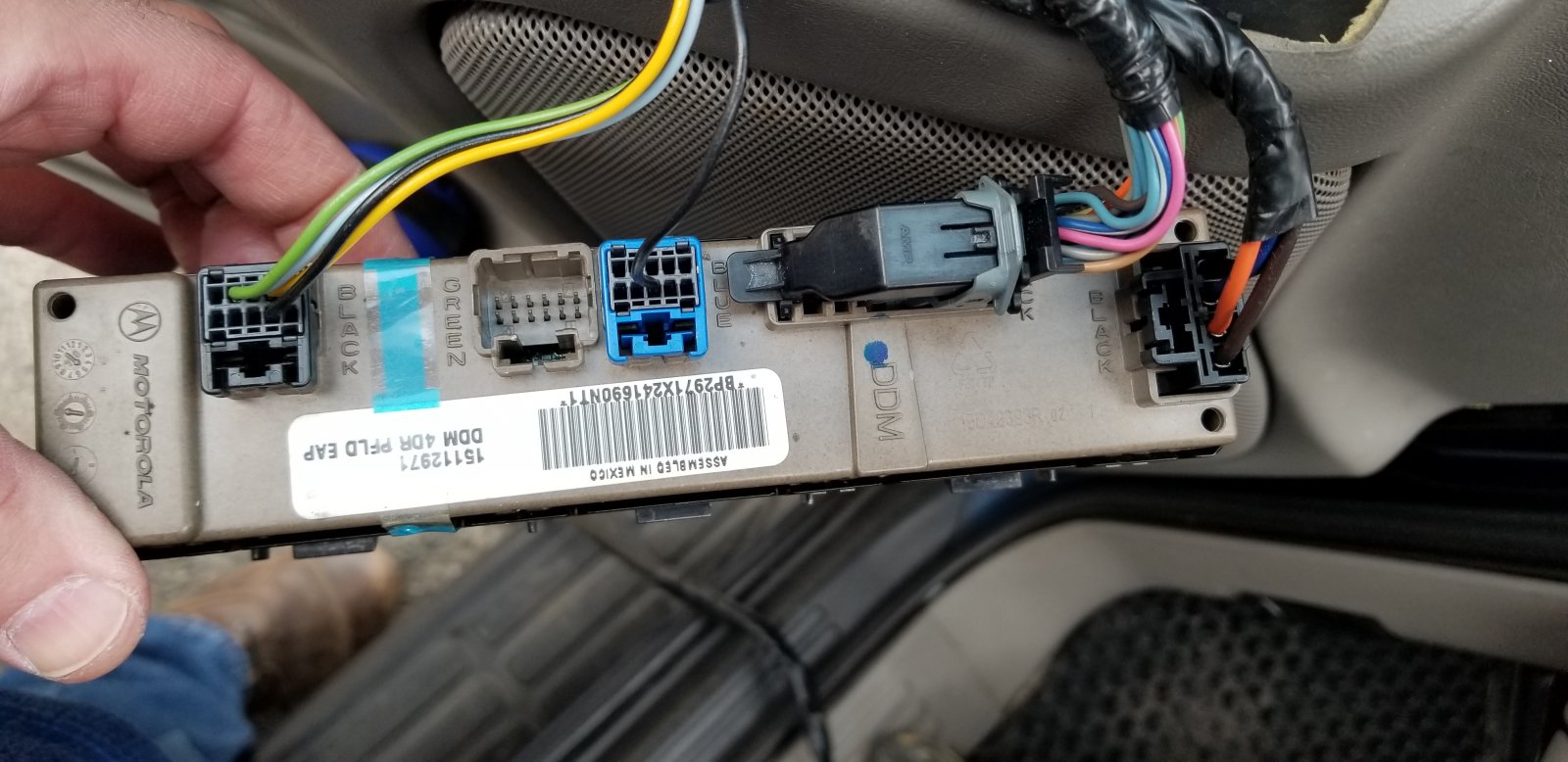

Does your button light up like this if you put the left/right switch in the middle?20180608_170206.jpg20180608_170221.jpg

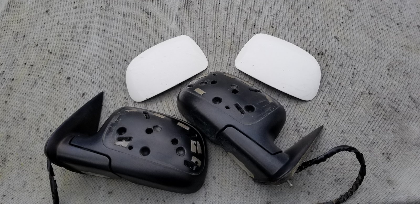

If you wanted to add the powerfold/turn signal mirrors it's super easy to add. Just get the correct mirrors, along with the power window switch from the front passenger(won't work without it), then plug everything into the master driver's side window switch.20190313_161845.jpg
Easy. Added them to my 03, works great.
