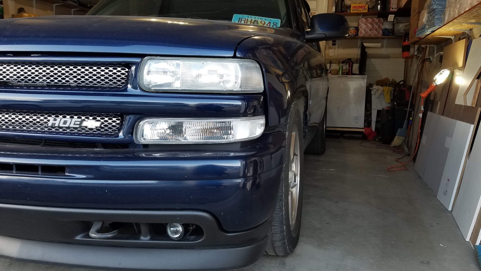

I have hid projector fog lights. View attachment 223011
I would 100% go this route next time. Fogs with a cutoff and serious output would be sweet. High output bulbs in the stock fogs just bleed light everywhere. It would be real tough to get a projector to fit in the rectangular housing on the escalade though.

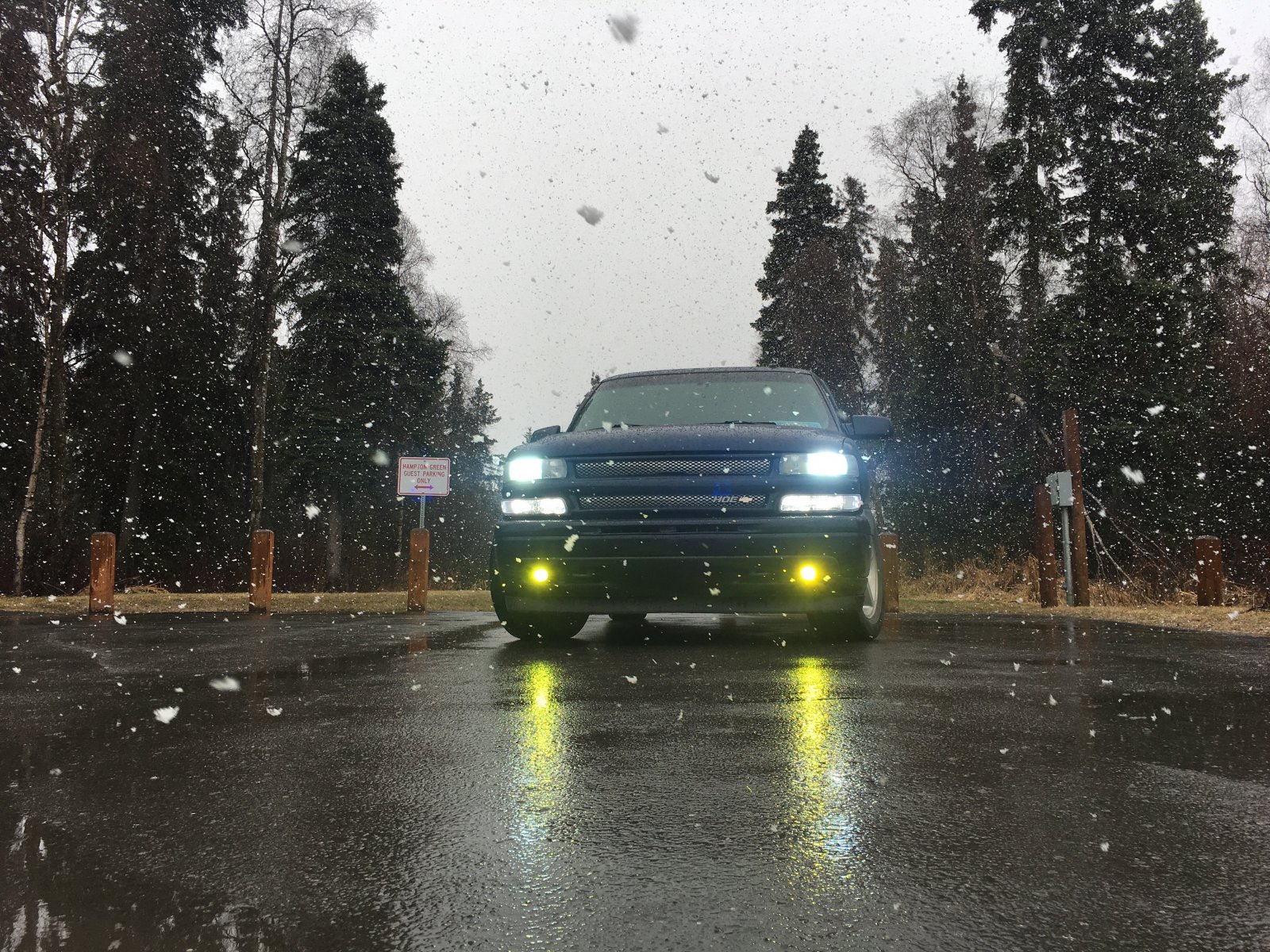

Got them all finished up this weekend!
Off
LED "fogs"
Lows (9011 HIR bulbs)
Lows + LEDs
6 High
6 High again:
Brackets upside down. I can adjust them up/down and left/right and even clock them a couple of degrees.
Much longer wire than necessary. I have it wrapped around a bumper support.
Off:
Wish it had the nice round ones like the z71 and denali bumpers.
These fit in my rectangular opening. Iirc Escalade and Yukon fogs are he same except different mounting hardware

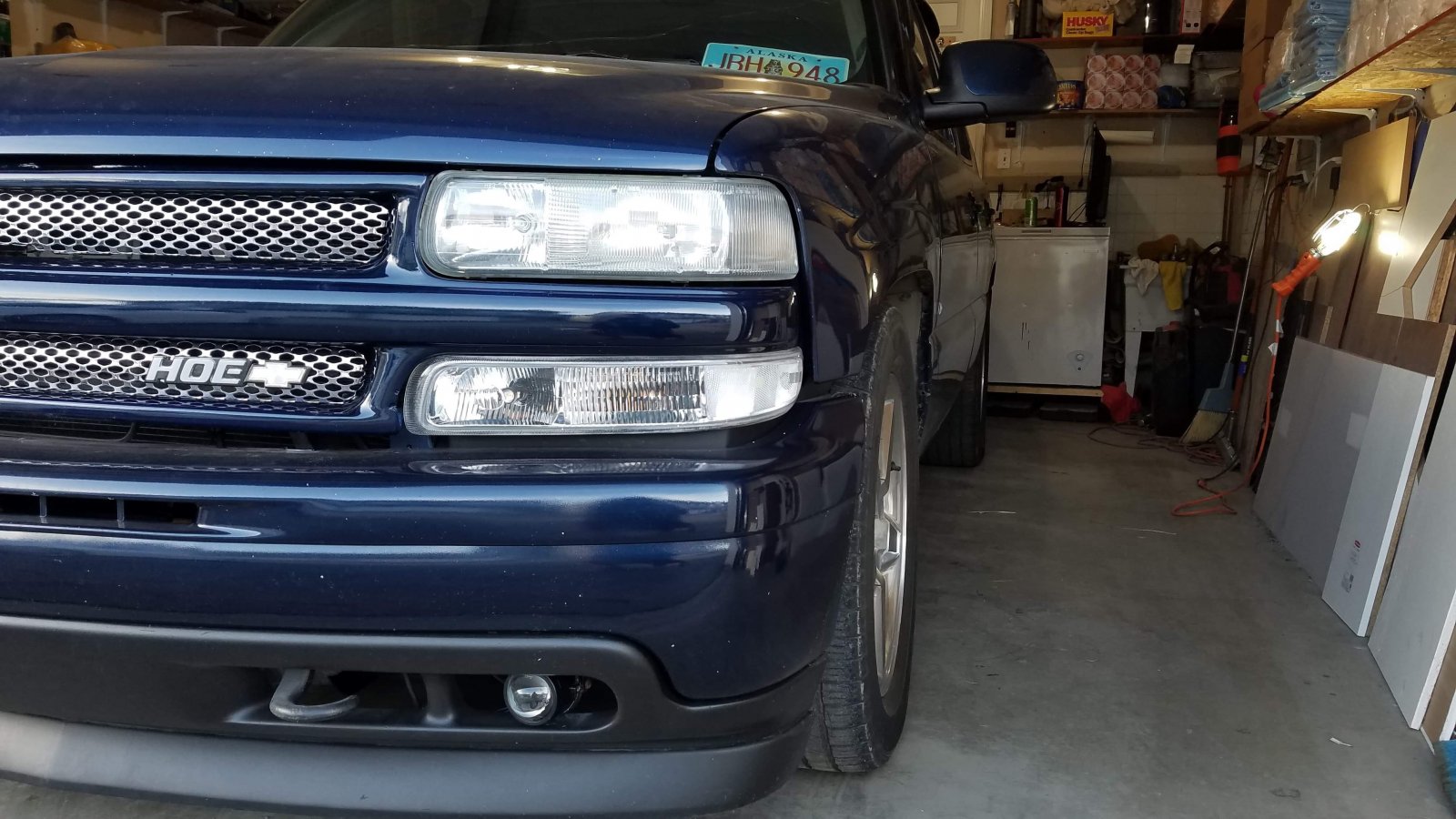

I custom mounted them to the factory bracket. They fit perfectly in the opening. Just barely wedged and snug in the rectangle opening which keeps them from vibrating and flopping around View attachment 223103
OIC That looks quite good on your truck. I fear that If I tried to do that on my esky front it would look like something was missing. I was thinking more along the lines of a typical retrofit where the projector was installed into the housing behind a lense. I dunno maybe im overthinking it and should just try ordering some cheapo projectors and see how it looks lol.
I was wondering if you meant a retro. Yea mine are pretty hidden and I don’t feel like they’re out of place. A retrofit would be super hard in those housings. Up to you , I like my idea and I think they will look good on your esky. Just $50 to try out
