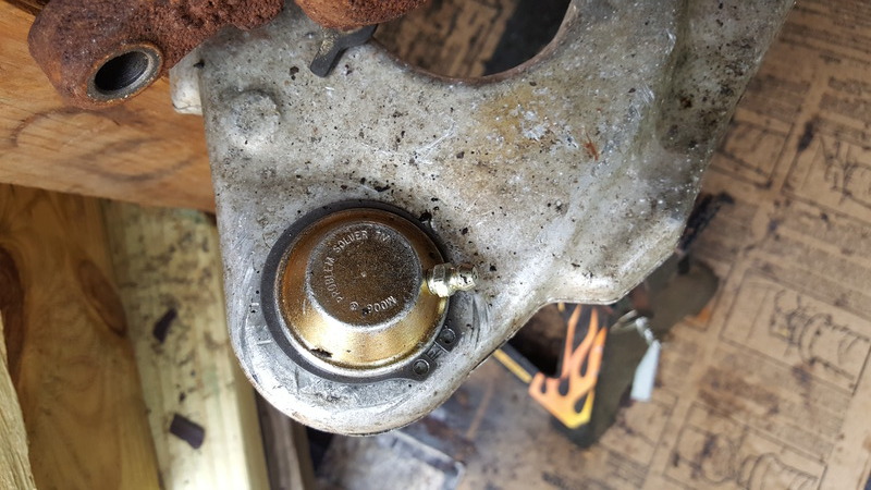

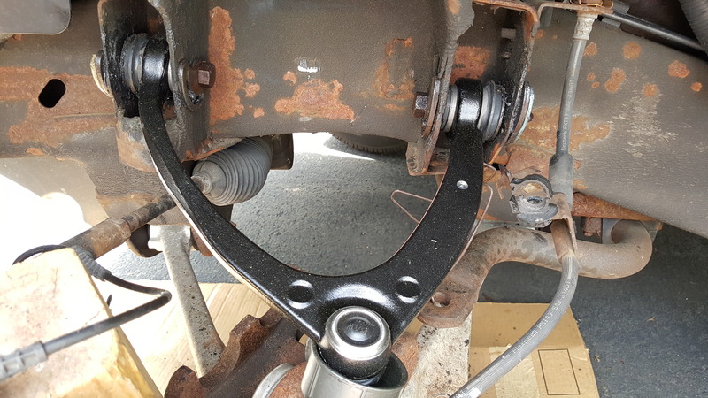

Here is what I am rebuilding front suspension for my 2007 Tahoe PPV, ex-NY State Police Hi-Way patrol vehicle:
1) Front control arm from Moog, with bushings and ball-joint as one piece assembly
2) Lower ball-joint (for Aluminum lower control arm), Moog
3) Sway bar end-link, Moog
4) Inner & Outer tie rod, Moog
5) Front strut, PPV application, Monroe
More pix will come.
