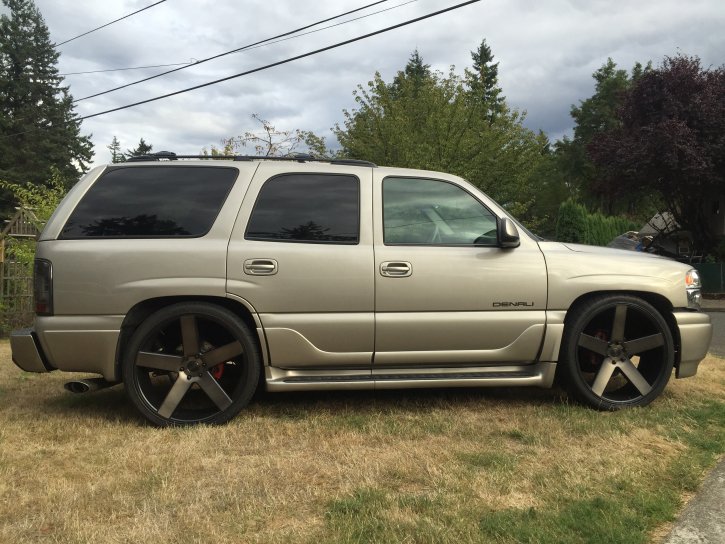

Arnott's stuff is quality in my opinion. Lifetime warranty. I have it on my Denali and it rides great with a 3/4 belltech drop (spindles and springs) and DJM shock relocators and endlinks. I did the new compressor and air dryer rebuild kit with all 4 shocks. Very reasonable price for the complete kit. My rears are actually Bilsteins. The only part of the autoride it bypasses is the auto damping part of it which I've heard is the most troublesome. So the front shocks are just shocks and the rear shocks have the autoride self-leveling function. The auto damping supposedly senses cornering forces and adjusts the shocks individually via electronics. I run lowered on 26's and at the same time when I tow or have 7 people in it, the compressor kicks in and raises it up so I don't rub. If I didn't have the autoride working I'd have to use air bladders and manually adjust them. It depends on what you want to do but don't let misinformation guide your decision. I will admit I had trouble with their front bypass resistors which triggered the " service ride control" light so I just soldered in 3.9 ohm wirewound resistors from EBay and now it's all good.
