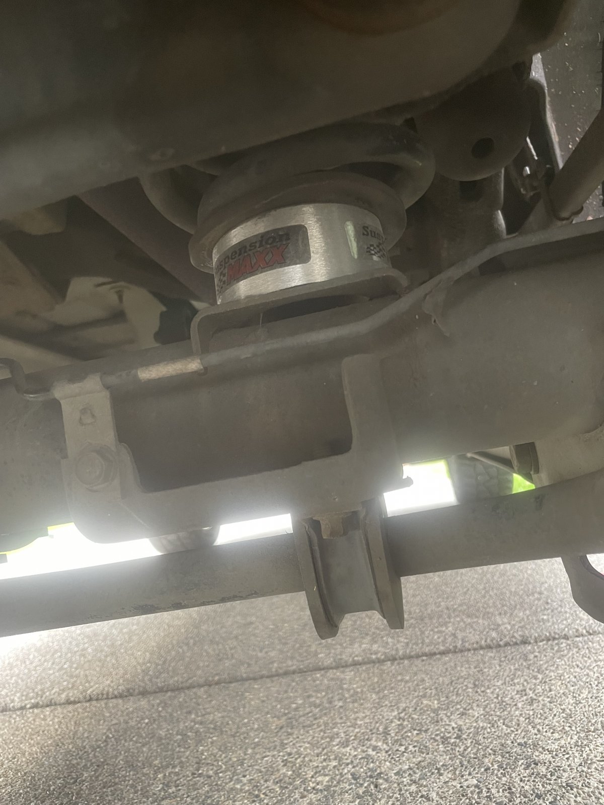

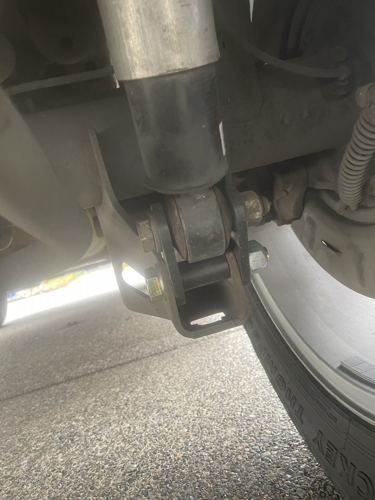

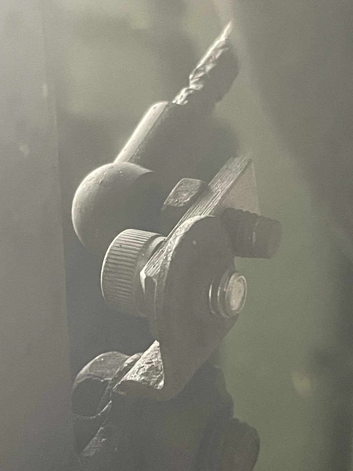

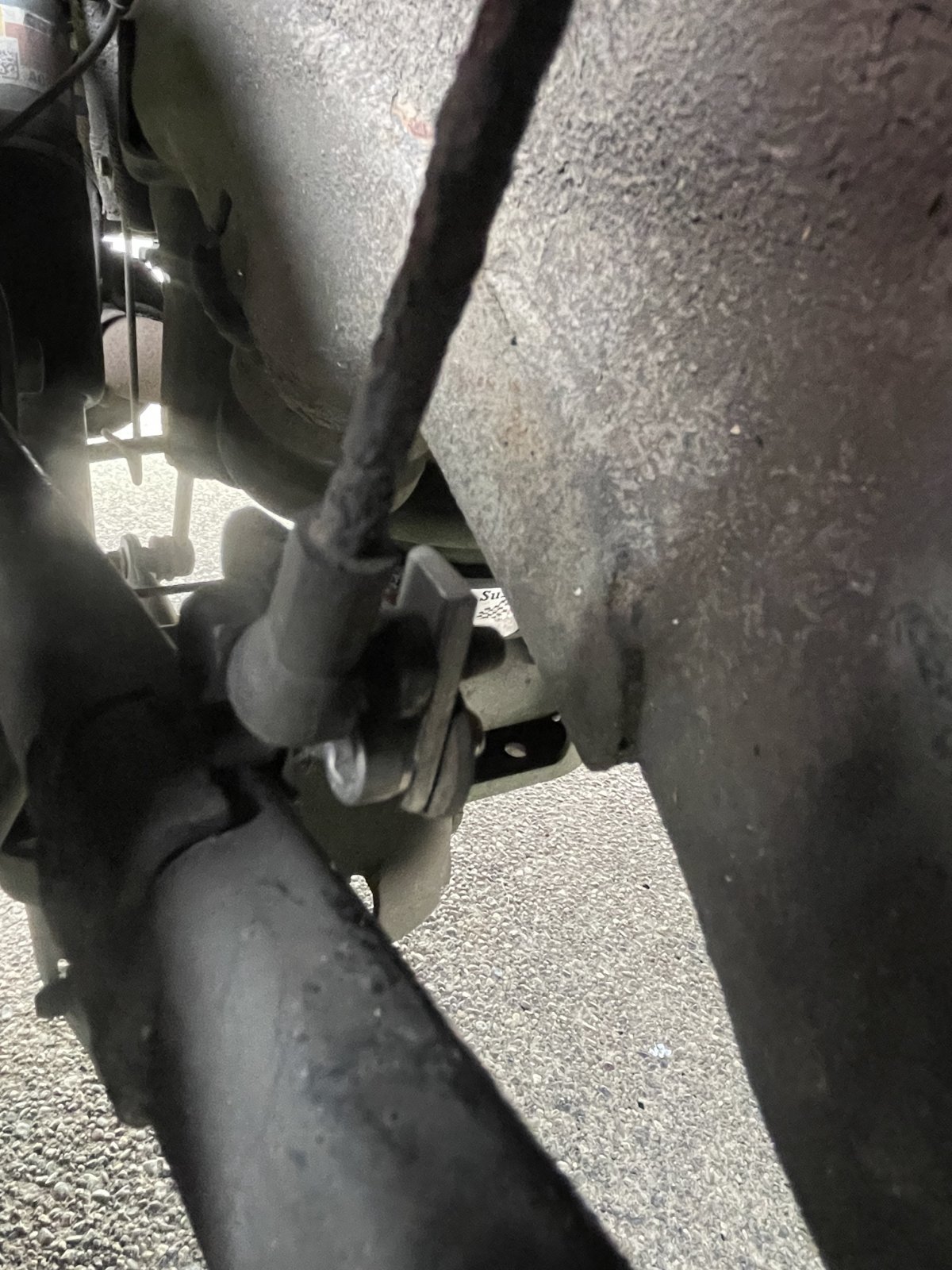

Hey all,
A while back I replaced my front struts with some Rancho ones. (They were a better deal at the time, and stated they leveled the front and the ride stiffness is adjustable).
Well since installing then my truck has a bit of a rake. I am not sure if the rear is just sagging a little since those springs are still the original, or if the front struts actually lifted the truck higher then it stated it would.
I was looking at throwing some leveling blocks on the rear to level the back
I was looking at these. https://www.americantrucks.com/moto...ppc&T5_Var2=shopping&T5_Var3=red&gad_source=1
But they stat not for Autoride. Is lifting the rear with air ride going to damage or hurt it? Is there another option to level the rear with air ride?
Like some suggested, you can get an all thread cut to length or the adjustable bar. When I did a baby lift on my 16 suburban, Maxx suspension sent a piece of metal bracket that moved the stock sensor bar up with shock extensions. Magnetic/autoride still functioning, rides like factory.
