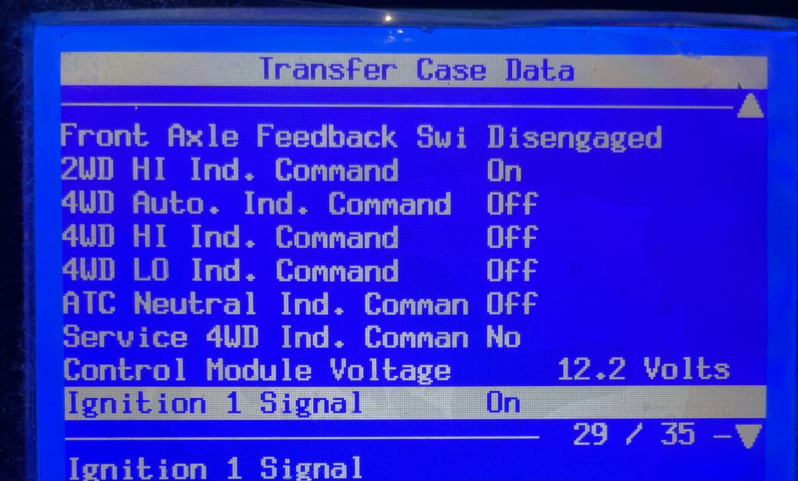

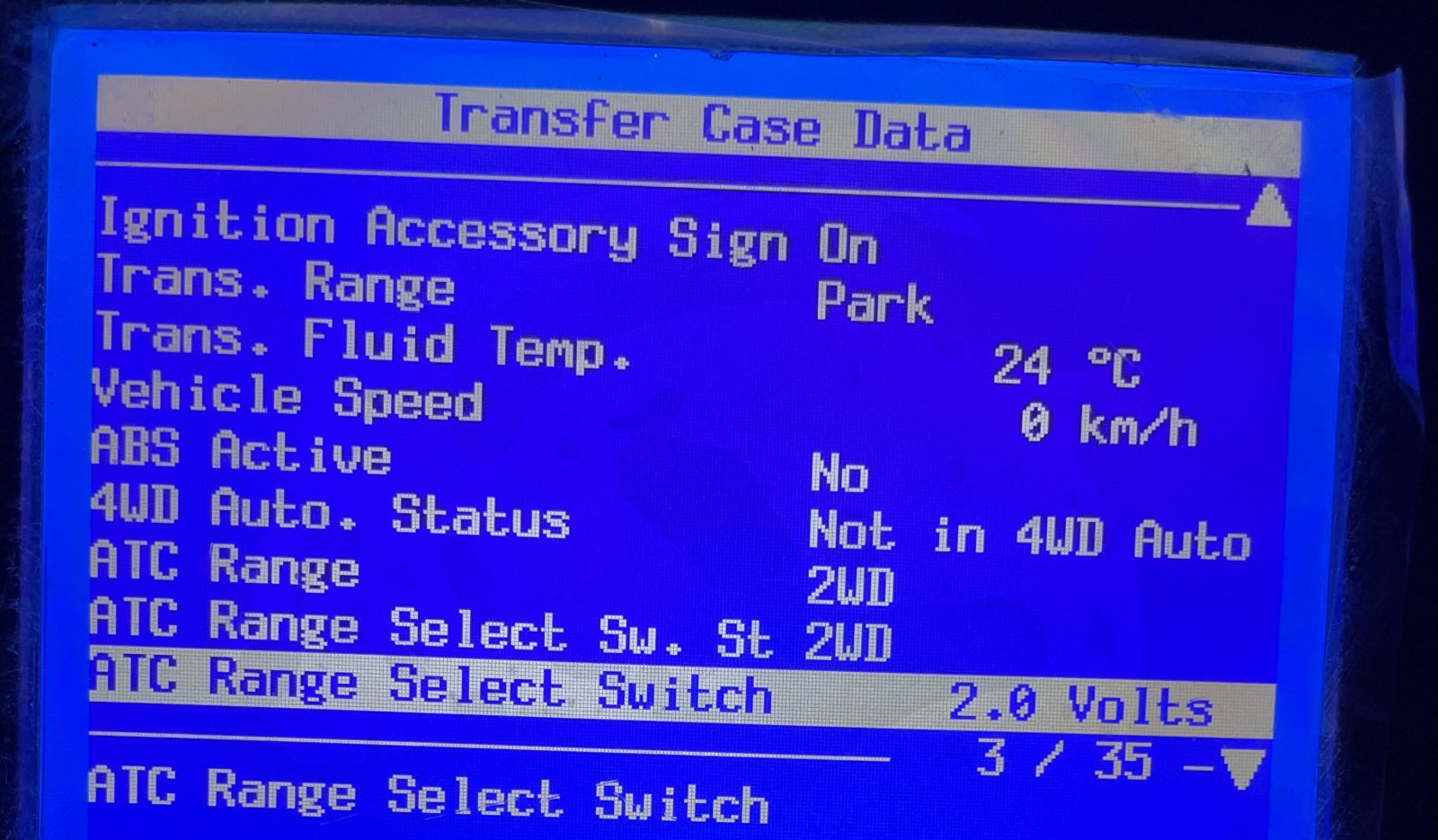

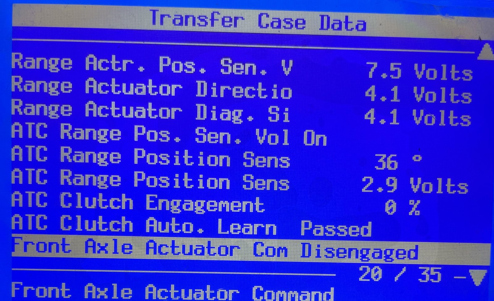

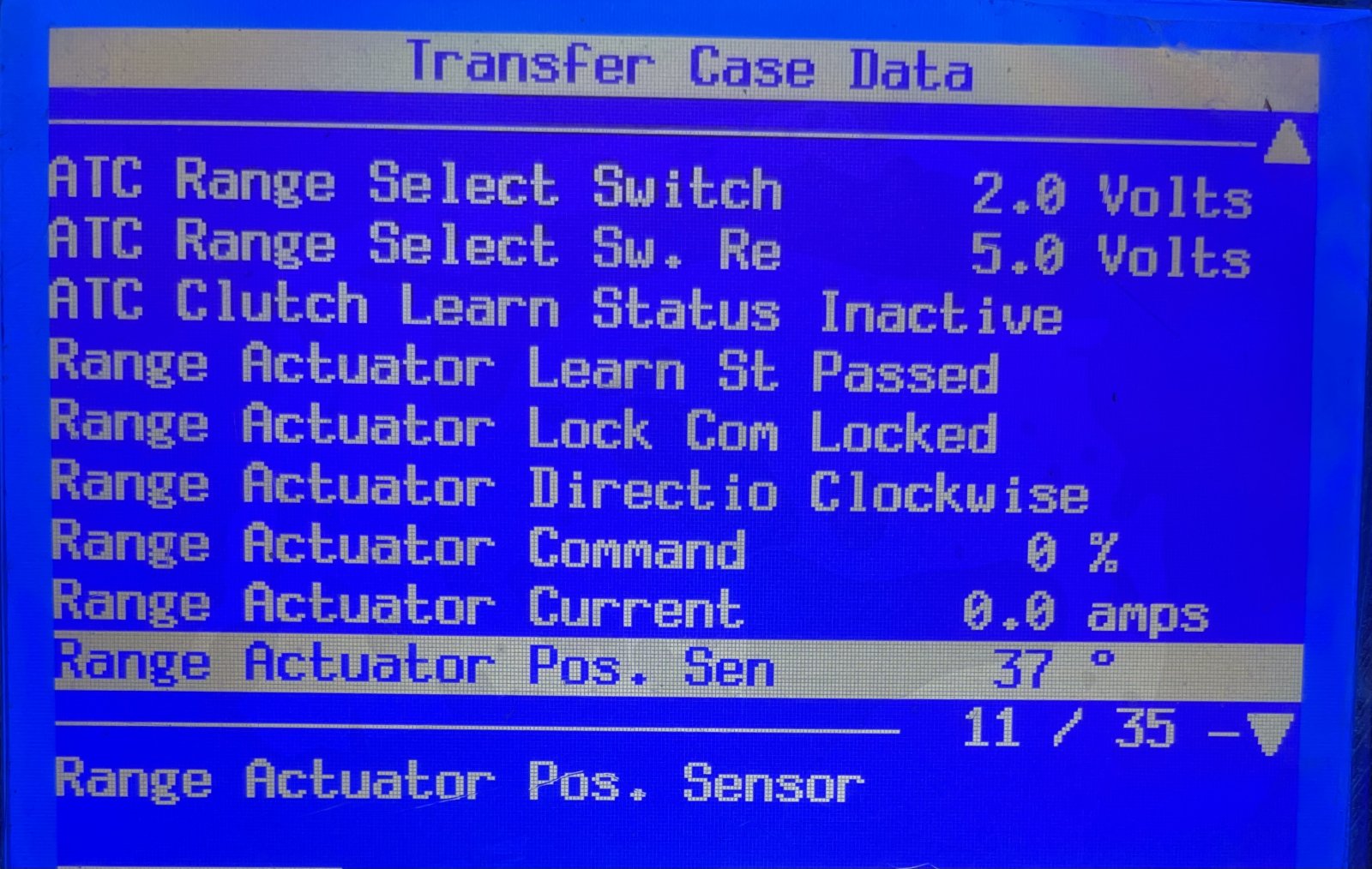

Heres a few snapshots for comparison..

Thanks for posting these screen shots. I went through every parameter and compared with mine. The only one that was significantly different was "Range Actuator Command" - yours is 0%, mine is 49%. Not sure if that means anything. I was doing the diagnostic key-on, engine-off, in 2-high. Looks like you were in 2-high as well.

Interesting, I was also key-on, engine-off, 2-hi.
And your theory makes sense why we only see one TCCM module forsale.
Might check what the Tech2 shows with your old TCCM regarding "range actuator command"
