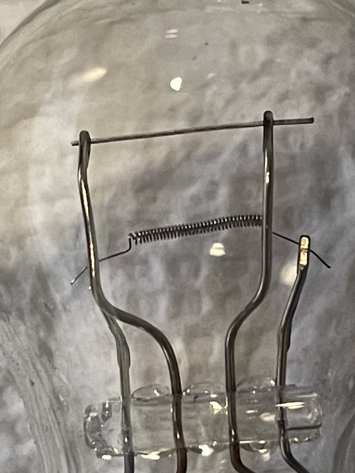

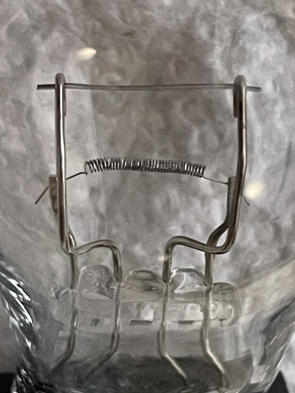

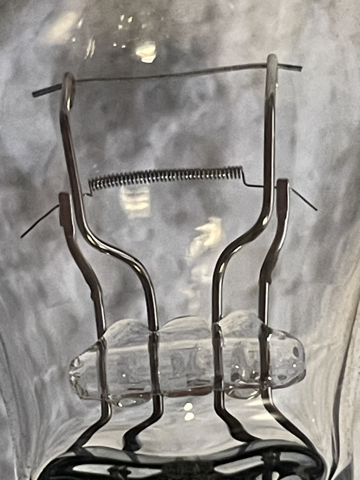

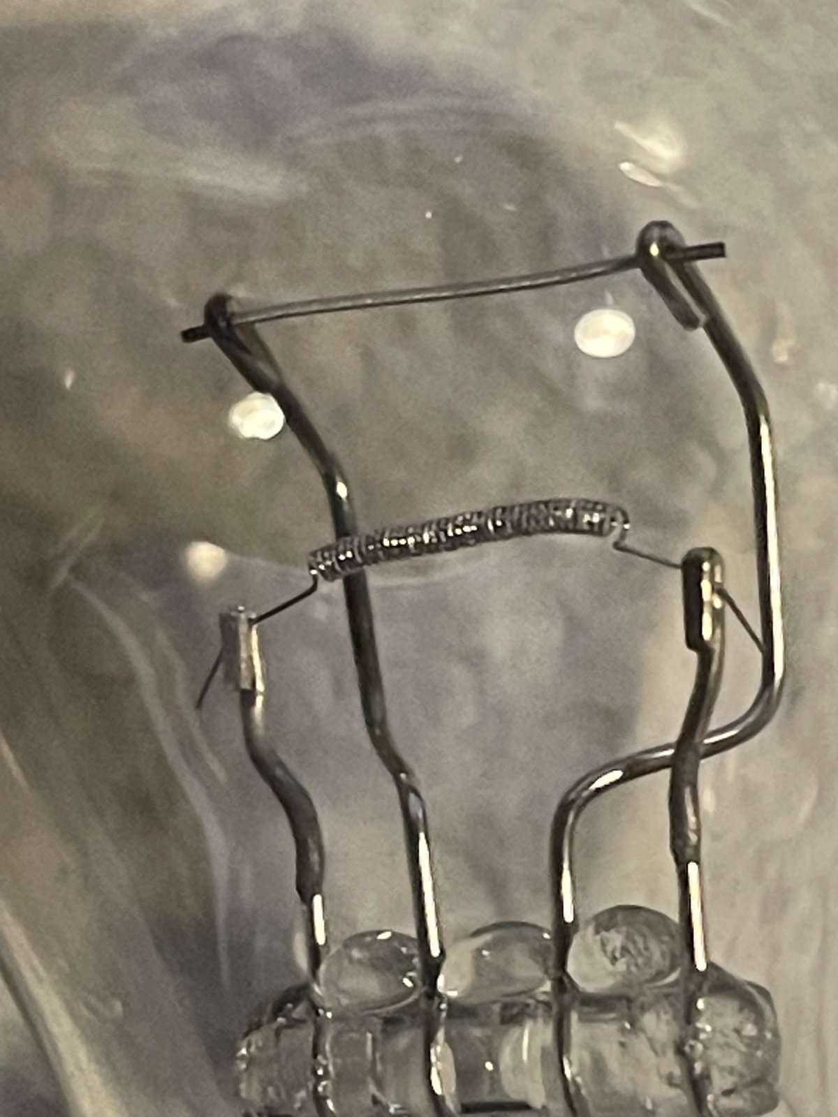

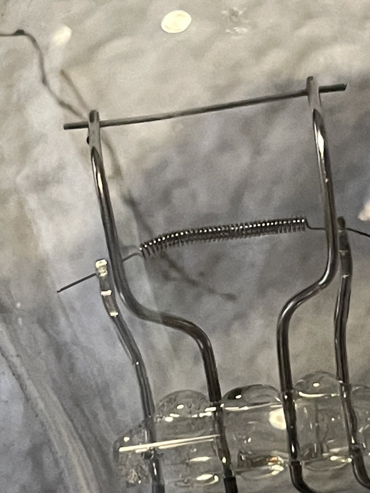

Well I installed the Hella's today (3157TB), and took photos of the Sylvanias..
3 bulbs are 2 years old, one is ~1 year old.. First the good ones..
Now the bad one...
Moral of the story DON'T BUY SYLVANIA! (Unless you want to replace blown fuses and bulbs every year) Between their terribly dim LED bulbs, and buying new bulbs at rip off prices, and buying a pack of fuses.. I've spent ~$200 on sylvania garbage.
