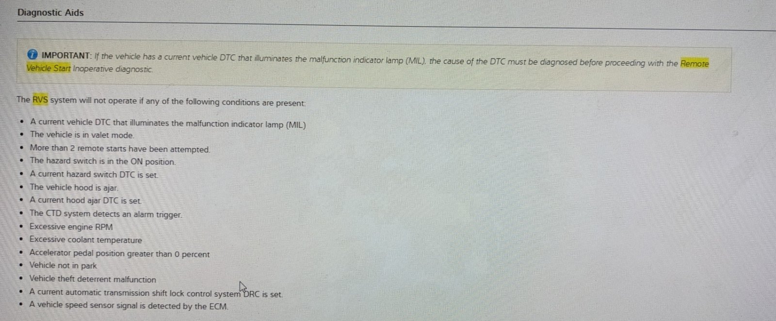

from 'verlon' at hptuners forum...

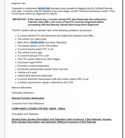

Remote start will be inhibited if 4WD Low Fault is detected.
- Check TCCM for right OS and calibration.
- Perform actuator relearn.
I'm not sure where to find the TCCM info in the Tech2..

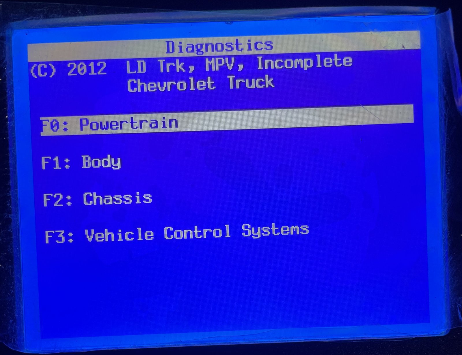

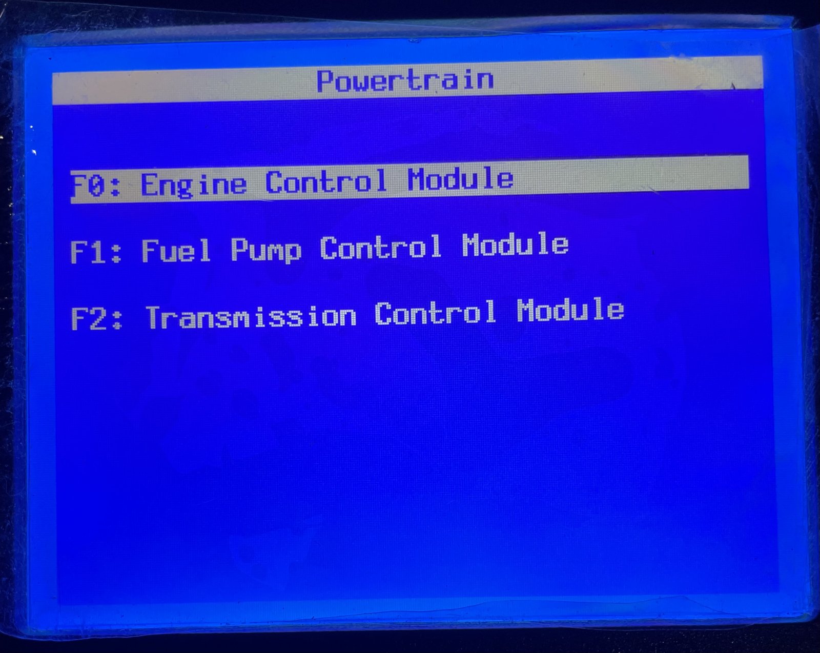

Transfer Case – Powertrain > Special Functions
See the Tech 2 Pathing document that @Joseph Garcia posted here:
mikez71
Mar 9, 2023
3,336
4,137
Thanks for that! But cannot find it. Could be pathing is correct for other models, but not my 2012.

Looking under ECM or TCM special functions also nothing with TCCM..
mikez71
Mar 9, 2023
3,336
4,137
Oh man, I WAS selecting the C option, thought "C" was for Chevy!
Welp, that makes sense now!
Thanks Fless!! I would have lived my whole life not knowing...
