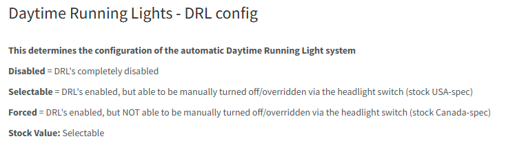

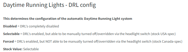

that's interesting info, sounds like the canada version of the light switch (they have no option to turn off drl's, but a simple switch change to a american switch enables it again)
mikez71
Mar 9, 2023
3,354
4,157
Interesting, the autosync configurator lists these DRL options..
Either way, glad I don't have Canda spec, eh?
