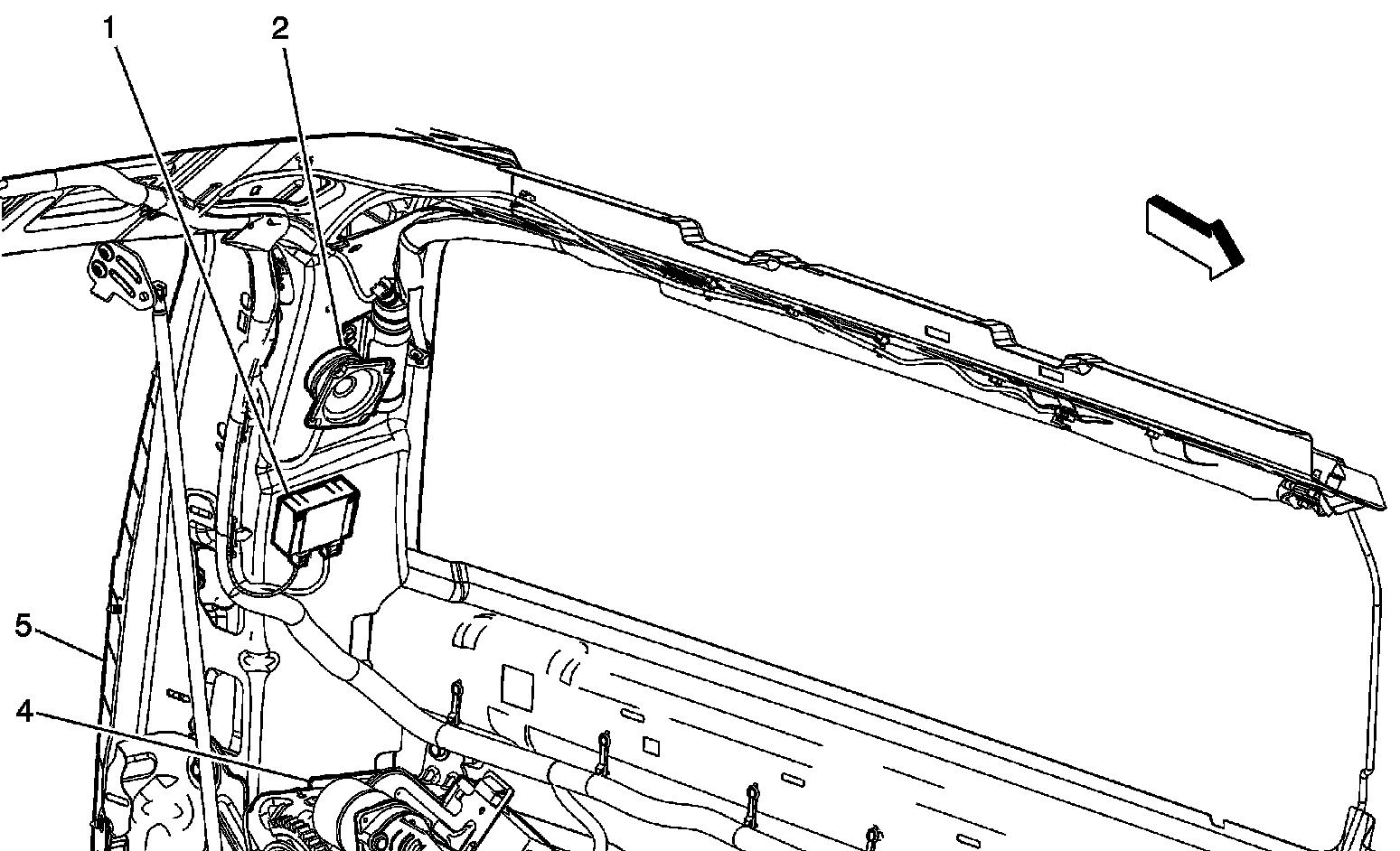

Number 1 is the Remote Control Coor Lock Receiver. (RCDLR?)
One of the cables that plugs into is (to?) antenna.
30,706
48,361
ya it's in the rear drivers area behind the panel, might be as pictured above or more forward near the wheel well I have seen pictures of it, definetely rear drivers side though
it could vary possibly depending on the year and if it is swb/lwb. or it could be there on all of them, hard to say from the pictures I have seen
pretty sure it requires programming as well if replaced.

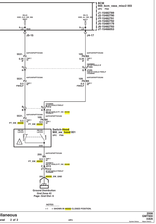

Looking at the diagram below, it appears there is a switch for hood closed as well as ajar.
I'm guessing if the 'closed' switch isn't active, no remote start and no hood ajar message.

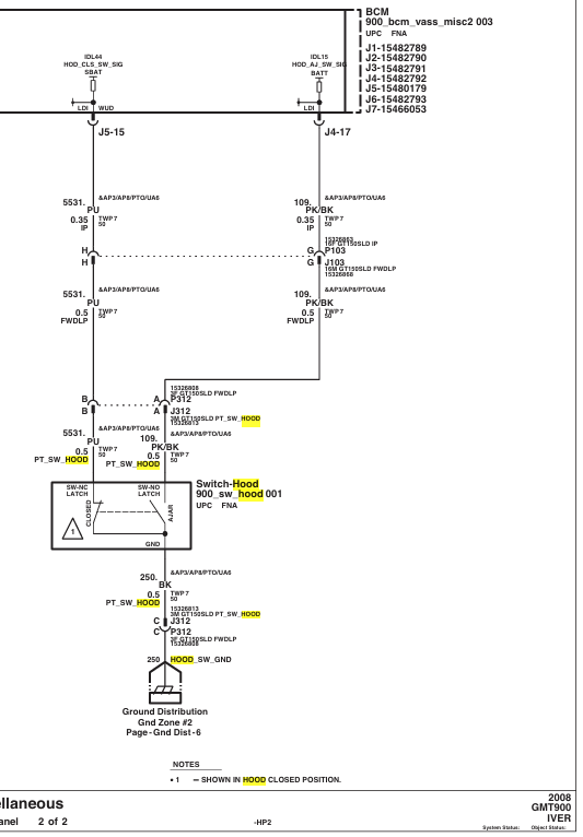

Thanks, the video was helpful. Yes, his solution ended up being pretty easy since he had a CEL, but it confirmed some things for me - in particular, with a RS request, BCM first does its set of tests, then if all pass, it sends the request to the ECM which also does a set of tests. Since I'm getting an "ECM - Crank abort" error, I'm pretty sure BCM tests pass, but something fails at the ECM. Did another ECM diagnostic tonight - zero codes.
Regarding the hood switches. The remote start screen on the Tech2 makes it look like there are three: hood ajar, hood open, and hood closed. (But maybe open and closed are just one switch) In any case, they are all behaving properly according to the Tech 2. They change status as expected when opening and closing the hood. Plus, I think those tests are in the BCM, and I think I'm getting past that. But all helpful, thanks.

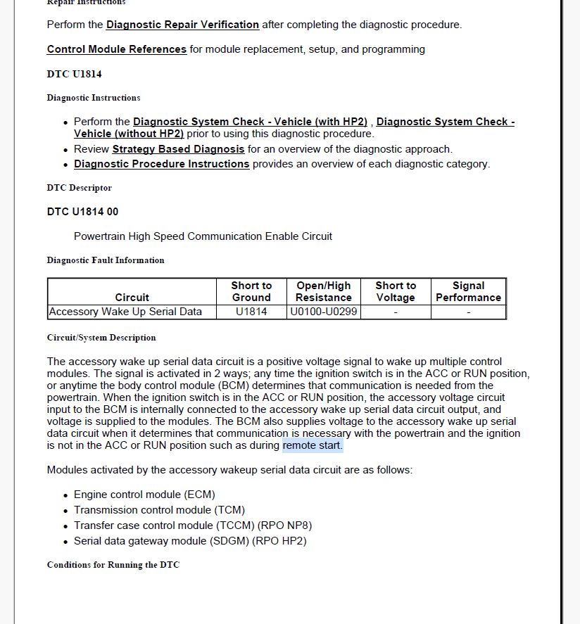

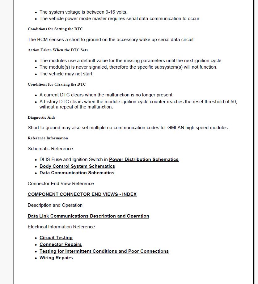

maybe something below will help?
