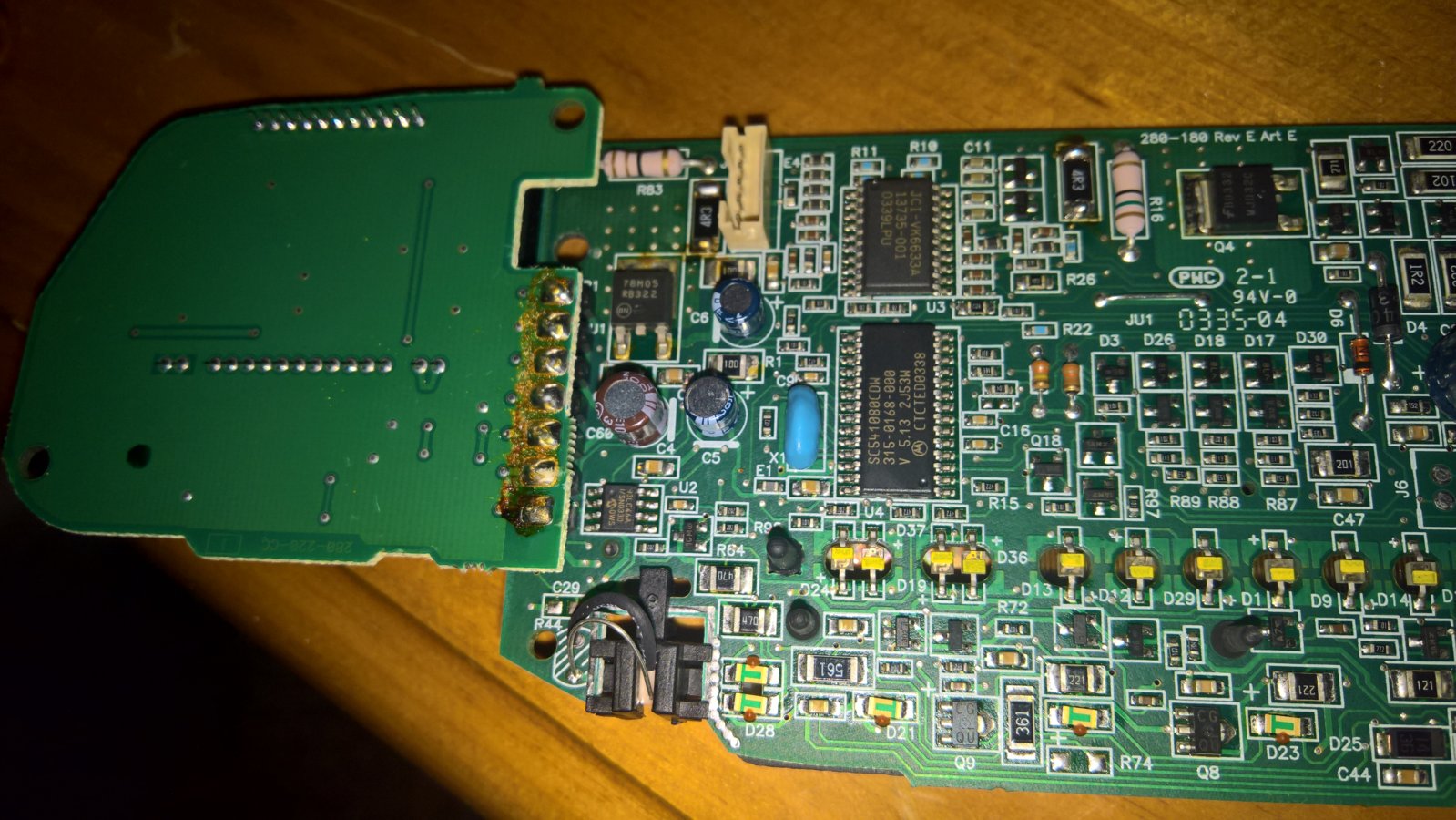

I'm having the same issue with my 2004's rearview mirror except the OnStar buttons also don't light up. I'm hoping those are connected. I cracked mine open but mine only has 2 components labelled 4R3. They're also in different locations from yours. Should I still try and reflow those 2?
This is what I'm working with:
I think I just found part of the issue. R74 (Bottom in picture) is completely missing a component. That probably explains why the buttons don't light up. Is it possible to use something else to connect it? Like a resistor? No idea what was there originally.

Just because a component isn't populated doesn't mean it's missing. It's common to design features into a board that aren't implemented, based on which parts are installed. For example, you may not know whether you want a signal pulled high or low, so you do both. Then the parts list will be missing one of the parts (you would never want both populated at the same time). Look to see if the pads look "new" or if something was soldered there and fell off.
