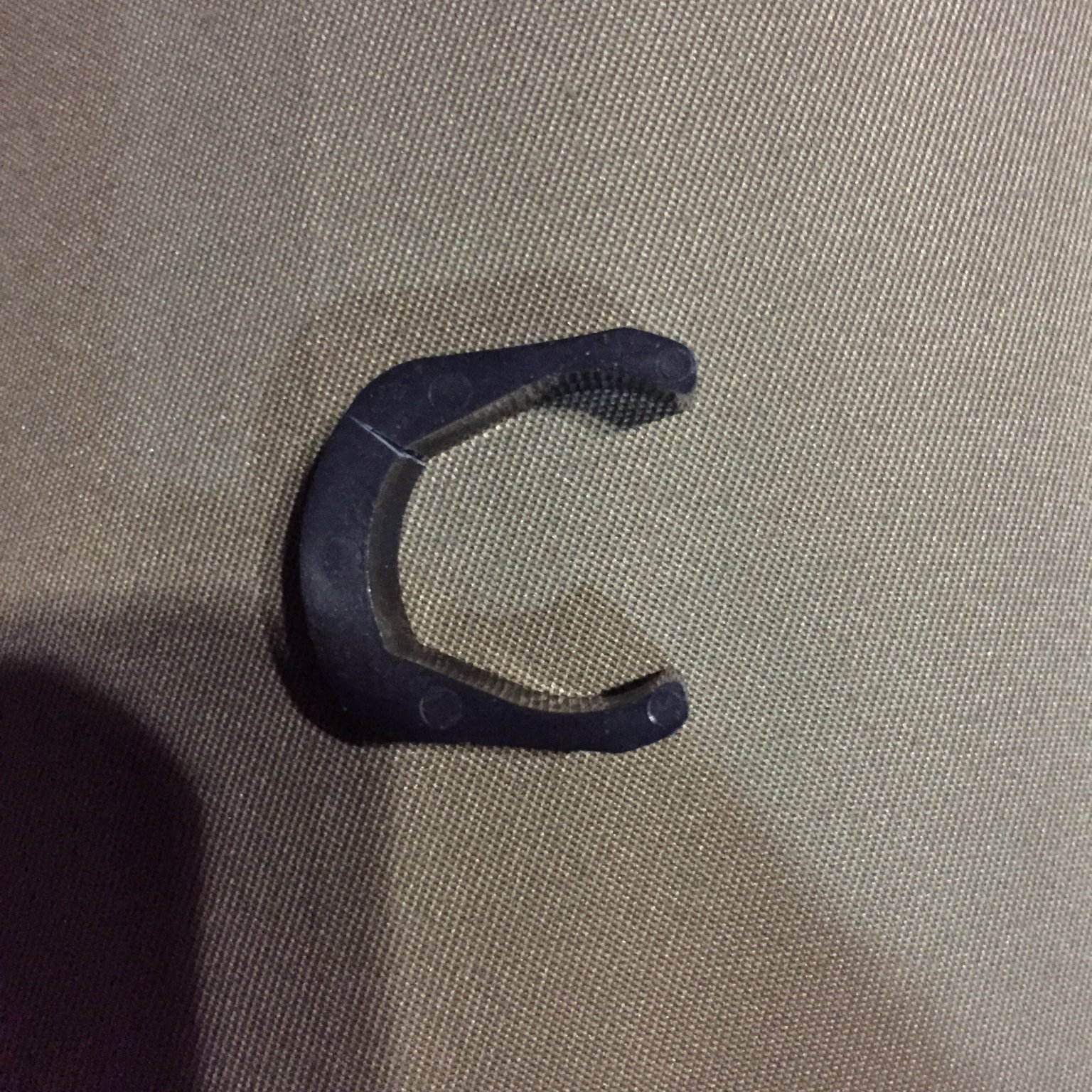

where can i buy this clip for the rearview mirror?
