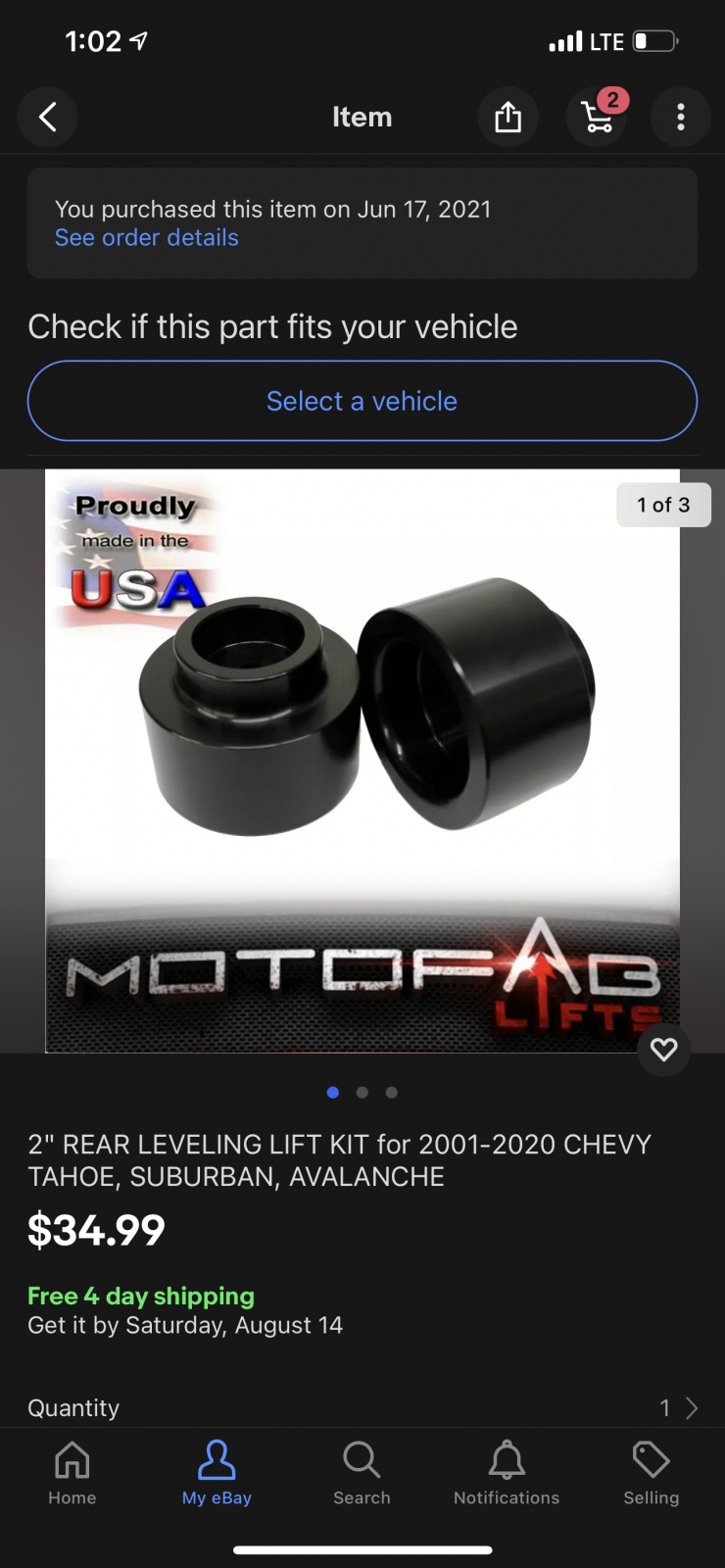

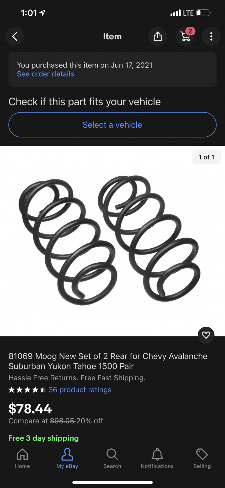

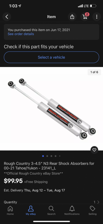

This is my rear suspension setup, Z71 coils and 2” spacer gave me the perfect 4.5” height and factory ride and rake for heavy loads….. front is just a 3” spacer. Has 7k miles on it and love it. So does the wife

@Rockcrawler11 - Are you saying that the z71 rear coils springs gave you approx. 2-2.5" of rear lift alone?
That’s what it looked like to me when I installed them. Seems closer to 2” than 2.5”…. When I’m home in a few weeks I’ll take a measurement. Even with a 3” spacer up front I still have a 1.5”-2” rake at the rear…. I also have a non autoride model.

if it did gain the 2", that alone is enough for me to swap and eliminate the coil spacer i currently have
You keep the factory ride and add capacity too from the higher spring rate… it’s an OEM+ upgrade that works perfect.
