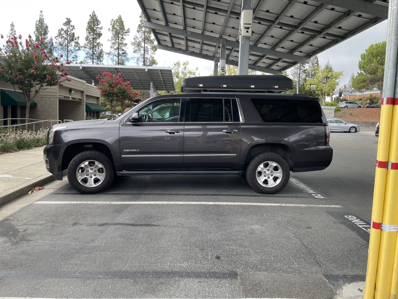

We installed a RTT on our Yukon xl Denali that was running the border patrol spec rear springs. Rated at 225# rate iirc.
The dobinsons c09-045 are 245# I think… and just a hair longer. Like maybe 1/3 inch.
It lifted the rear 2/3” and tightened the rear up greatly. No more packing on the rear end.
Super happy considering the weight increase.
If I was not adding 200# on the roof (ikamper deluxe) I’d have stuck with the BP springs.
I’m going to swap the coilover springs too for a little stiffer and see how that feels. Preload increase is an option but I have a bunch of springs laying around.

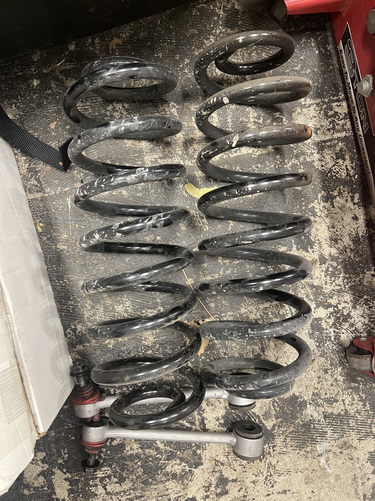

Old springs

Old springs… I’ll get the photo with the new ones tomorrow. I also need to swap the springs on the coilovers and lift the front a little to get close to a level
