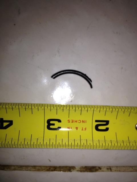

But now I have another concern. I just did the front diff as well and it was extremely dirty. and a piece of metal came out also. I have auto AWD so I cannot select 4wd, it just does it automatically as it needs it (my model has no button to select 2wd), and it rarely ever gets used.
but my concern is this piece of metal. Should I be worried?

I`m not sure where that metal could have come from. Maybe someone else knows.
Was there a lot of shavings on the magnet on the tip of the bolt as well?
The front diff takes 1.8 quarts if you haven`t figured it out yet.

The front still works also but that piece of metal is concerning. Plus it has lots of metal shavings on the magnet. For now I am not going to do anything about it but at some point I'll see what it takes to get the front diff rebuilt.
There was also what looks like some kind of rubber vent hose on the front diff. I am not sure what that is for but it was split where it connects to the diff so I just trimmed the split area and pushed it back on the hose connector.
