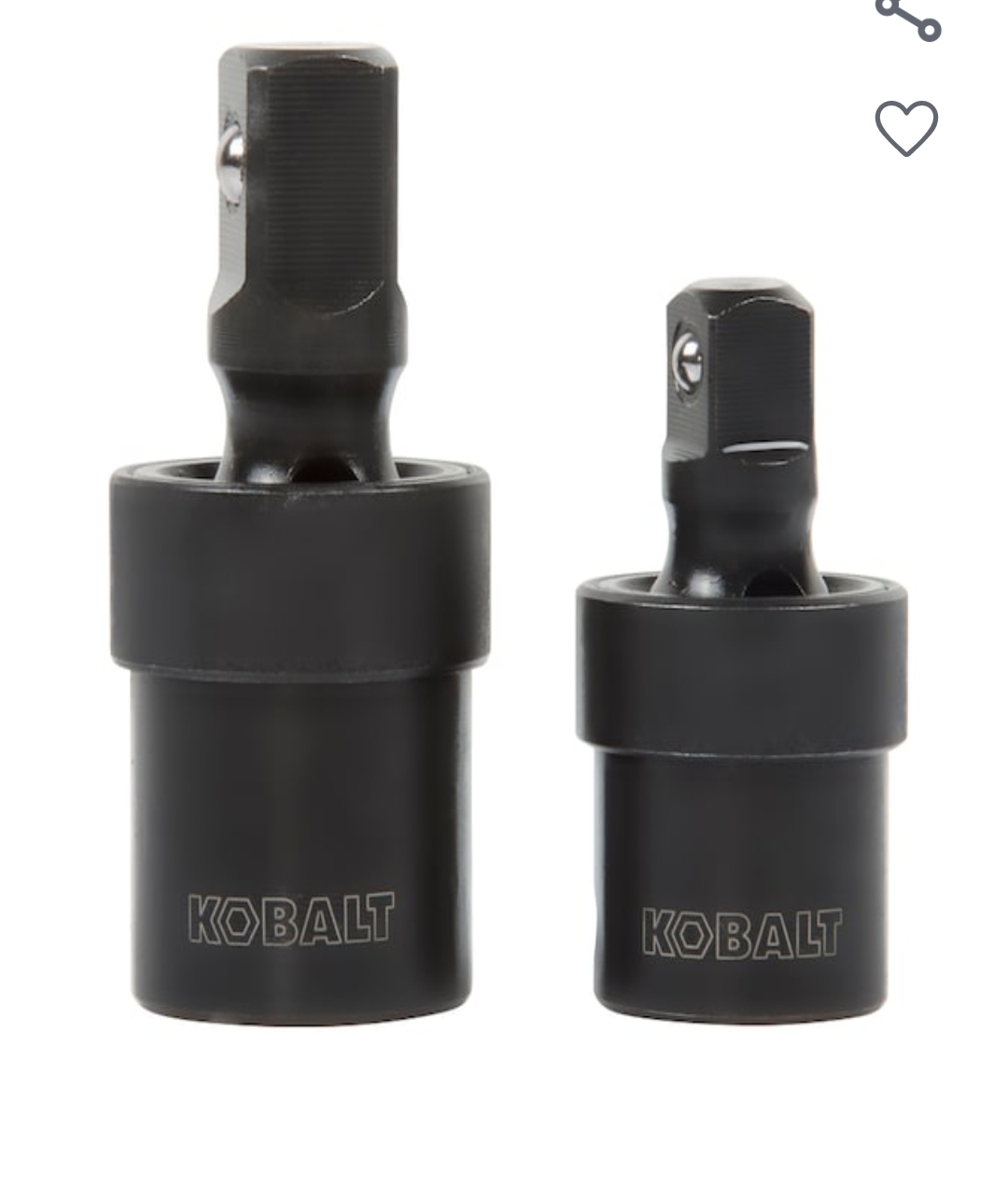

I did both of mine two week ago. D/S wasn't bad but P/S was p.i.t.a. Lots if YouTube videos showing many different angles of attack. If the exhaust manifold was removed both side would be a cake walk but that's no easy feat on old truck. I would say the below swivel attachments are mandatory to get to the bolts. I also utilized impact tools and used the job as a reason to finally buy a battery powered impact wrench. I paid the dealer $1100 to do the d/s on my Suburban 4 years ago.1000003780.jpg

I did both of mine two week ago. D/S wasn't bad but P/S was p.i.t.a. Lots if YouTube videos showing many different angles of attack. If the exhaust manifold was removed both side would be a cake walk but that's no easy feat on old truck. I would say the below swivel attachments are mandatory to get to the bolts. I also utilized impact tools and used the job as a reason to finally buy a battery powered impact wrench. I paid the dealer $1100 to do the d/s on my Suburban 4 years ago.View attachment 424899
Yeah man! I just got one of those a month ago I LOVE IT!
