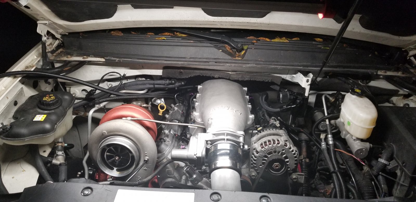

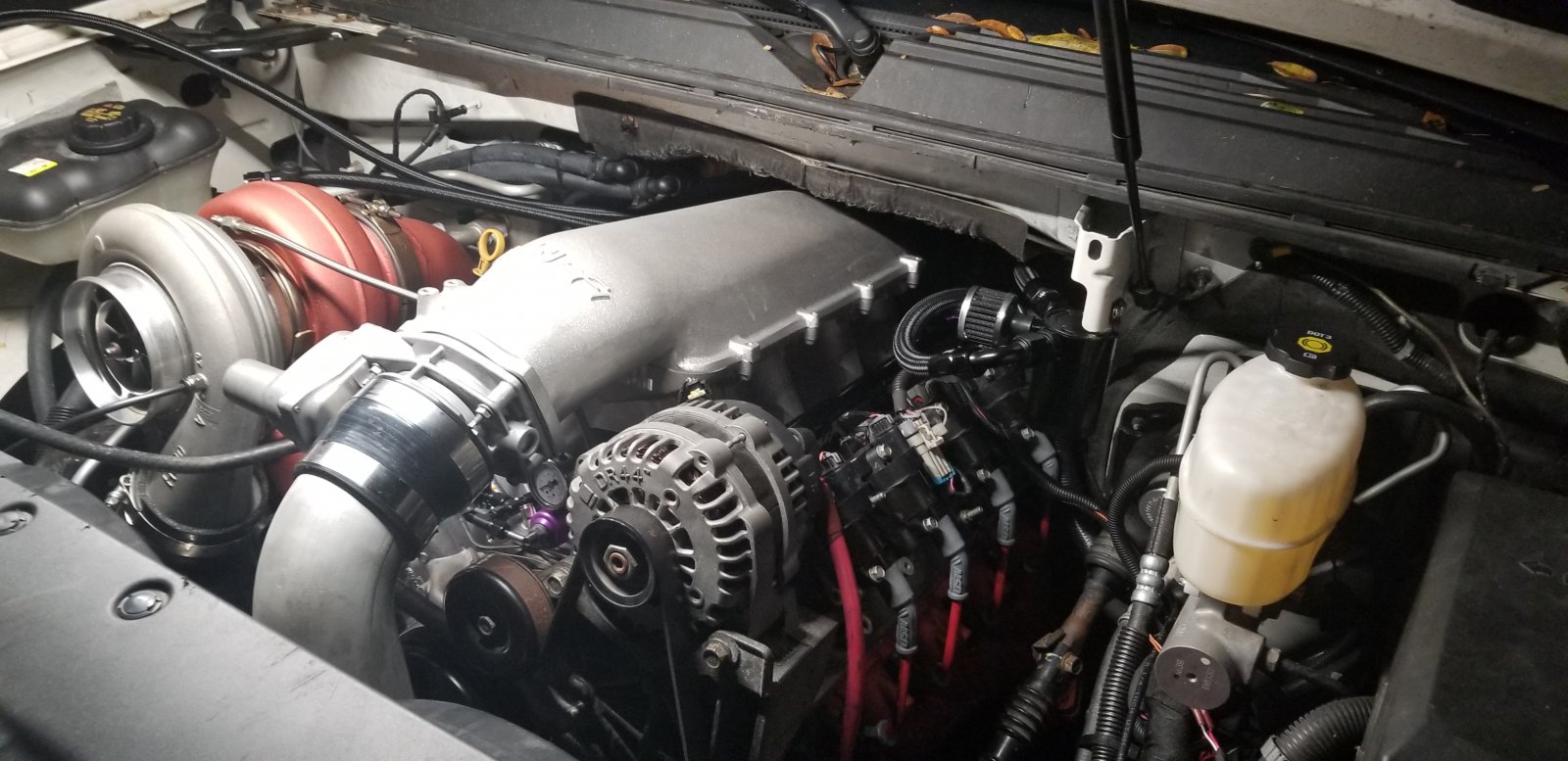

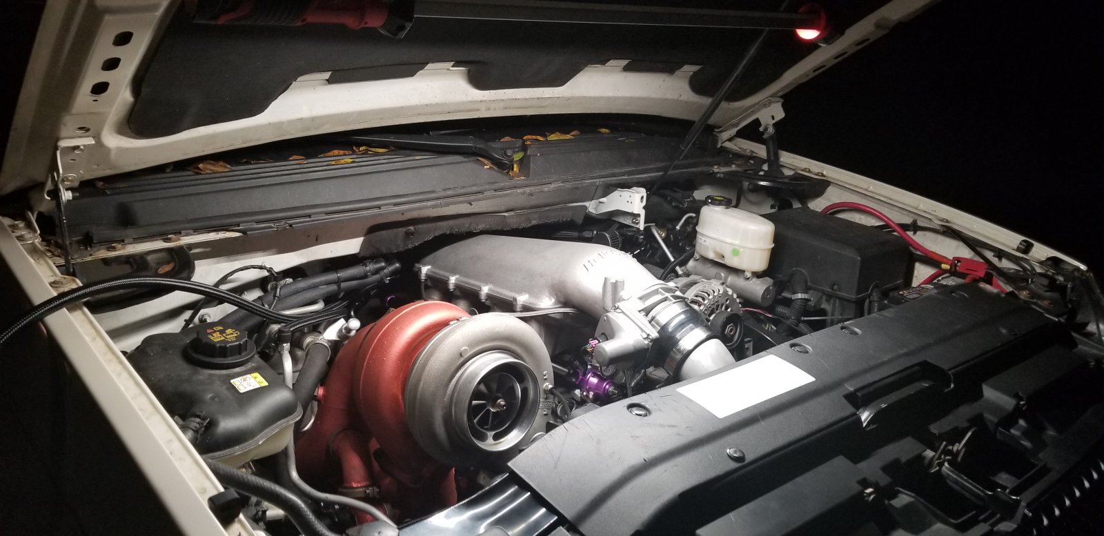

    All was fine, got up this morning at the crack of 11am got some lunch, tries doin a little test and tuning of my own. Ac didnt work , popped hood shredded belt so I cut it out.
    Made a few changes, went out and it ended up throwing the accessory belt :(
    got a little warm 250* waiting on tow at the moment. Put belt back on. Right where the belt tensioner is is where turbo outlet is. I think the housing turned enough to hit the tensioner the way the pipes are it wants to "straighten out", pulley on the tensioner is ruined, coolant is all gone out of the reservoir, it's not in the oil that I can tell from dipstick. Going to pull the plugs and turn over when I get home. May have just turned it all to steam it was pretty much straight water wouldnt have to get very hot to do so

    Basically that area...the housing wants to straighten out the 90 coupler but it rotates instead. but I dont think that's enough to hit the tensioner, think it may have thrown the belt and make tensioner to be closer anyway
    and it didnt lose much water, boiled it all out of the reservoir but only took maybe gallon and a half to top off (using small mustang reservoir, prob less than a gallon capacity in it)

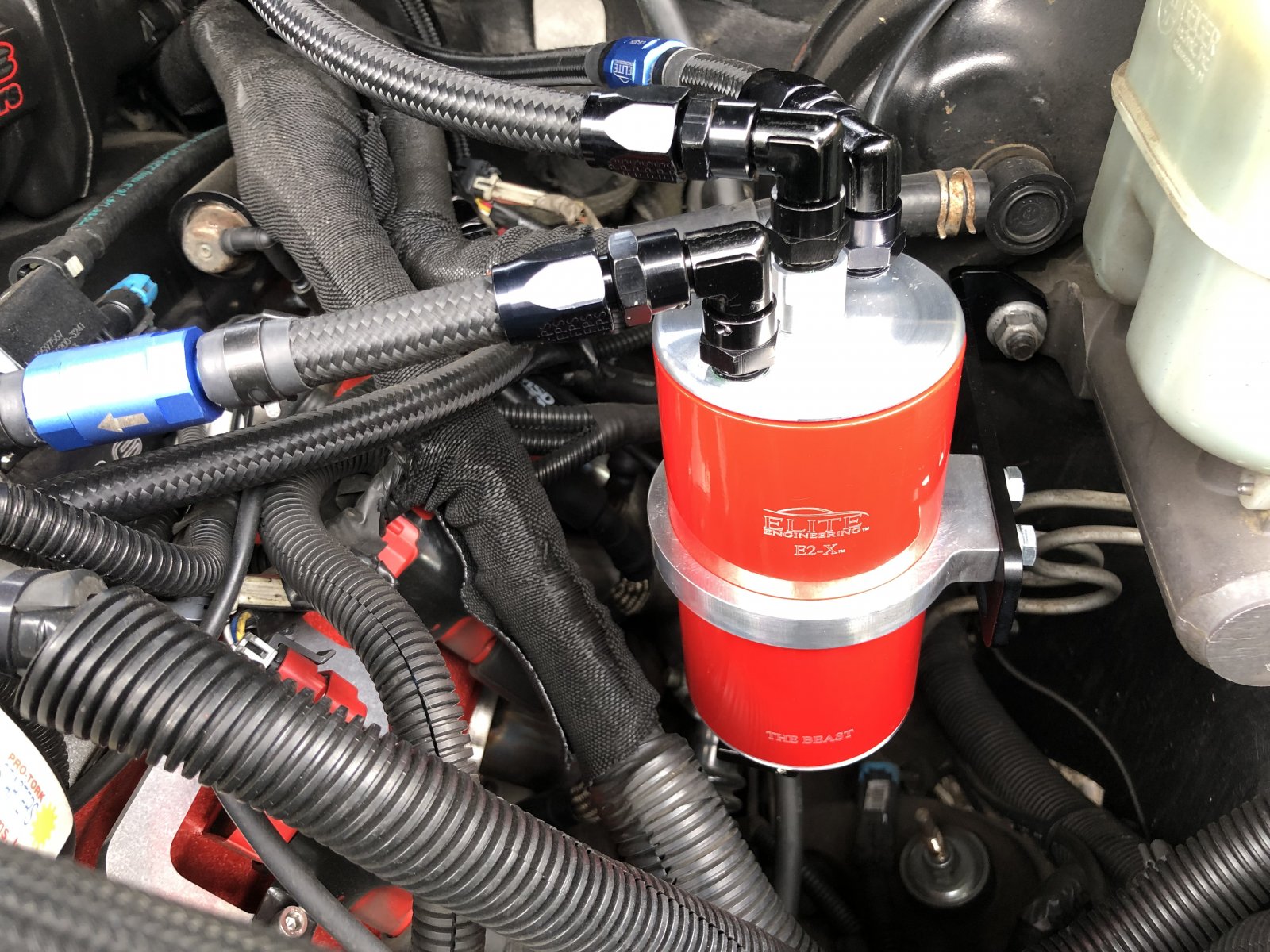

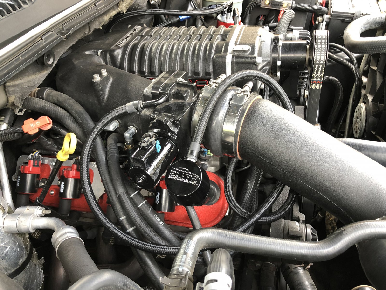

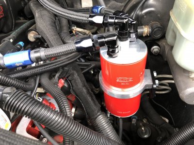

    fuel system - a little more done, fittings should be here in a couple of days, like 10" of crap from the stock fuel line>flex fuel sensor>QDC fitting>union>check valve>regulator. need to make a easy L bracket for the regulator to mount to, moving the catch can and remount it, the return line has a nice spot to leave a little extra hose so i have that entire hose made up with some slack. soon as fittings show up i can make up last feed hose and locate the sump - i know i should start at the sump and work my way out but it just worked out to where i could complete 10% of it and be short a fitting or do 90% and be short a fitting

    Eh 5 min bracket should work fine lol
