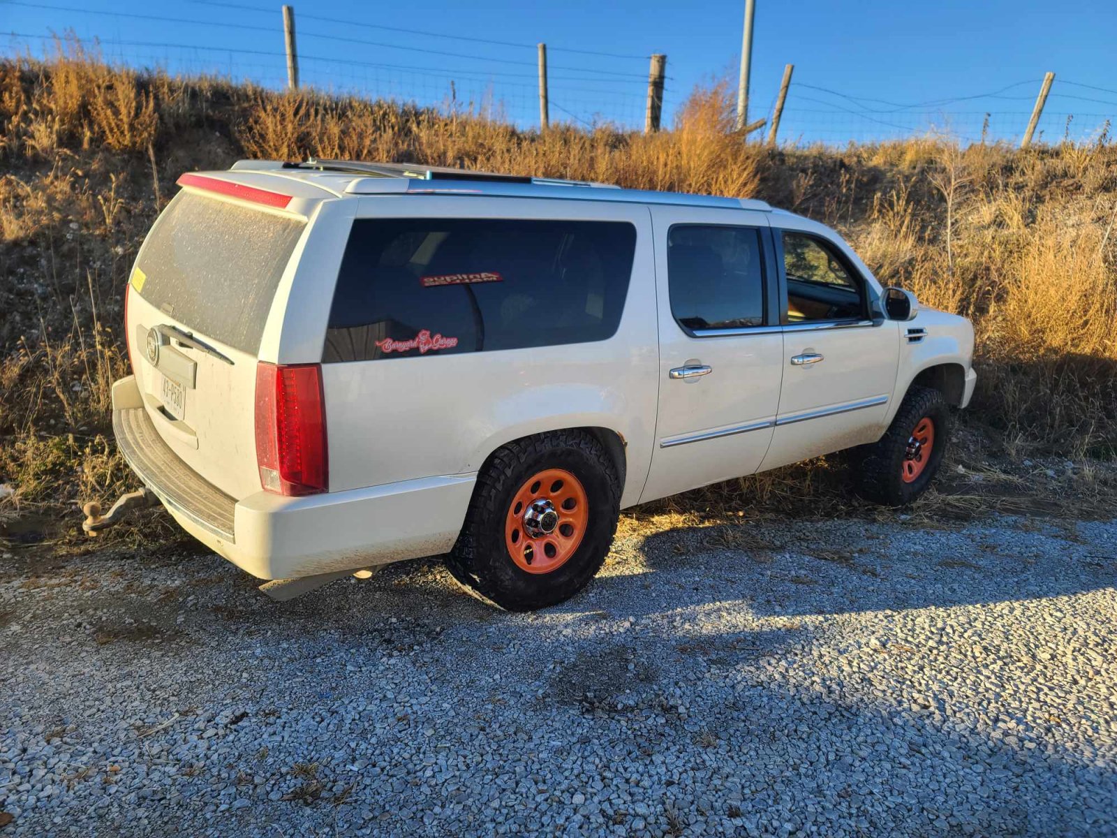

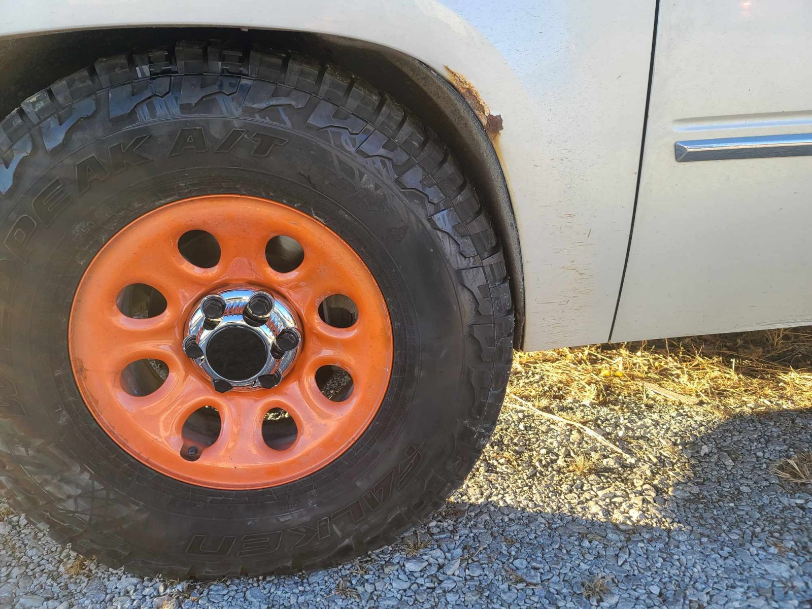

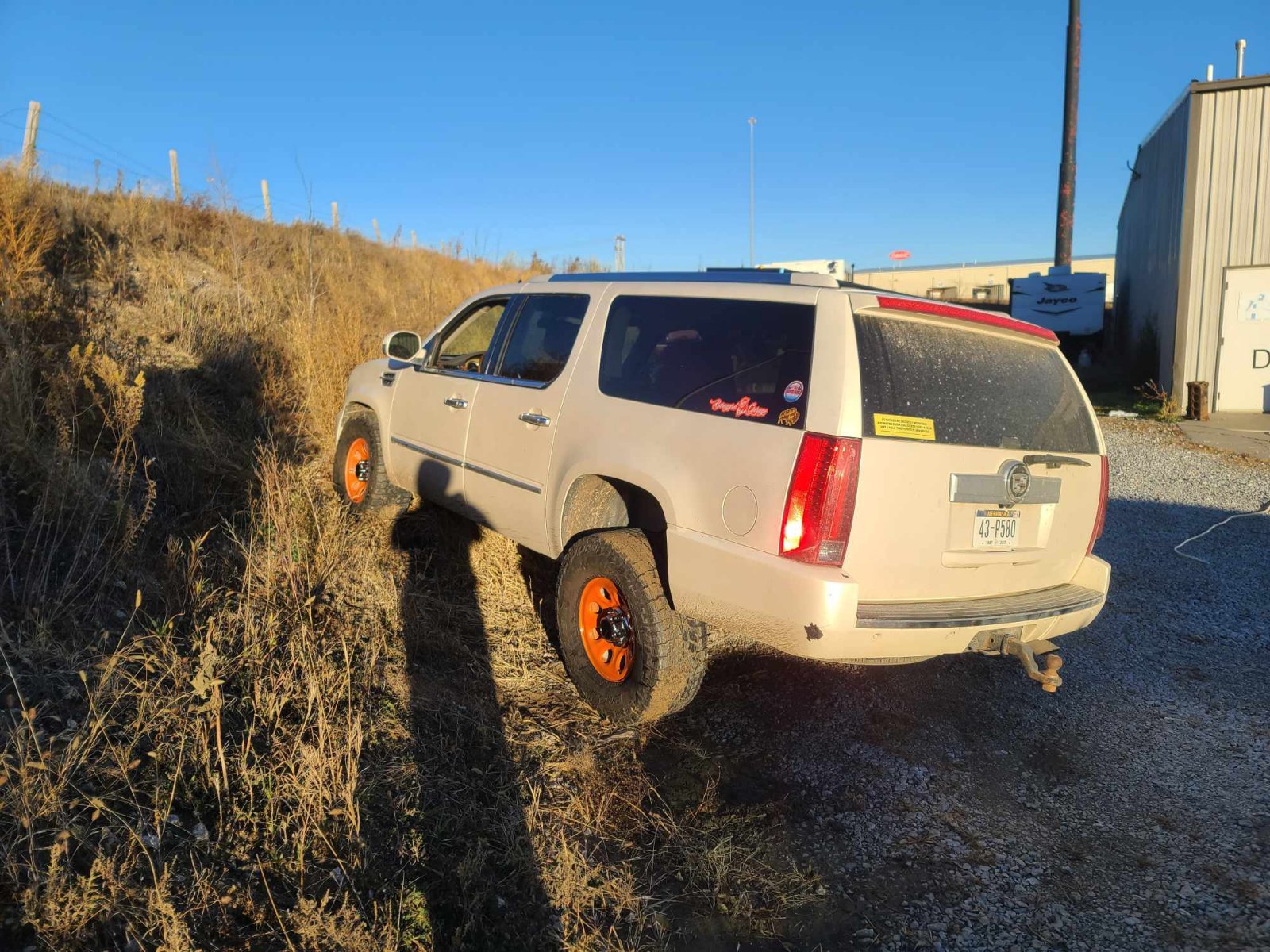

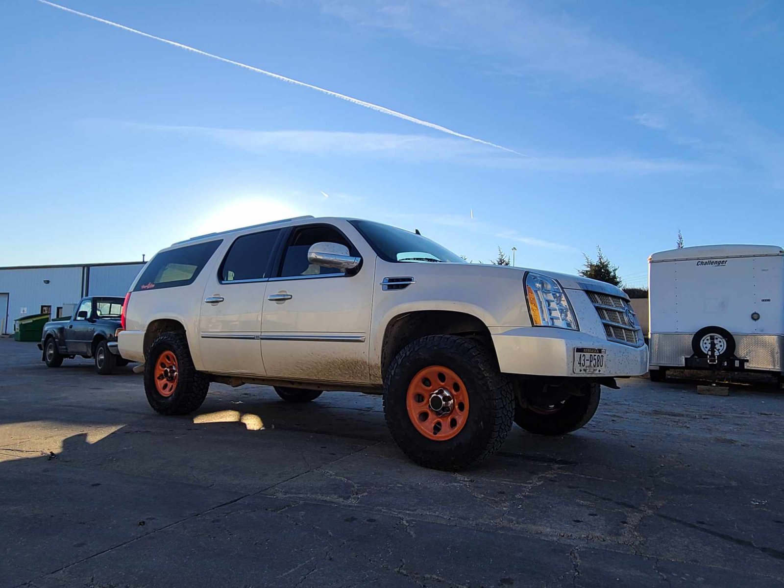

I figured I should make a thread for this. Got some used 315 70 17s last night and got them mounted and installed today. Had to do some cutting of the inner fender liner in back, front needs some still be nothing too crazy. Rear could stand a 1/4" spacer for sure. Found out my play in the steering is coming from the rack bushings so I got a new set of those coming, need to do wheel bearings and looking at the kryptonites.

Is it 2WD or AWD? Looks like fun in the making.Too many LEGO like parts to ponder if your thinking about doing a AWD to 4WD swap.

It's 4wd, I did a np261hd transfercase swap. I very very rarely need 4wd so until I make a level, so far I just have crawled under and popped it into 4 low or 4 high if necessary. Run in 2wd most of the time.
