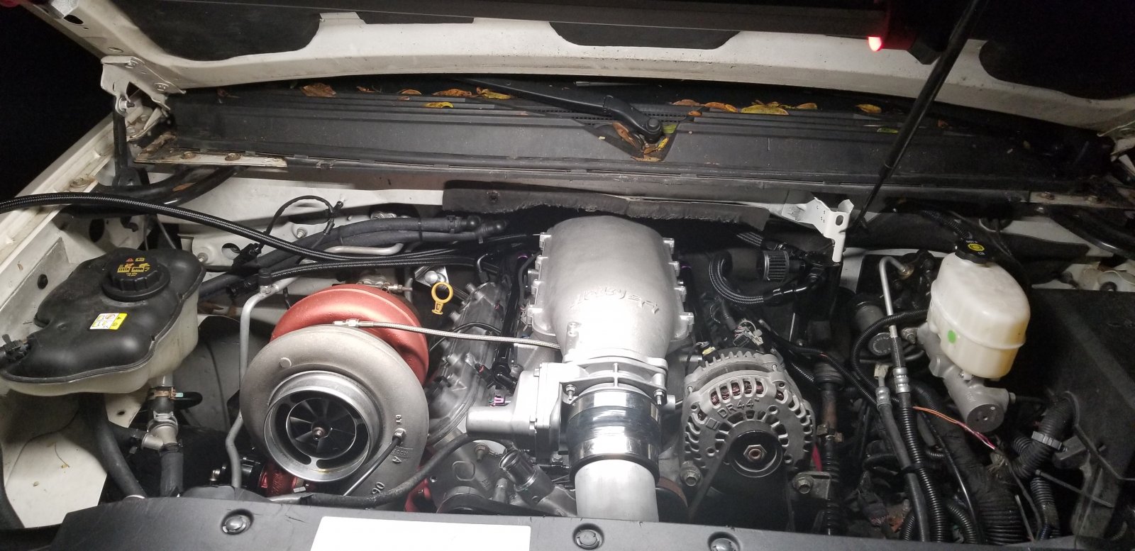

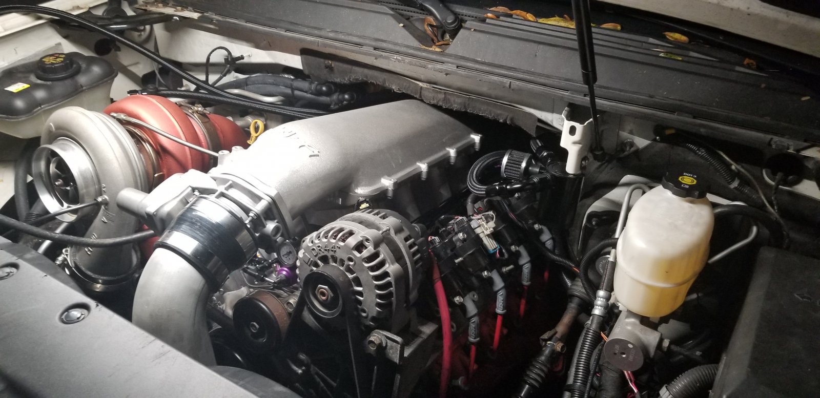

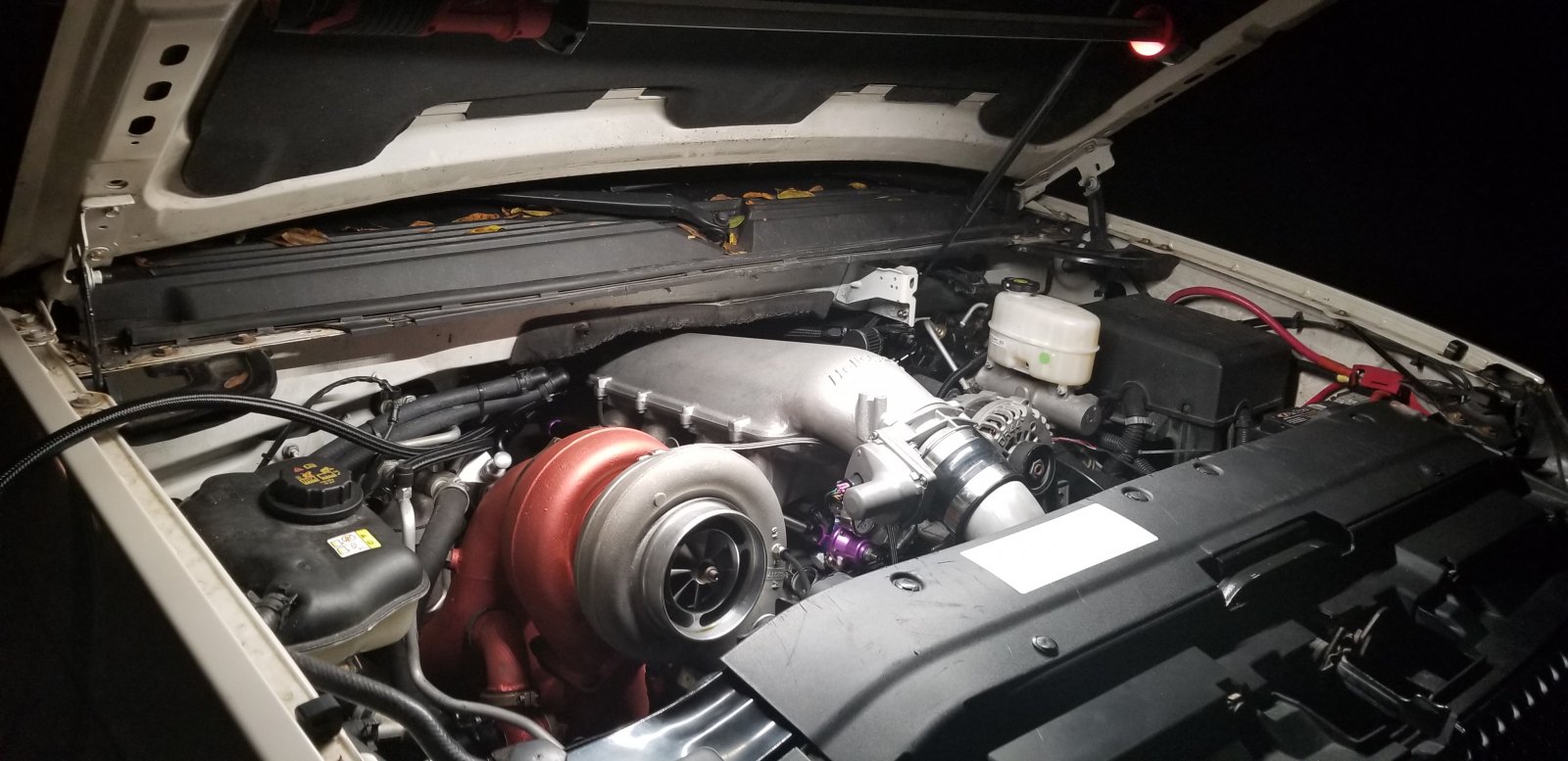

she back .... barely :emotions33:
so i get everything back together, fill coolant and oil....pulled the fuel pump fuse and cranked it over for a while to try and get some oil moved around.
started it up....couple codes : throttle position range, o2 sensor heater circuit . no big deal can get up to temp and whatever took it for a short drive. everytime i gave it a little gas a fuggin "service blind spot monitoring something or another" would pop up and feel like it cut power. hmmmff thats weird, dunno its been unplugged a while figured id just cruise and see if it got better. more warnings, dash lights up power gone, comes back, says low fuel warning so i pull over turn it off (hoping not to be stranded) check under the hood i still have wheel liners out may harness fell into tire, check main ground. turn it back on "seems" ok, drive it does the same thing everytime i give it some gas so crap figured i fried the BCM or something. got back home, gave it one more look over and found that i left the smaller ground on the front of passenger side head loose :emotions122:
tightened it up, all is well took for another drive and all seems good! only gave it to it a little bit, going to put some miles on it before some wot pulls but it does seem to run pretty smooth i had put in 12lb(9+3) wastegate spring prob would have been fine with 93 but it should have plenty of balls there
***meant to say i pulled the 3lb spring back out so it has only the 9lb in it. if the first spring was any indication it will prob peak a psi or 2 above . with 12lbs of springsit may see 13-14psi which i wouldnt want to run very much on 93

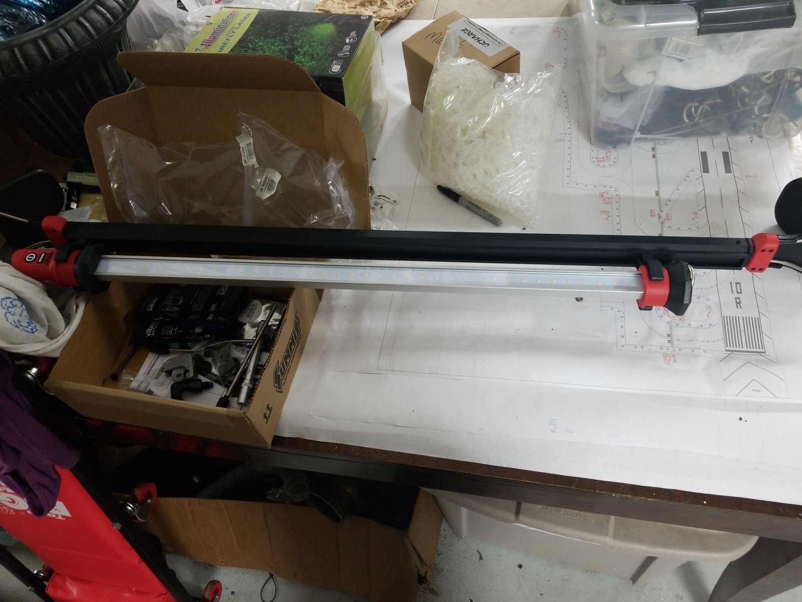

waiting on a few more ptfe hose ends and i should be able to start. reviews said it was a pain in the ass to work with but seemed easier than the regular rubber line to me, i dunno. have 15' of 10an for feed, 15' of 8an for return. cant wait to get back on the e85.
on the fence about throwing a holley hi ram on it lol. would like to do fuel system properly with feeding rails before the regulator. stock rail i am going to have to plumb everything to the reg and then hit rail .
