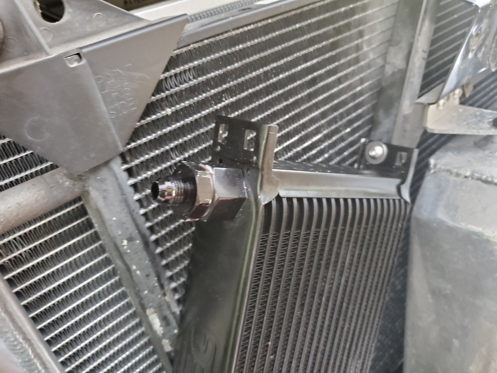

After posting in the aux trans cooler thread I figured I would give this derale cooler another chance. So i looked up the btu rating and was surprised to see it was 37k btus, cause it seemed to suck before lol.
It is about 2" thick though
So i ripped the fans off of it and started placing in the front where ever I thought it could work, get the most air flow, and easiest way to plumb it in
