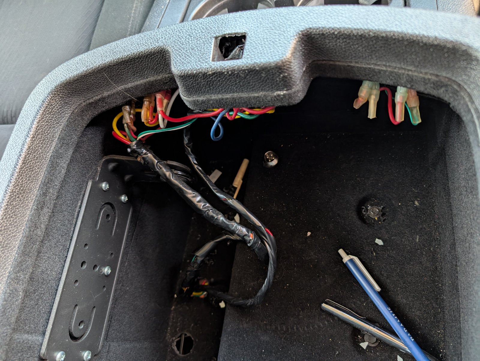

2- There are few cables & wiring for the lights & siren and I think they're all functional. Is there anything I can do aside from just tucking them away?

2. If they truly are functional, someone with more SSV experience will help you out with those.

#2 I'm hearing tiny sirens when I flip the switches in the car, I guess I just need to hook up a sound system of sort, but I don't really have any reason to make it functional I'll just leave it as it is.

As long as none of the wires are hot, tuck them or remove/chop them out.
