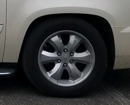

I don't rub while turning the wheel lock to lock but every once in a while if I hit a big dip just right the front tires will make contact with the inner wheel well... it's not often and it's just enough to feel/hear it.
I'm not sure what the width is on my factory 20's... I don't have the 5 spoke wheels like most, I have the optional 6 spoke wheels but I assume they are probably the same width as the others.
I want to say that I remember reading that they were 8.5" wide but I could be wrong.

That's good, cuz the current wheels you pictured are butt ugly.... Lol

I concur... I have always preferred the 5 spoke LTZ wheels over these optional LTZ wheels but that is what came on the truck.
