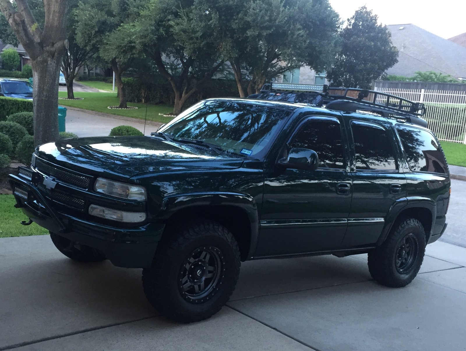

Yes. I had a 2001 Tahoe with torsion bars turned up and the tires fit fine.
